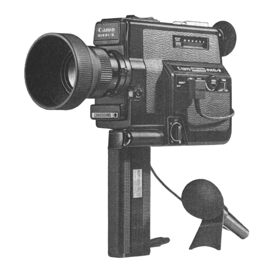

Hello :smile:
It's been a long time since I opened this thread.
I had the chance to get my hands on a Canon 514xls today but it seems to be broken because when I press the button the motor doesn't turn and only the red light comes on, as you can see the mechanical part in the compartment where the super 8 film should be also rises.
Code:
https://www.youtube.com/watch?v=c-aykv8iGoY&list=PLbknhnjWQGJV7kyVfMID_6oihf4y6MniQ&index=2&t=9s
or is there some setting that I haven't set properly ? i have set the "R" mode but don't work, and if you set "1" you can't even press it.
but I can see the red light that turns on when I check the battery and when I start pressing the shutter button, I see that it indicates the aperture that will be used based on the light of the scene. the focus seems to remain constant even when changing the focal length, however I tried it with the manual zoom ring because pressing the buttons doesn't seem to work

I used to have that camera, it's nice. Looks like yours needs some attention, it's probably worth getting it fixed as it looks to be in good condition.
Nitroplait
Jul 13, 2020
821
Europe (EU)
Set the camera up to be ready to film according to the manual (but without film). Press the filming button.
If you have set the camera up correctly, the motor should now be running even without film. If it doesn’t run, your camera is defective
Most super 8 cameras are defective by now. They often depend on rubber belts that are near disintegrated with age - or the metering system has become faulty etc.
yes i did all is the correct way but at difference of what happening in that video: where the camera work even without the super 8 film inside mine don't !
now i don't know if i have to ship back or they refund me and let me keep the defective product, but in case i can keep would you be able to indicate me what is wrong when i will disassembly ?

You have a sound-camera there, this means it highly likely does have a rubber belt to drive the capstan wheel. If this belt has become sticky it may block the entire mechanism.
Disassembly of such cameras is very hard, you also need to un-solder electrical connections and its easy to break something. Certain parts are fine-adjusted, if you don`t have proper adjustment-tools you cannot reassemble proper.
If you plan to repair, try to get the service manual for this camera first, read through and estimate whether you`re capable of such a repair. In such service manuals often is a troubleshooting guide, indicating what can be the cause for a malfunction. If the motor of the camera doesn`t run, there should be possible reasons for this listed in the service manual.
