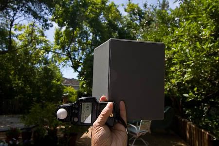

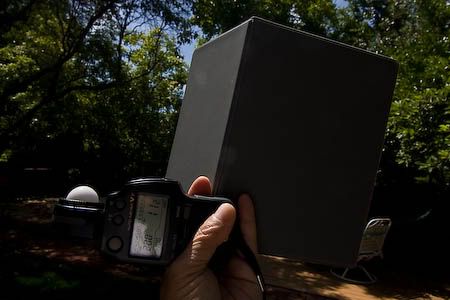

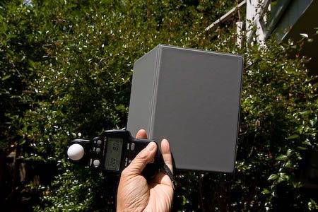

It is a nice sunny day here. I went outside at noon and took a incident reading with my Sekonic L-208 light meter. Based on my reading, the Sunny 16 rule would result in a 1 and 2/3 stop underexposure.
