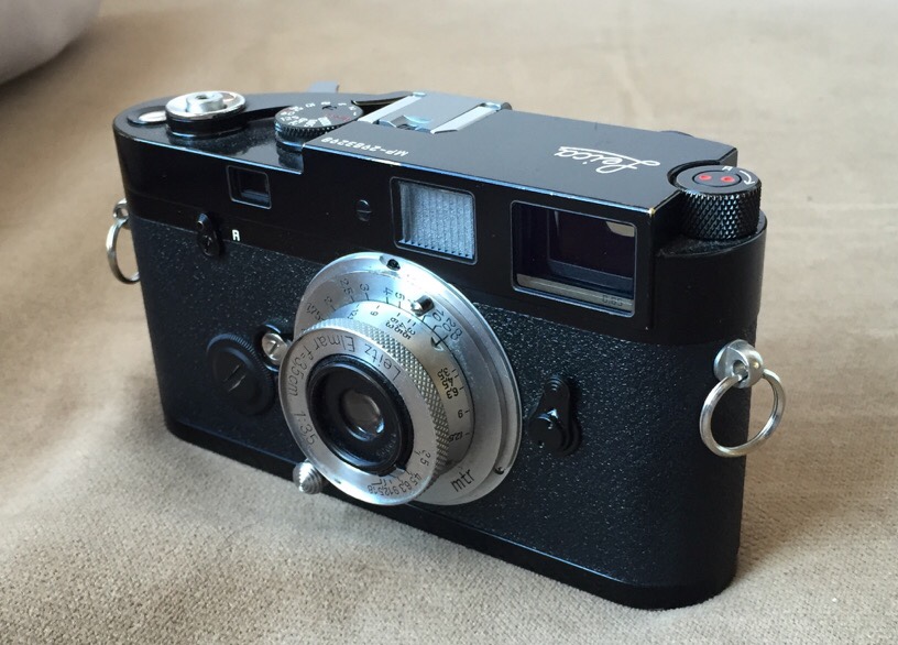

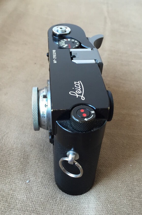

The uncoated 35/3.5 Elmar on my MP. So compact it's almost comical:
