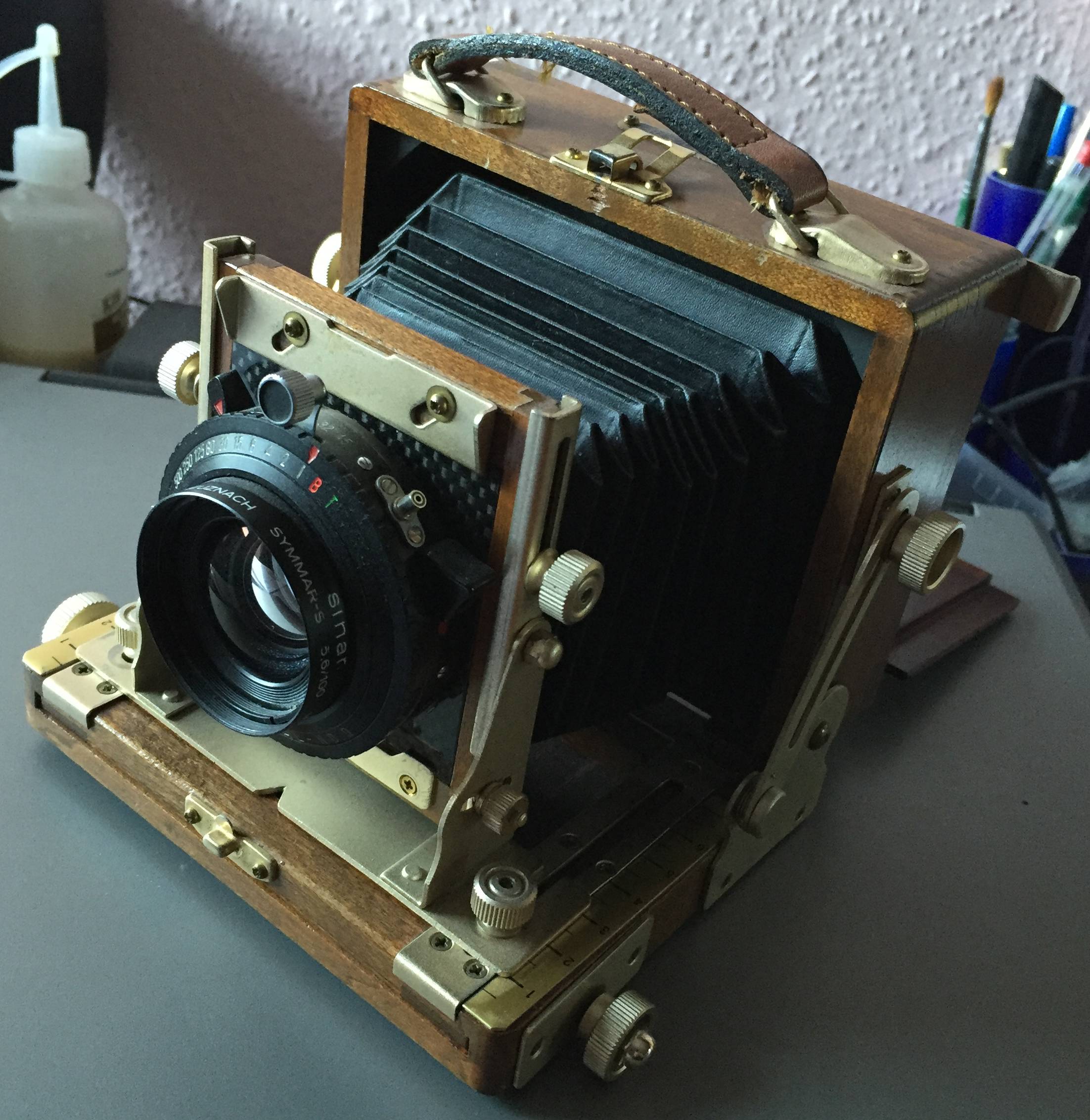

Current rebuild project, an Erneman ¼ plate camera with lots of metal plate holders well underway. Anybody know where I can buy the really thick velvet they used as light seals? Pictures to follow.
Shown here is a hand-built 6x9 field camera which will be modified to take glass quarter plates. Photo near the top of the Furka Pass (Switzerland/Italy) in 2008.

We have some things in common, as I like bikes and photo too - I used to go to the roads with my bike and a pair of cameras in the bag, that's a lot fun.
Show us more the camera you've built, is the one with you in the photo?

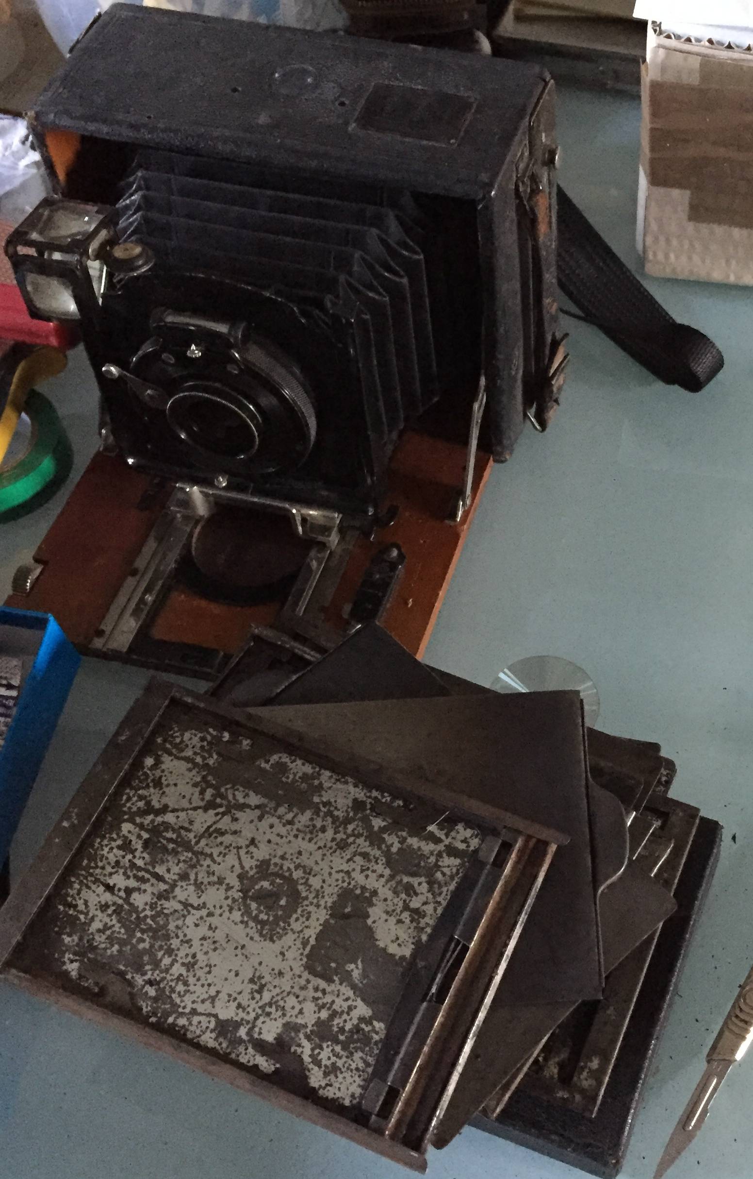

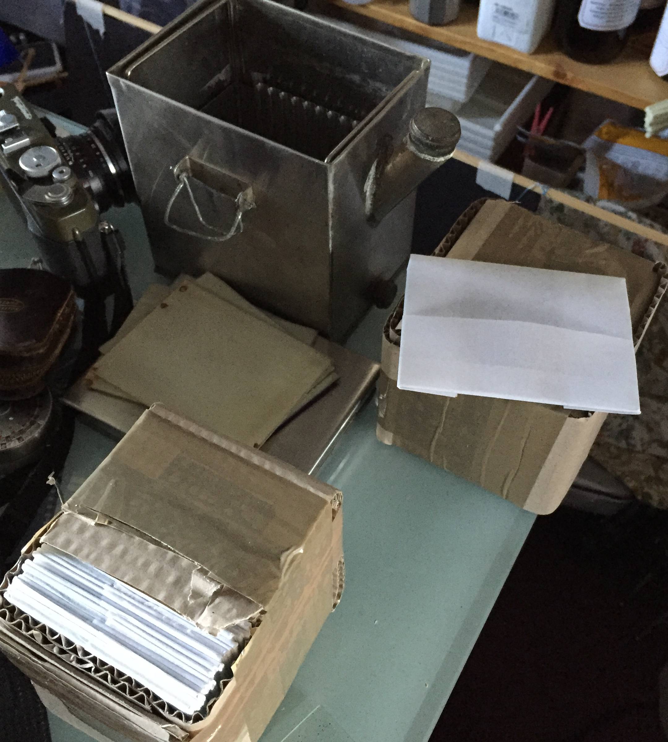

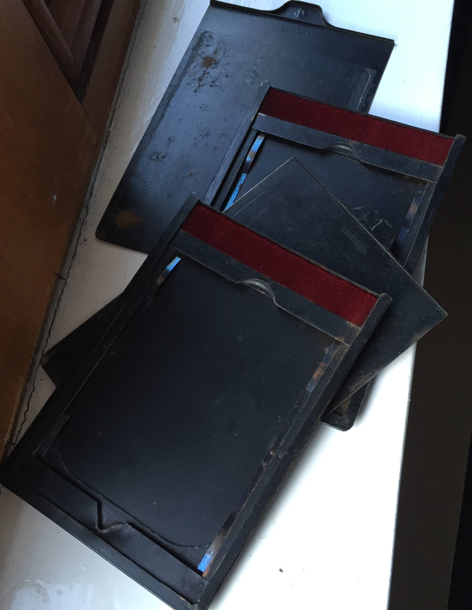

Herewith some pictures of the "Erneman Project". I have 9 plate holders. 3 are in reasonable condition and can be used, the other 6 have been stripped and now need cleaning up and repainting. Fitting velvet seals is going to be fun.
Glass ¼ plates have been delivered by Newcastle Optical - seen here in packaging, each one is individually wrapped!
The spring back on the camera needs some cleaning up but appears to be in working order.
I shall do the testing with commercial emulsion and then intend to move to something faster - say 125 ISO - so that I can hand hold the camera. IMG_0177.JPG IMG_0178.JPG IMG_0180.JPG

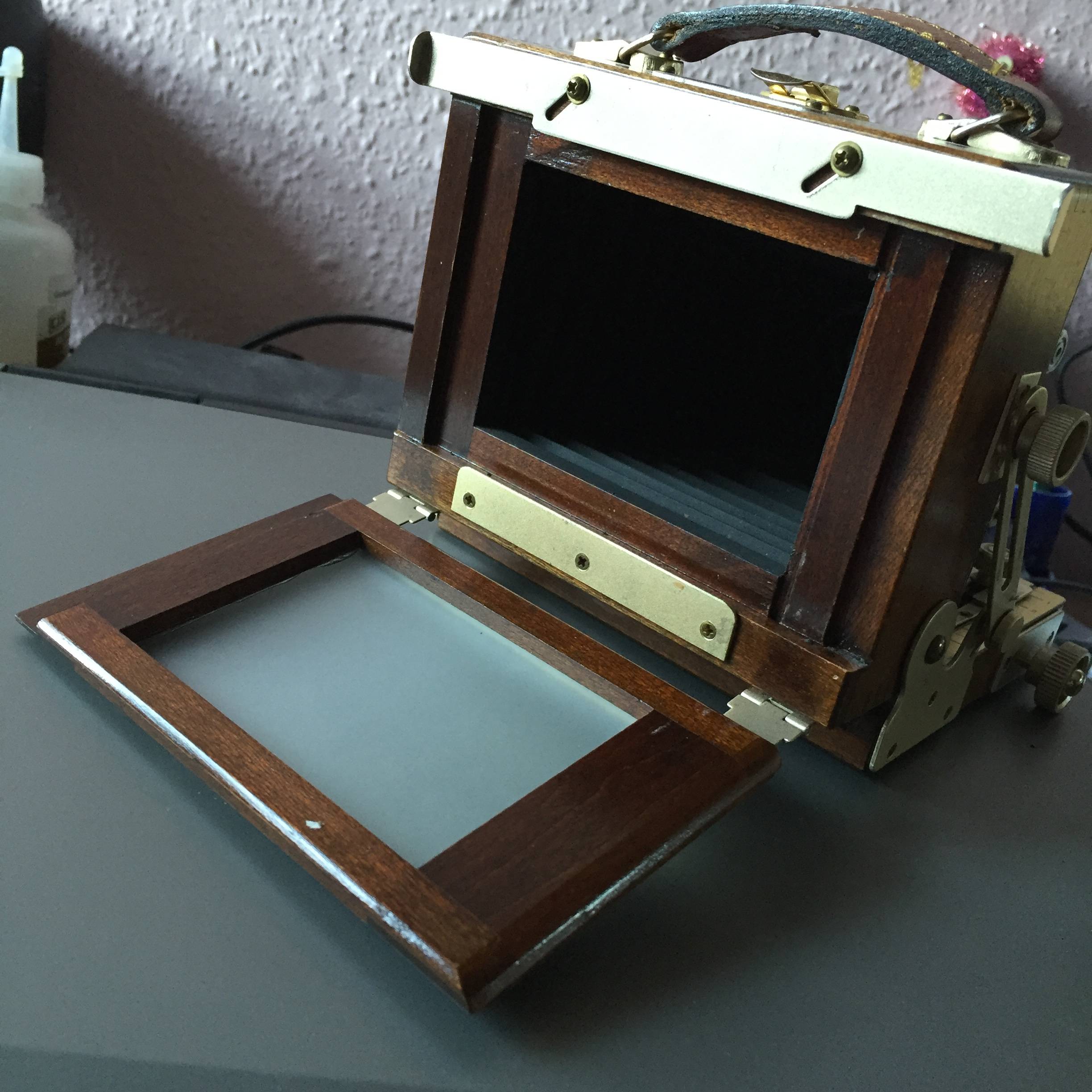

Herewith pictures of miniature field camera. Currently the back takes a 6x9 rollfilm magazine. I will be adding a spring holder for ¼ plates.

I wish I own that camera too.

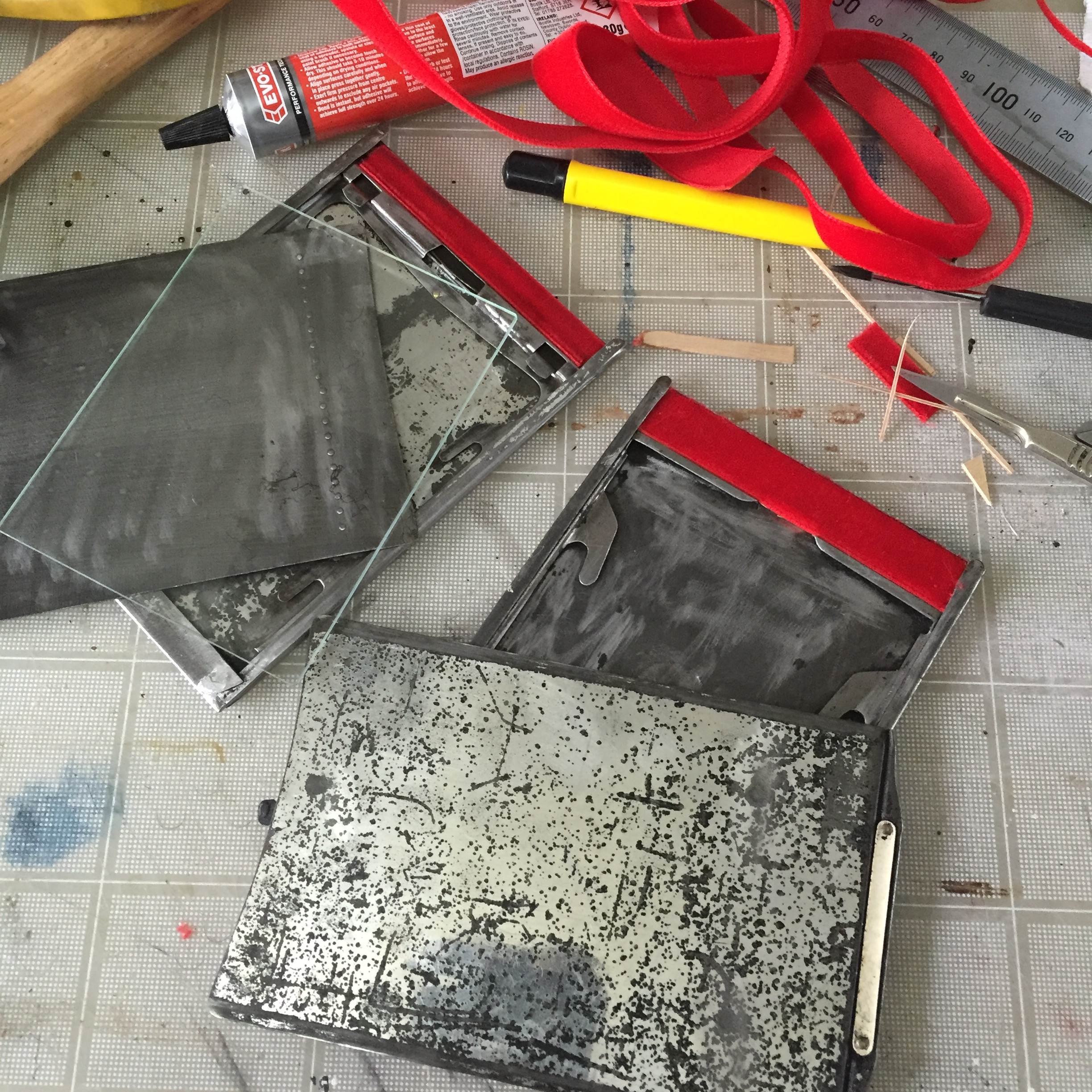

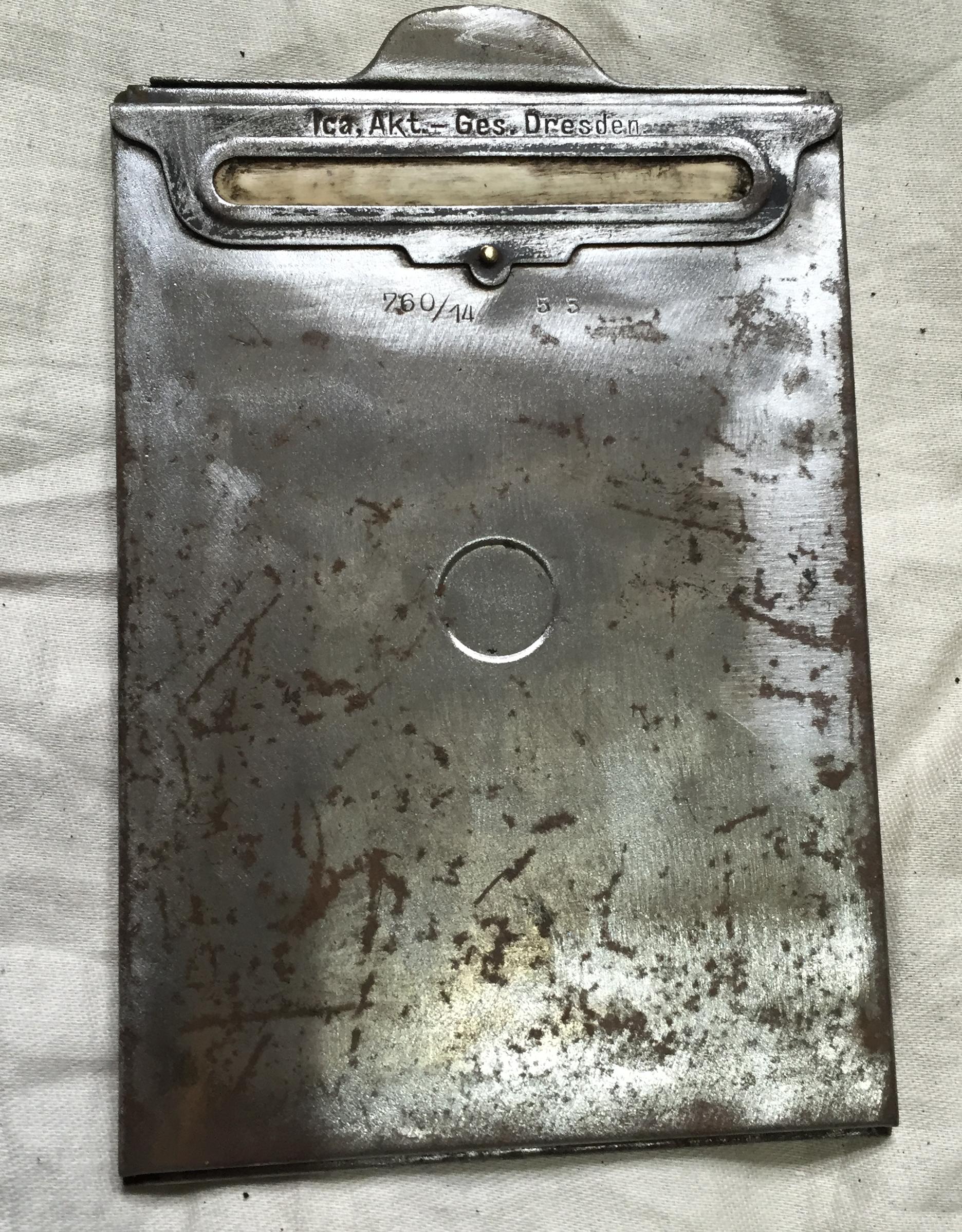

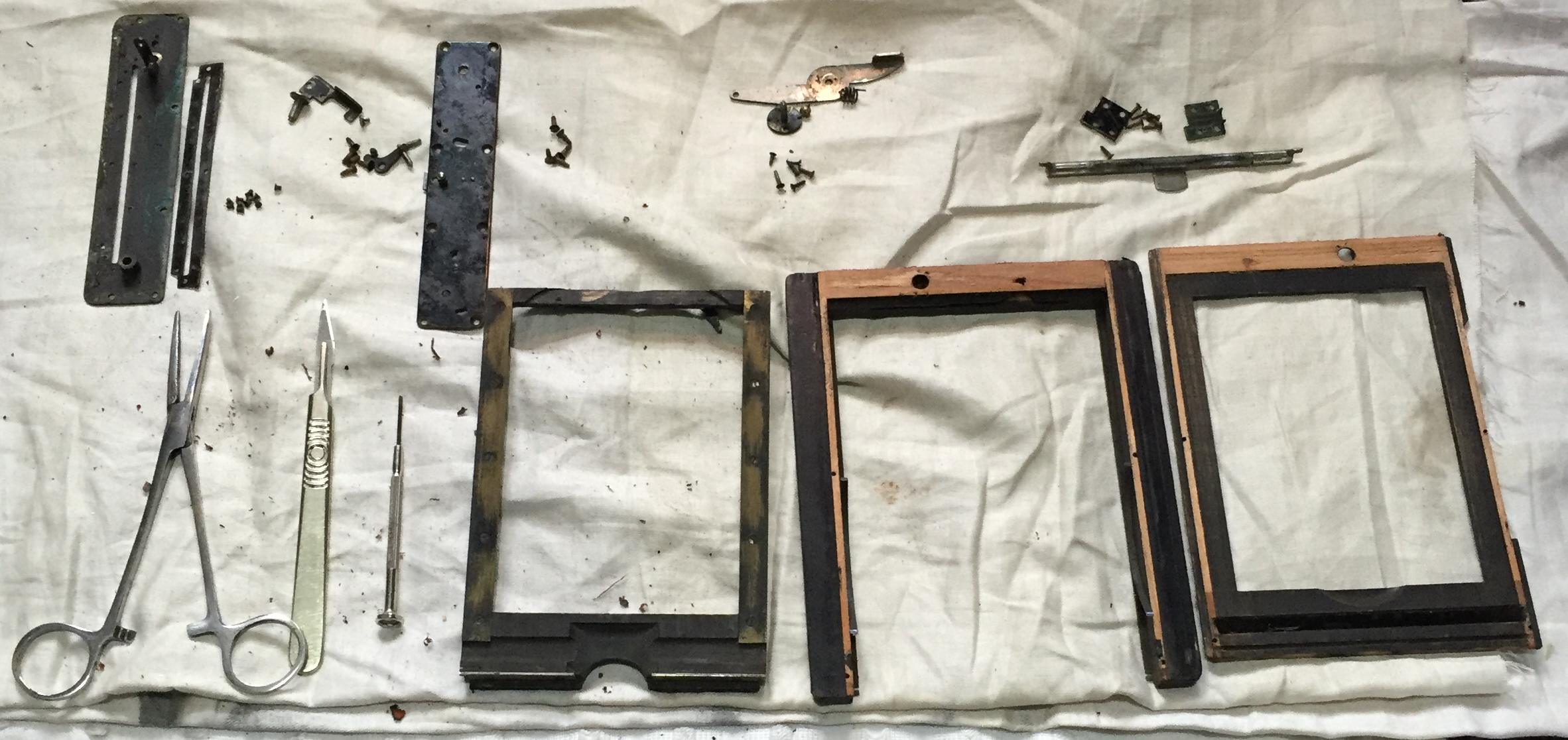

Refurb proceeding on plate holders.
Took a while to get the paint off and clean up the parts. I have to replace a couple of small brass rivets which are easy to make from wire.
Paint has to be applied very thin and left on top of a radiator to dry and go hard for several days.

If you go to a store that sells all kinds of material and garnishing for dresses & furniture/curtains etc. sometimes hobby stores for ladies
I am sure you can find lush velvet ribbon/tape which you can cut in strips wide enough for the seals
