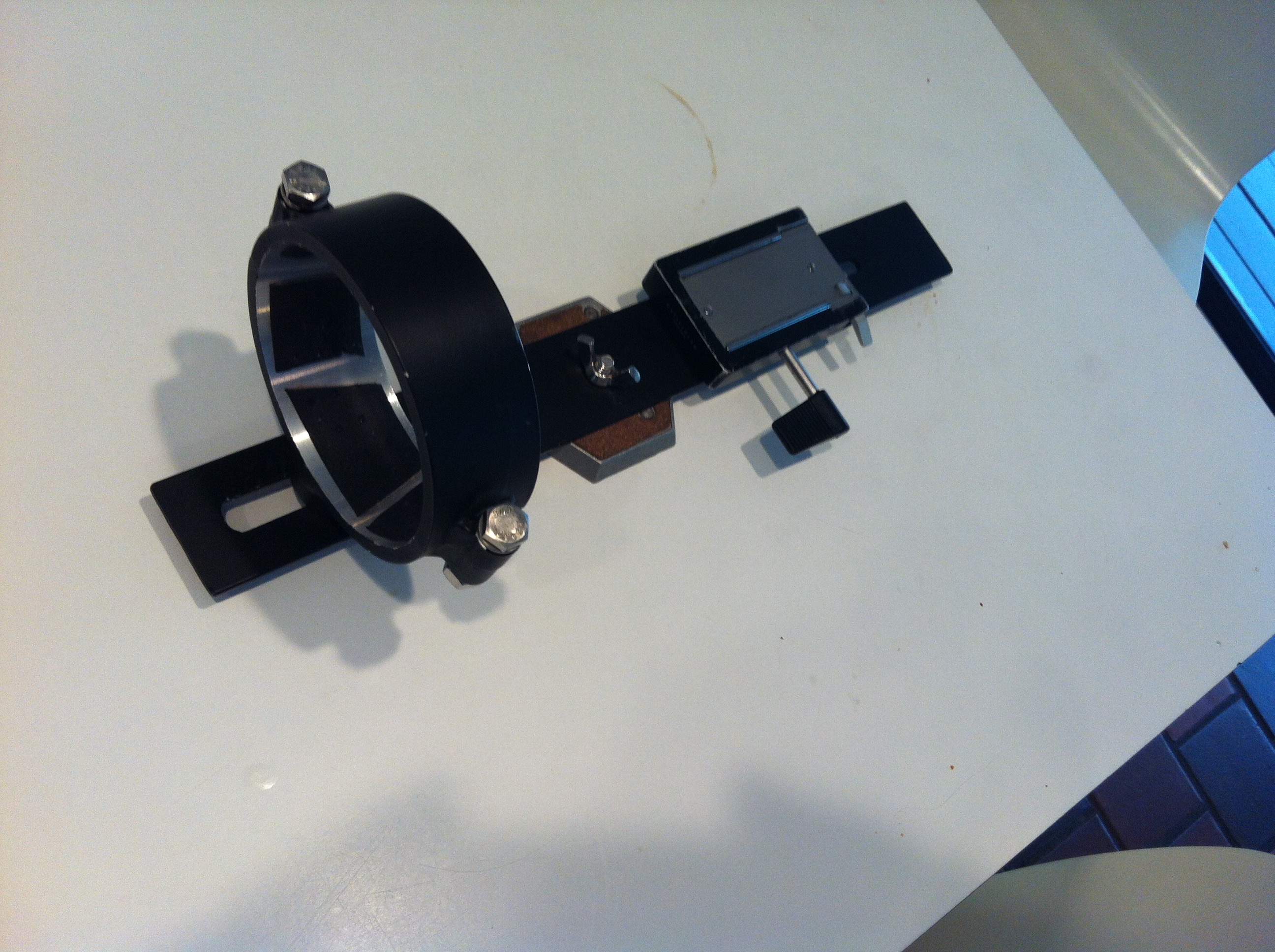

I had this made at a machine shop to attach a Hasselblad with a 350mm as well as with a 2x to my Bogen tripod. The lens didn’t have an attachment collar. With this I can center the weight over the tripod.
