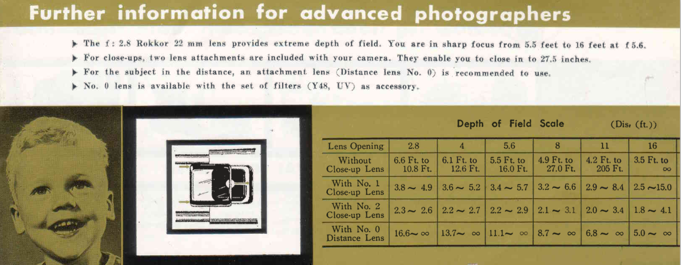

While most of the the Mamiya 16 cameras have a focusing lens -- a great feature for sure -- the Minolta 16 cameras (and similar 16mm cameras) don't have a big problem with distance focus because you quickly reach a good distance by stopping down. The SUBCLUB has the DOF tables.
Some Minolta 16 cameras have two settings for focusing, and others have a close-up lens built in. There are lots of models to choose from. The QT has a fully focusing lens.
