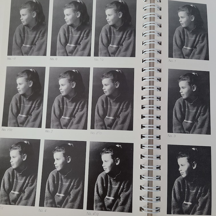

Here is a picture of Kodak's darkroom guide with examples printed on Kodak Polycontrast III RC paper using different filters. The film stock is Tmax 100.
So the film does not matter much, you can also use Ilford films, paper and filters if you go the darkroom way.
