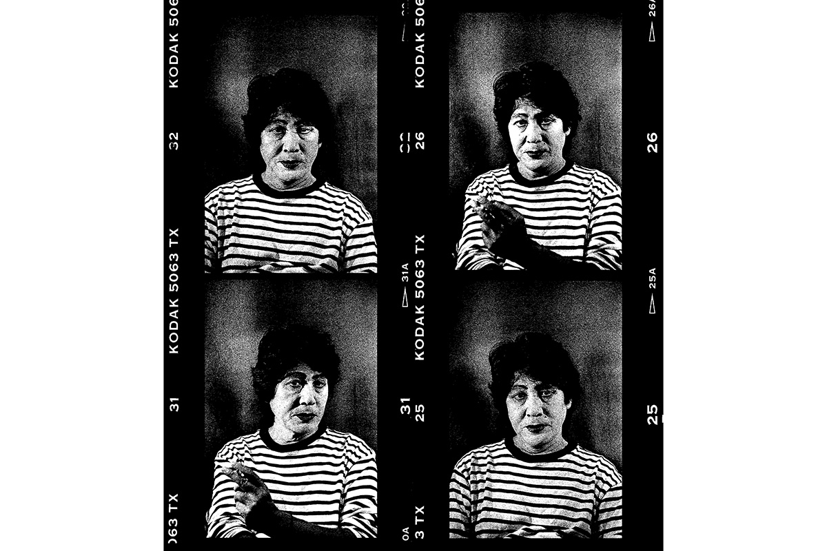

Moriyama did both colour and black and white. For B&W he uses (or used) Kodak 400TX.

Image I posted above is a Moriyama self-portrait.
Should add that if you want the Moriyama look, film won't be enough. His look is also a lot about process. I suggest doing a search about pushing film, and also about how different developers influence the end result.
Getting the look you want will mean a lot of experimenting.

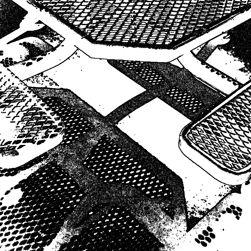

This is an example of something I am more likely to make:
Show us what you like to make. Or what you have done, that indicates what you would like to make.
By the way, I could turn the above into something slightly like Moriyama by cheating, and playing with it:

When I get photos like this I try to figure out what I did wrong. I guess I should write down what I'm doing next time and make a genre out of it.
My take. It's heavily expired/abused C-41 very underexposed and DSLR scanned with the levels all the way to the wall so you can rescue at least something. Maybe even a small format like 110 or 16mm. I get this look with microfilm
Pentax Auto 110, Kodak HQ-Link, Rodinal 1:100. lacks the grain of 'ol Moriyama but I'm sure I can work on it.
(Yes, I know it says Tri-x on the film)
