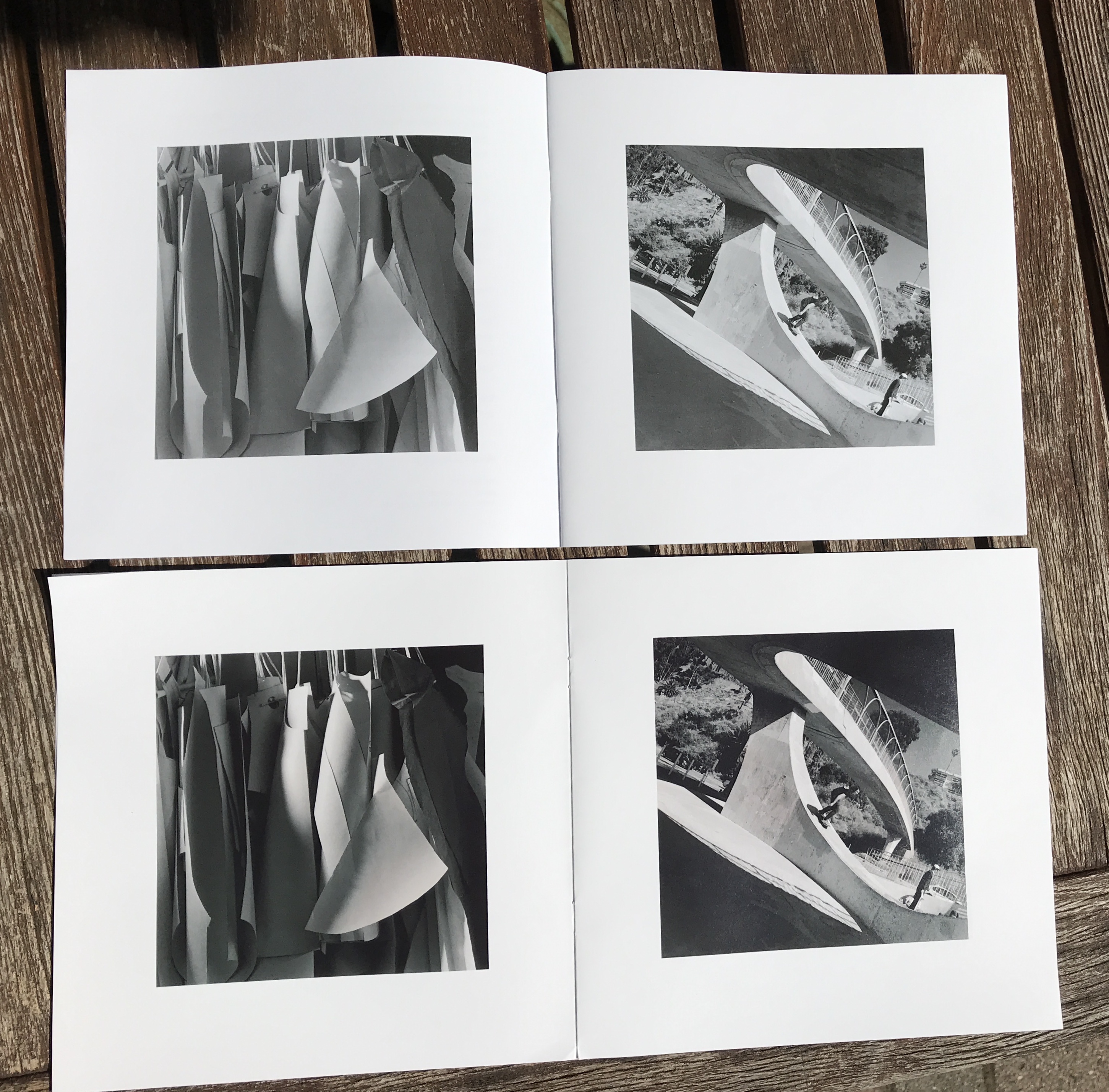

I have used MagCloud with mixed results. The first run was OK, second washed out. But zines traditionally are low-quality, originally being made with copy machines. "A zine (/ziːn/ ZEEN; short for magazine or fanzine) is a small-circulation self-published work of original or appropriated texts and images, usually reproduced via a copy machine."
I found the comparison shot I send to MagCloud trying to get the job reprinted. They said it was within their tolerances. The top is the reprint, the bottom the original.
Thanks for that comparison shot. Yeah, the MagCloud version looks a lot like what I got from the online printing service I used - maybe a bit better. It was their recommendation to go with 4-color CMYK to get richer blacks, but the color cast was terrible and they essentially said they couldn't do anything about it.
