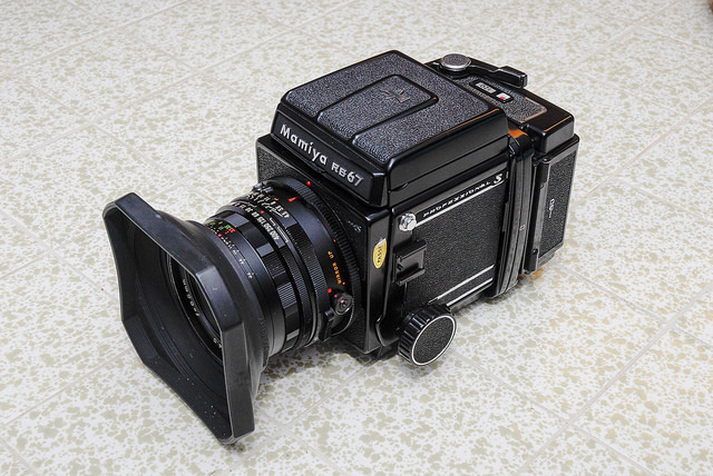

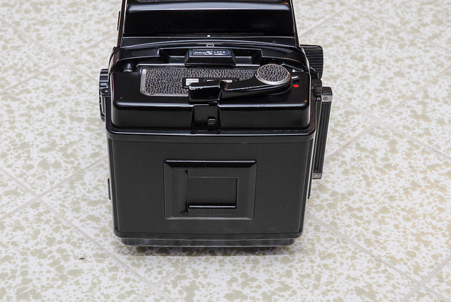

Received my RB67 from KEH this afternoon. All in all it's in pretty good shape.
The lens has a small scratch on the front element about 1/4" long. I don't think it will be an issue with the hood being used. One of the blades on the shutter is bent at the tip, but doesn't seem to affect anything.
BTW, when you fire does the shutter close, then open, then close again? the one second shutter speed seems to be on.
The back is in very good shape. Seals are OK, but need to be replaced. Time to call Jon.
The focusing screen's vertical marks are wandering all over the place. I'm assuming these are waterslides or something between the glass and the fresnel and someone tried to wash it in water.
And the weight. Not going to be an issue I think. It only weighs 1/2 lb more than my D200 with speedflash and battery pack. It actually fits my small hands quite well. I like it.
Anyway, here's the pics:
D200-14013-3564.jpgD200-14013-3565.jpgD200-14013-3566.jpgD200-14013-3567.jpgD200-14013-3569.jpg

The bent at the tip shutter/aperture blade is normal.
As is the shutter sequence.
That looks to be a "Pro" back, rather than a "Pro-S" back. As a result, you won't get the benefit of the double-exposure prevention that the Pro-S body otherwise supports. You may regret that choice.
And the viewing screen looks very strange - almost like a home-made replacement. As far as I am aware the Mamiya screens do have the vertical cropping lines built in.

Congratulations on your upgrade to the Mamiya RB67 platform, Blooze.
The back to me almost looks like my ProSD back, but I'm not sure after reading Matt's comment. As I recall, it seem to me that the original Pro back was rounded on the edges, this unit seems a bit more squared off. Additionally, there is the multi-exposure lever on the top right of the back. Which this back looks to have. That should be used for preventing or allowing double exposure, but only works with the ProSD body I think. It's just a precaution you'll need to verify if it does not. At that point just make sure you ADVANCE the film after each shot. Here is a helpful guide too. Mamiya RB67 Backs
Yep, the ground-glass looks like it was basically eye-ball engineered or done free-hand so to speak with a sharpie. If it bugs you it can always be swapped out with one off of eBay fairly easily. With my bad eyes I replaced mine with one of the old Beattie Intenscreens years ago.
Good luck with getting things rolling and post some photos when you get a chance.

Thanks everyone.
The back is a Pro-SD. The double exposure lever on the back works as it should, so I'm good there.
I found another thread that mentions the basic screen (#214-520) that came with these have waterslide marks for the portrait orientation. Post about 1/2 way down by Saltgeorge mentions it at this link and what water can do. It's definitely not a DIY job with a sharpie. It's too bad the camera doesn't have the moving red bars that are used in the landscape view for the portrait view.
https://www.flickr.com/groups/mamiyarb/discuss/72157632670430771/

I'm glad that the back is a Pro-SD - I was fooled by the fact that the Pro-S backs are clearly labelled as such while the Pro backs are unlabeled. Interesting to note that the Pro-SD backs are also hard to identify as such.
Blooze
Mar 4, 2013
103
Texas
It has a Pro-SD label on it, but it's very small and obscure.
