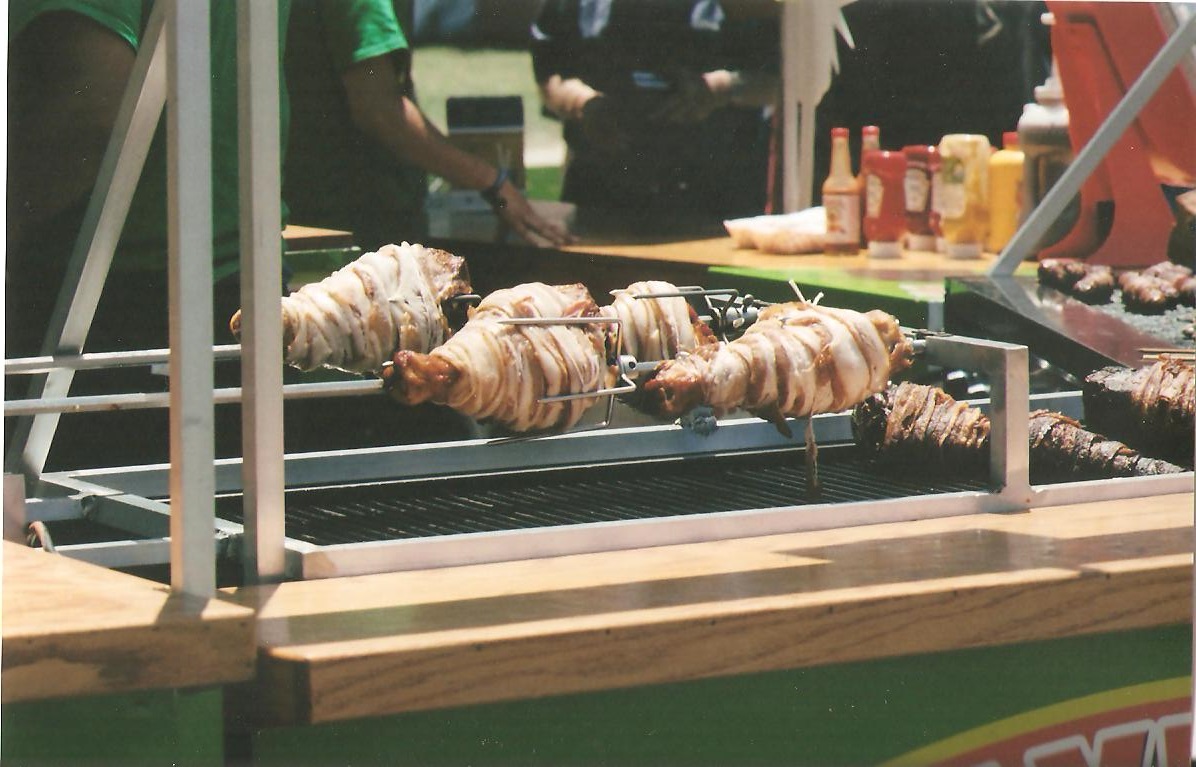

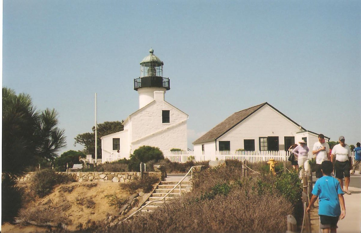

Here are a couple of examples:
The lighthouse image mprobably was taken with a Kodak Retina IIIc; the bacon-wrapped turkey leg image was Nikon FE with Nikkor 1.4/50

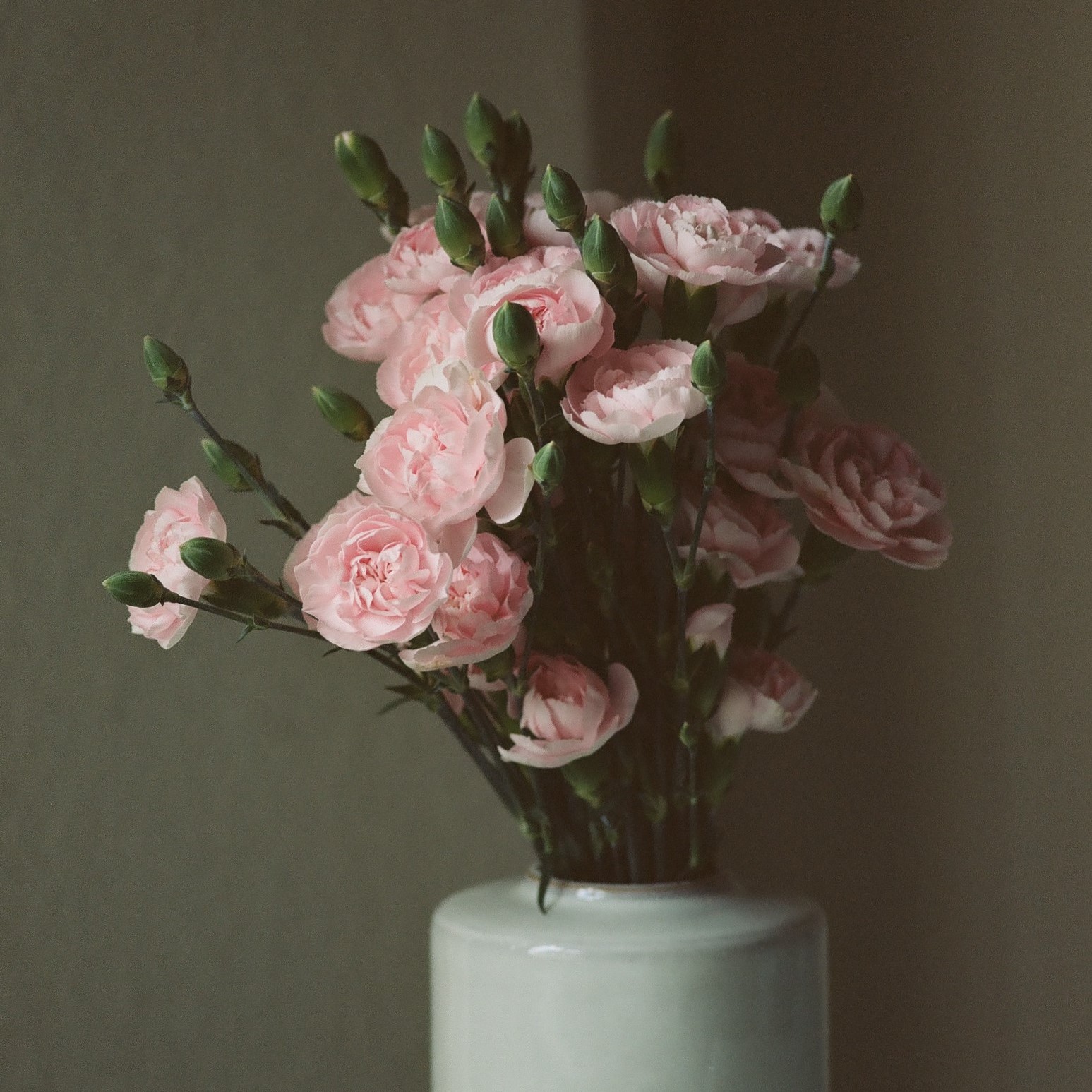

Current Portra 160. Hasselbald with 150 lens. Matt may have used a "snap" filter, LOL
Nope - just diffused electronic flash illumination.
This too is Portra 160NC - but the light is really different, so the colour palette of the result is too:
The bottom 15% of the tonal curve is simply not used in that image, resulting in a washed out look (the same is true for your earlier examples btw, which also have an overall yellow cast). Optically enlarged Portra 160 looks nothing like this at all! If you set the black point of that scan to where the deepest shadows are, which you'd do when printing this (as you'd otherwise blow out the highlights on the edges of the petals; RA4-paper is steep), you'll end up with something entirely different to what's shown here. It'll also become apparent that the tonal distribution in that image is downright weird and totally unrepresentative of how enlarged Portra looks.
I see scans being offered by means of illustration of the color palette of these films as if scans are representative of optical prints. They are not! Anyone who scans and prints side by side knows how different the output can be, and usually is. Yes, you can get them to render similarly, but you have to have the print (or at least a lot of experience printing) to get there.
Matt's example of the orchid is somewhat closer to how today's Portra will print on today's papers. Punchy, saturated and contrasty. Of course, the main difference between your shot and Matt's is the lighting, which makes a world of difference.
Mind you, there's nothing wrong at all with scanning CN film. It's great fun and great results can be had that way. But @logan2z is specifically intending to optically print his negatives. That makes this an entirely different ballgame.
