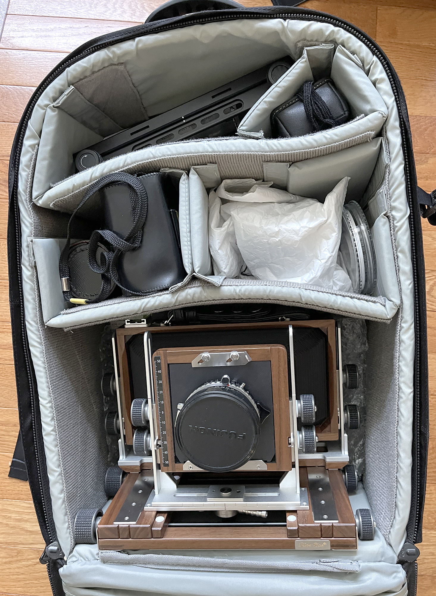

Thanks. The photo below shows why a top or side loader will not work for my setup (that's a non folding Shen Hao 6x17 camera). I just need a bit more room while also keeping the bag within airlines carry-on limits.
That format of bag is nice in that you have everything within view and within reach when you open it up, but yes, they start heavy. Do you think you could live with separate cases within a pack? See if any of the myriad inserts or icu's or whatever each company calls them (Tenba byob series) works for the camera, then find another for lenses and so on, then get a lightweight carryon sized hiking pack and slide those things in.
The downside of this method is the "yard sale" that occurs at your tripod legs.
Panel loading packs (your pack is one) are becoming harder and harder to find unless you buy used/vintage.
