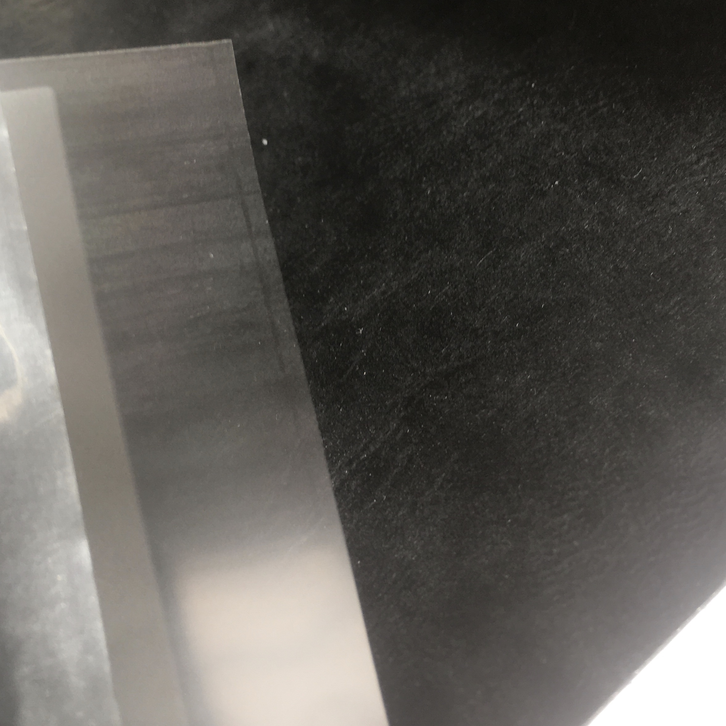

Hello all. A quick update...
I thought the problem had disappeared as my most recent rolls did not exhibit any traces of residue.
However, the latest roll shows 'streaking' once again.
I have managed to take a photo albeit not the best quality.
If the residue was from Photo Flo I would have thought the streaking would be less uniform. Plus, I hang my negs at a slight diagonal and the streaking is vertical.
Any ideas as to what could be causing this?

I cannot puzzle out what is what on the photo.
A couple of times I didn't remove the sticky tape that holds the film and backing paper together.
The glue dissolved in the tank and left streaks down the film.
Now I always remove the sticky tape from the film before loading the spiral.
How did you develop? Like Bob, I can't tell much from that photo. What I see looks like it might not be completely fixed.
Also, if you get developer into your fix, you could end up redepositing dissolved silver back onto the film, if the fix is heavily used (it's pretty unlikely).
I have added some detail in the form of red lines. Hopefully you can see that there is a formation of clear film interspersed with lines formed by this residue.
Fix is always fresh and one shot.
Continuous agitation tank.

I should add that this streaking is only really visible when the film is held at a certain angle against a dark background. That is why it is quite difficult to get a good image of it. The streaking is not apparent when the film is held against the light. Nonetheless the artefacts exist.

I understand your point but I am concerned whether this residue will degrade the negative over time. That is the main reason for trying to work out what it actually is. The enlarger seems to print through it without problems so far although the frames that I have printed have not had broad areas eg: sky where it could possibly show up.
calcium sulfite scum? Can you wipe it off with a sponge while the negs are wet? Does it clear off in an acid fixing bath (with agitation)? Doesn't look like photoflo to me.
Quite possibly. There is a lot of calcium in the water here. I do however use distilled for the developer and final wash. The remainder is filtered through a Paterson filter.
The residue will semi easily wipe off. I was able to do that on the dry leader.
I haven't tried soaking in stop bath as yet.
I am not sure it is photoflo either. Especially as the negs are hung up at a diagonal and these streaks are vertical. They would not be so uniform either. The uniformity is the part that I actually find quite puzzling.
Eliminate one variable at a time. Try a process run with only demineralized water to see if the tap water does anything - so one film processed without it getting into touch with any tap water whatsoever. Same with the photoflo; do one roll without using any photoflo. Do a film with a different developer. Fresh fixer. Etc. etc. It's a process of elimination. By following it diligently, you'll encounter the factor that causes this.

Are you sure these lines/streaks you're seeing aren't really lightly exposed ares instead of streaks. The reason I ask is that the infrequency and the direction of the lines. I even took a guess as to what camera you were using and would have guessed right. There are several areas where Hasselblad cameras can form mini-light leaks. Rear barn doors, shutter problems (rare), gap between back and body (again rare) and the light seal in the back itself (a much more common problem) and one you can test yourself very easily if you have another back. I'd guess you might have a light seal issue in one of your backs????
I use Paterson tanks. They sit upright on the bench. Any chemistry streaks would most likely be across the film.
The only streaks along the length of my films would be from the final rinse etc. when hung up to dry vertically.
Are you using horizontal rotary tanks?
If so, that could be contributing to the stains along the length of the roll.
Remove the spiral of developed film and soak it in the final wash with the wetting agent. Placed horizontally, with the spool sitting in a bowl of wetting agent rinse.

If you used PhotoFlo mixed per the instructions and you still have streaking, then the problem may be your local water. In that case use distilled water for the final wash. Others will have solutions [pun intended] using isopropyl alcohol. Please do not refer to isopropyl alcohol as IPA, because that generates posts about using either bottled or draft micro brewed beer.
