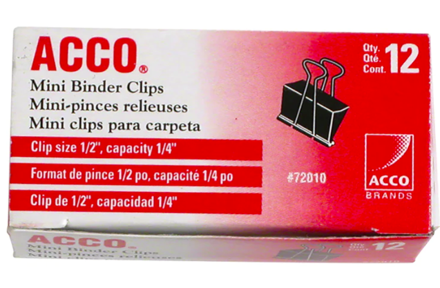

Clip the rewashed and re-PhotoFlo'd strips very carefully on just one corner, and then hang them up. The short strips are very light, so a small clip will hold them.

Little itty bitty clips - like these, or smaller:
Elmarc
Elmarc
Feb 23, 2022
161
Eu
Analog
Perfect! Thank you.(and Koraks)

Those clips are great, yeah.
