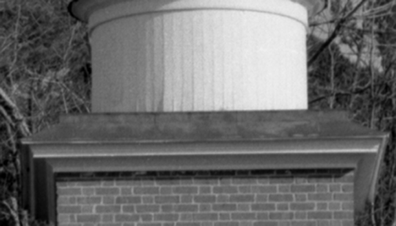

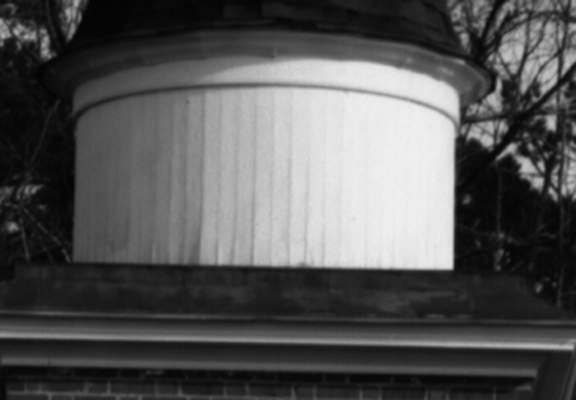

Image examples
Attached I hope!, are straight scans from the same subject, a church across the street from my house. NO changes were made in either, straight from my
Epson 3170. What you are seeing is approximately a section of a 50x60 inch print from a 4x5 negative, or less than one cm of the actual negative.
I think these speak for thenselves. the lens is a 150 mm f 6.8 grenoer (sp?) stopped dowm to f-22.

The thumb nail on the left is t-max 100 and the right is gigbitfilm. The file names did not up load with the images!
