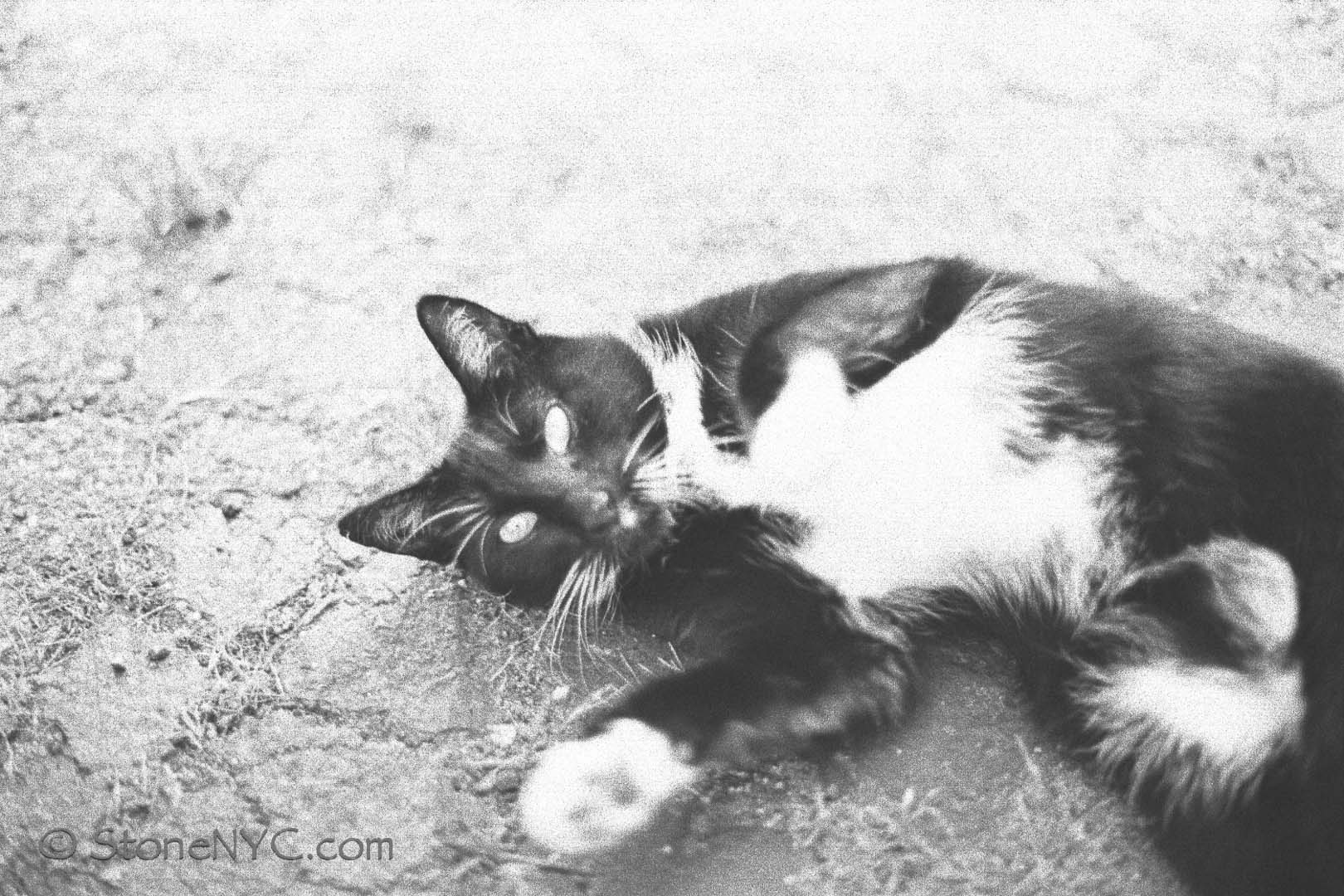

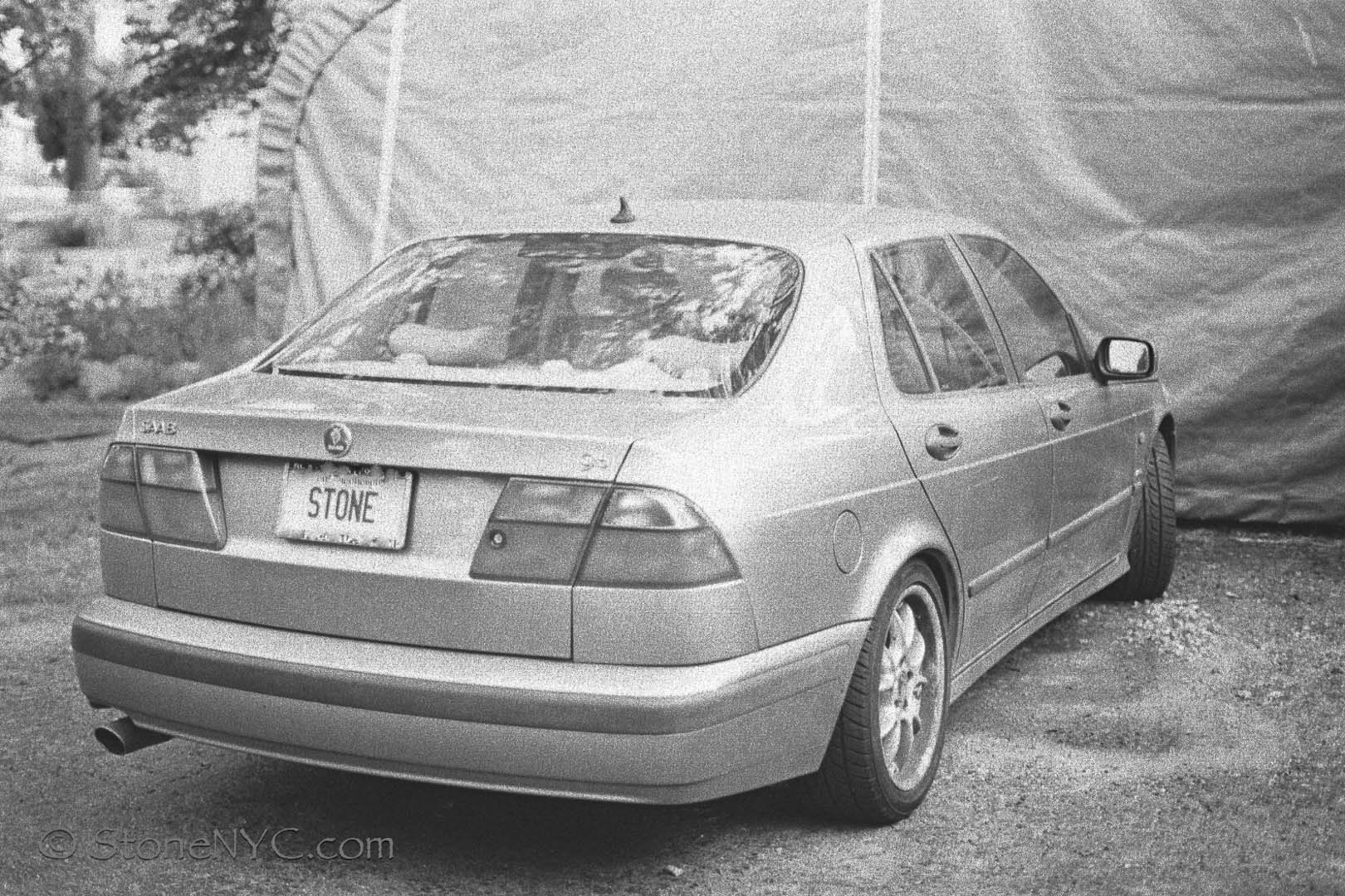

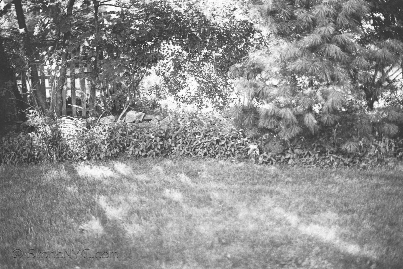

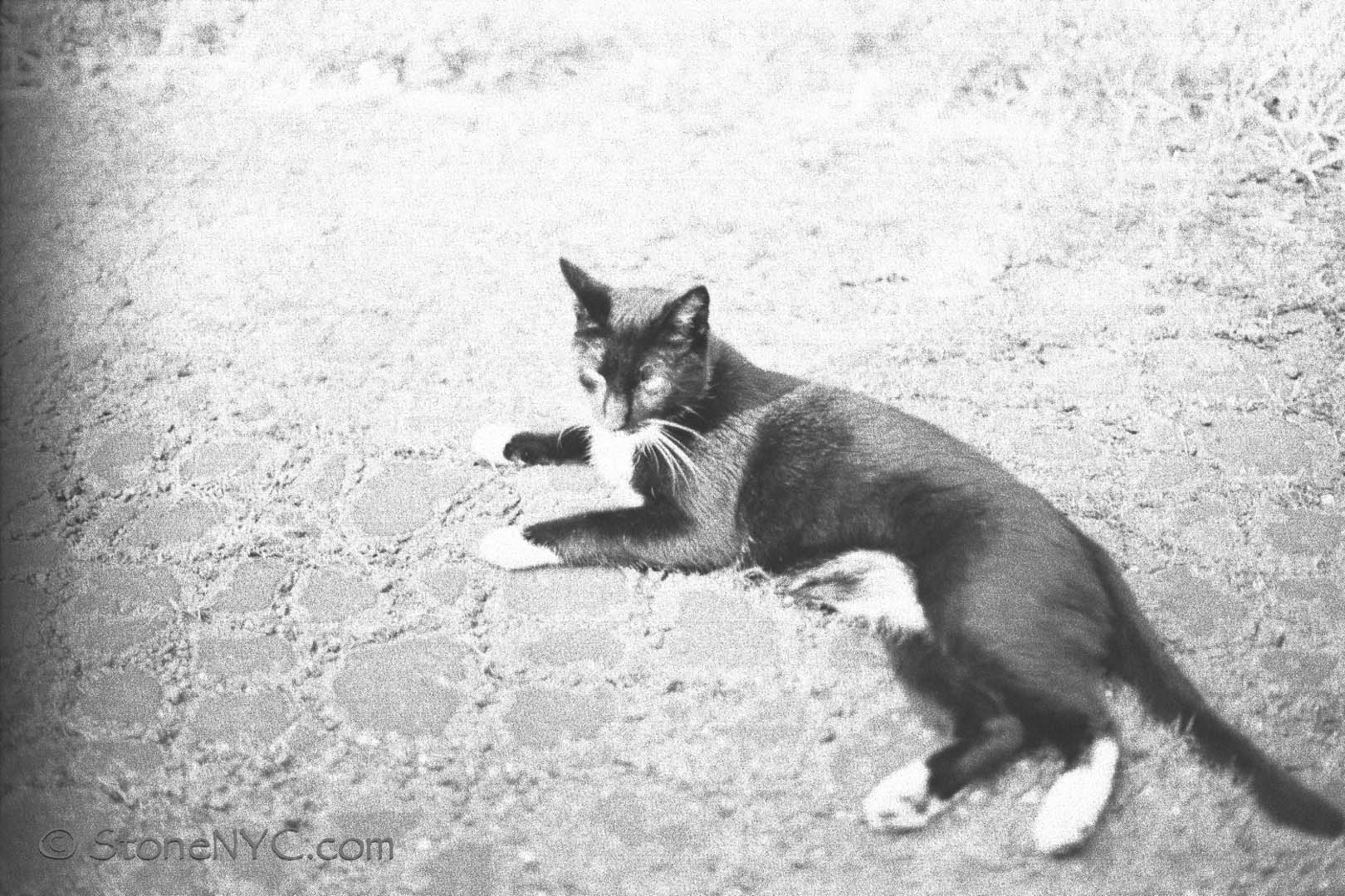

So I've done my first experiment with processing K64 as B&W
I haven't scanned them yet, but so far they look "usable".
I've done a lot of C-41 x-processing already with success.

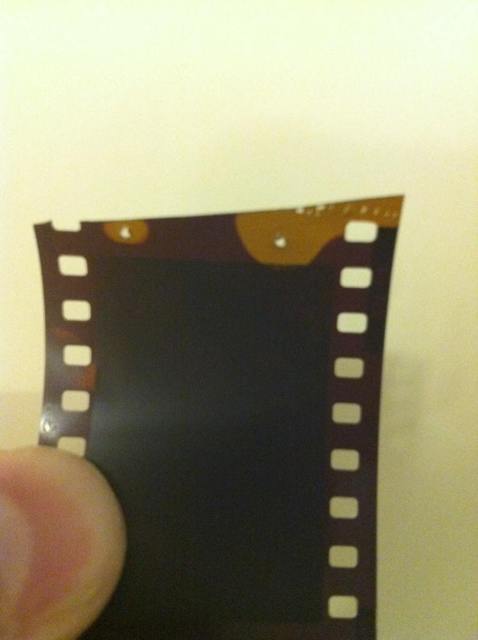

I was able to MOSTLY clear the remjet layer but will have to work more on it next time, I had to squeegee more of it off.

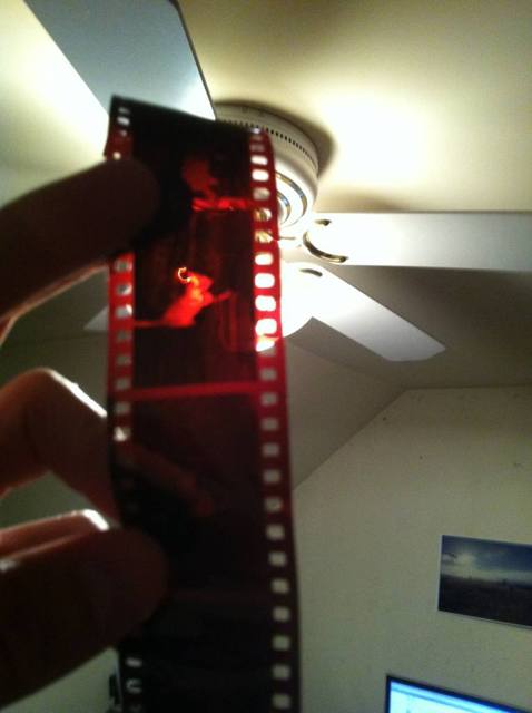

This was taken shortly after it was hanging...
The base color was not expected, I'll have to figure out if there's a way to clear that, or if I've done something wrong in my process.
As its dried the base looks darker, I hope that's not a fixer issue, but it's possible by the time it dries that it won't be good anymore.
I have a few bricks of it coming from a very nice APUGer and figured it was a good day to start experimenting with what I do have left...
I'll report back after dinner with some scanned images...
~Stone | Sent w/ iPhone using Tapatalk

I did NOT do this bleach extra fix steps ... seems it takes WAY more fixing time than normal films and it's going black... sigh... well at least I am able to scan it before it's completely gone...
Posting my first results soon but as I said, it's already going black, and it's just my cat and my back yard so I'm not too worried...

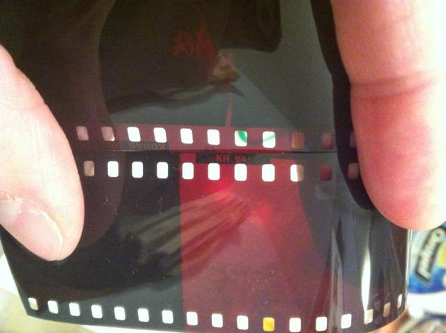

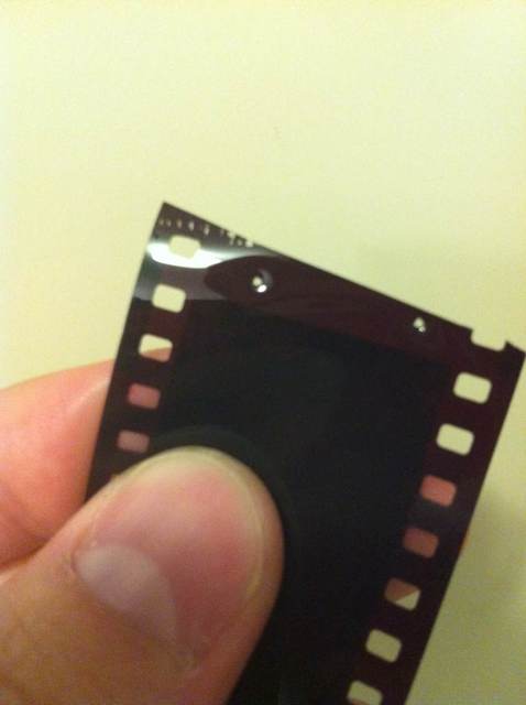

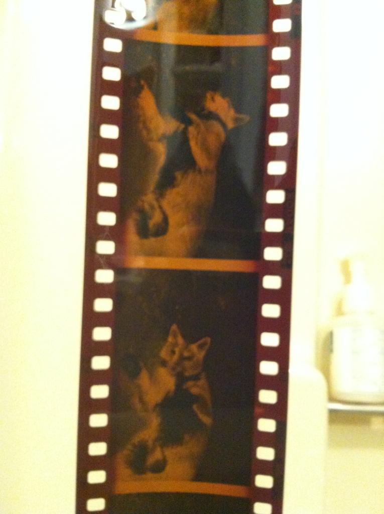

What I don't understand is this bleaching step that I've just discovered Matt, It seems to just be fixer and citric acid ... will that get rid of this terrible orange color? I noticed that when I took off the clip that under the clip was still a lot lighter ... but I put it in complete darkness to dry to see if it was just not fixed enough and it still was dark.. .examples to come...
Have to post from my cell phone...
How dark the stain of my life...
Before...
After...
Again before under the clip where it was wet...
And after, dried in complete darkness..
What's going on here?

Well, negs are definitely dark due to the CLS layer. You need some kind of light bleach to remove this without removing the rest of the silver. Fixing comes along with bleaching in that it removes rehalogenated silver (which bleach gives you) in all cases.

Bleach rehalogenates developed silver back into silver halide which you cannot see (for the most part). This is then redevelopable with any developer. On the same token it is also a candidate for removal by fixing. If you bleach a print or film and put it back into developer it'll come right back. One can do this countless times. However if you bleach a print or film and put it into fixer, then the fixer does it's job and removes all undeveloped (which rehalogenated silver is) silver from the print or film. To rehalogenate means to re-halide hence silver->silver halide. All film and paper is silver halide based. If you use a dilute bleach you can rehalogenate only light density silver while leaving the rest relatively unaffected. CLS is part of this light density mask of silver.

The bleach described in http://www.kodak.com/global/en/consumer/products/pdf/ae31.pdf is a actually a weak bleach/fix designed to remove the CLS 'stain'. Note the comment: "Stop bleaching if reduction of the silver image becomes apparent. It is better to leave a little stain than to lose the silver image."
CLS (Carey Lee Silver) is colloidal silver used as a filter layer.
Stone, what you call base colour differs on the rebates from the rest of the film strip in your sample.

Sure. You are just trying to convert the CLS into a form that the fixer (in that bath) removes. The CLS is very fine particles of silver that can be easily beached and fixed by that bath. You want to avoid 'over doing it' so that you actually bleach and fix image silver.

Rebates = Film Edges
In the case of your sample I refer to edges areas including the perforation areas.

I'm not sure but if I remember correctly the Kodak BW400 film (= B&W film for C-41) has also a brown base?? I'm not sure but can't check it right now.
You could develop an unexposed part of the film to see what colour the base is in itself.

It not the Kodachrome film base color you see, it's the CLS (Carey Lee Silver) that is colloidal silver used as a yellow filter layer.
