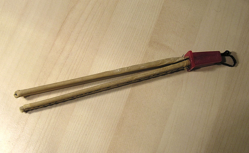

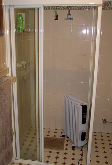

To remove water after hanging I made a tool from an old set of print tongs (rubber grips removed). I cut up and wrapped two layers of genuine chamois around the two bamboo arms of the tongs and stiched it up. Soak the chamois well before squeezing the film and it is soft and mushy a bit like loose human skin and very light pressure removes most water very effectively. Drying is in the shower recess with the aid of a small electric oil heater and generally takes around 30 minutes. I haven't had a water mark or scratched neg since I started this routine about 5 years ago.
