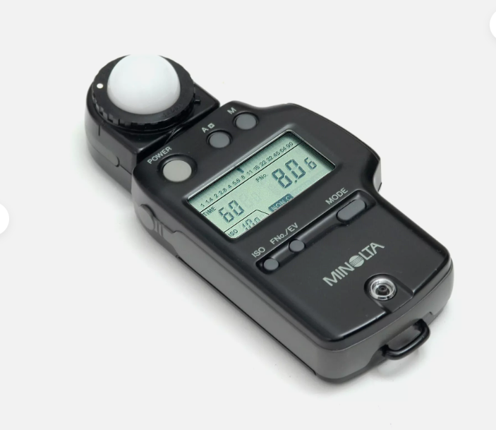

You need to determine the brightness of the ambient light and the strobe light. Do you have a meter?
on those conditions I use this meter:
I use the no cord mode, so I meter the total light available.
I dont think 1/400 would be an issue but depends on the flash power.
That meter will measure all the light, corded or not corded. When you measure the ambient light in the studio, set up for your portraits and at the ISO for your film, what reading do you get?
