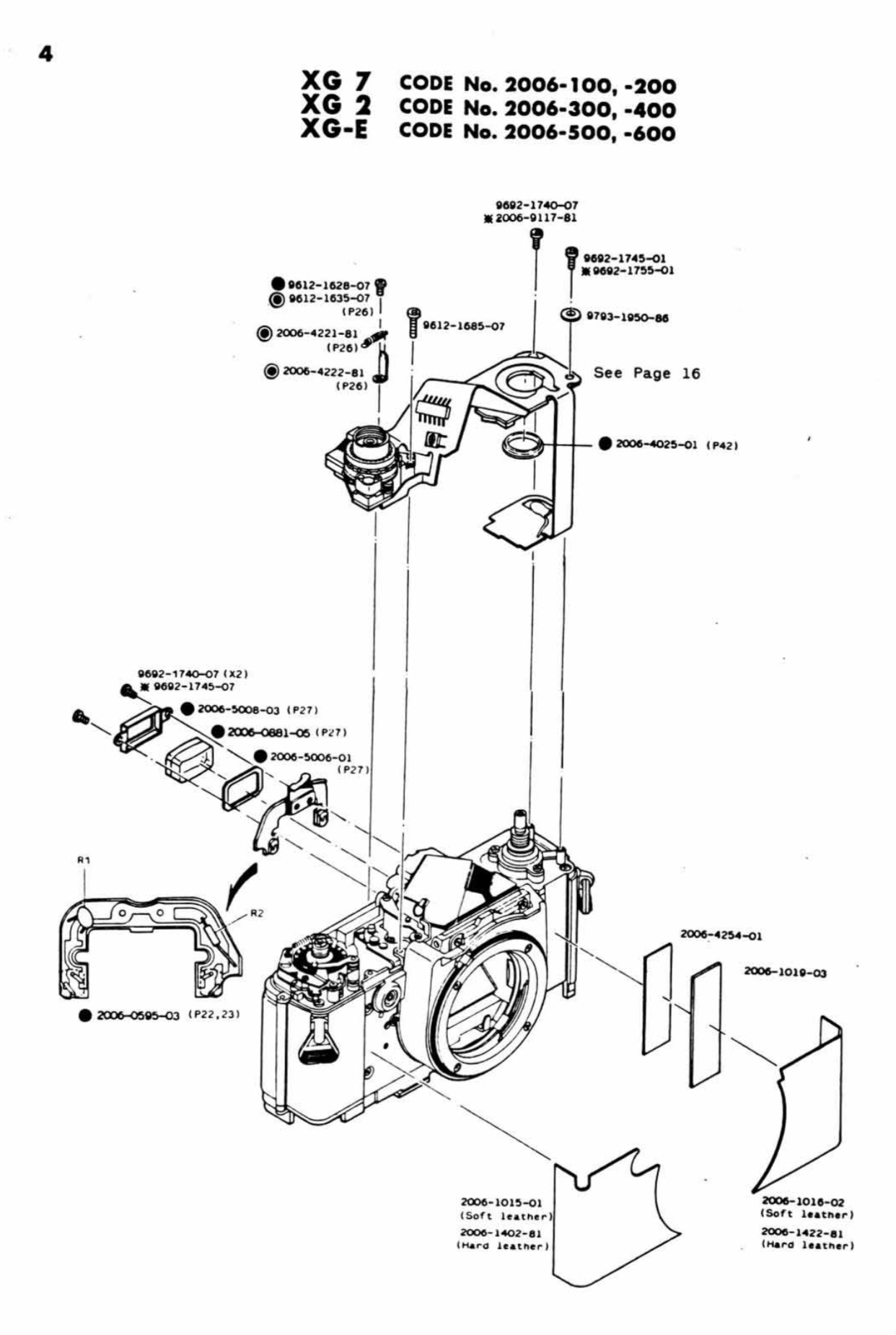

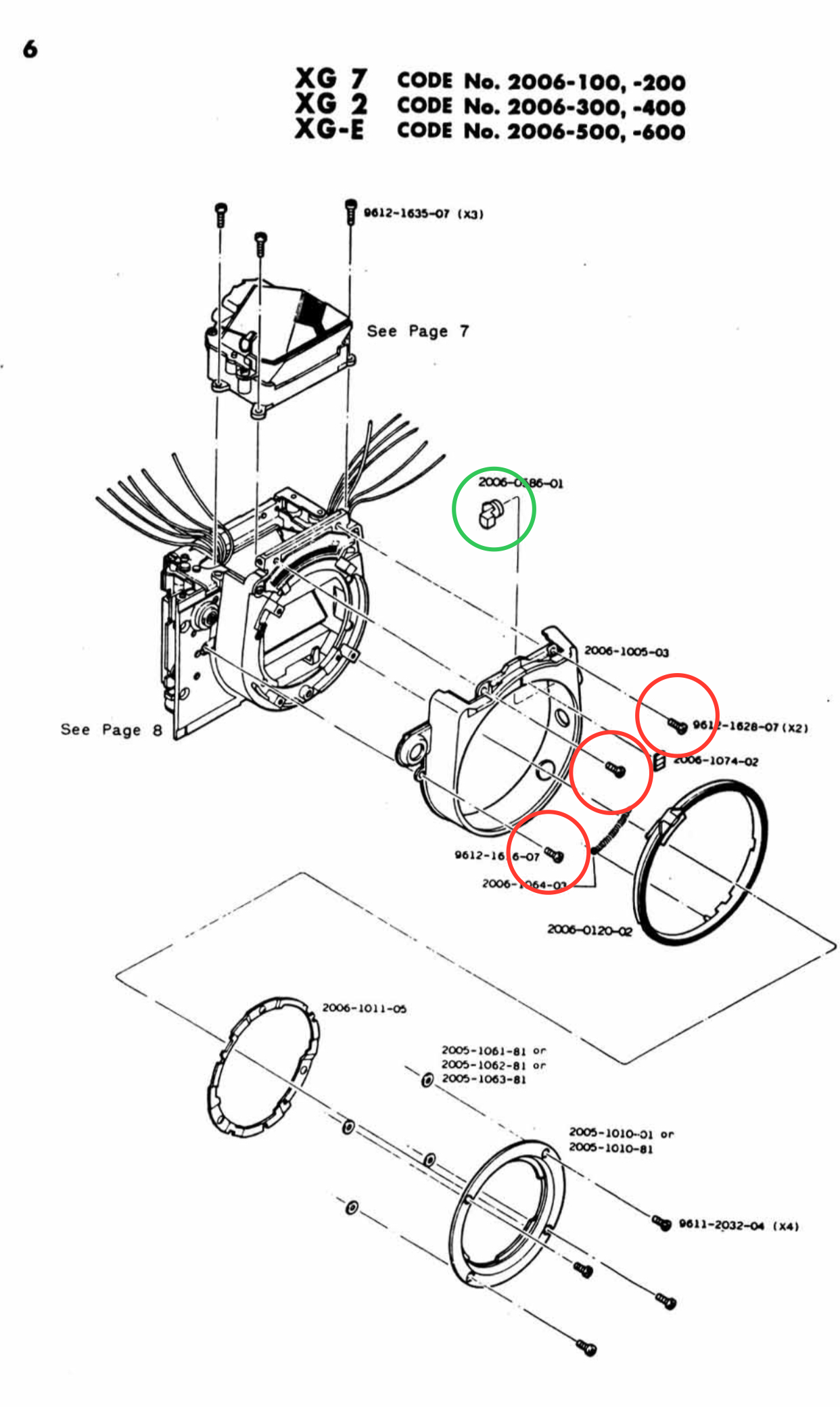

The parts of the leatherette on the fronthousing.
The screws (red) should be able to be loosened even with the lens attached. The lens release button (green).
Yes, I have that manual too and I know which screws to remove, etc but the diagram doesn't include a lens mounted on the camera blocking the removal of the bayonet cover.
Again: The bayonet cover should be able to be folded away to the side.
The screws are outside the lens.

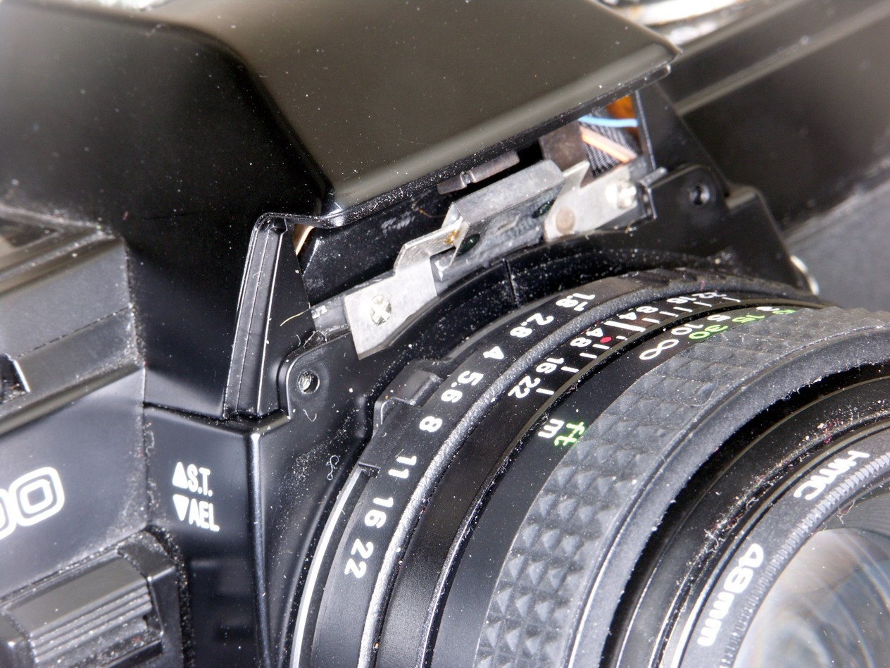

I just picked up a Kalimar KX 7000 (a nice variant of the Minolta X-370 with multi-exposure capability) with a very nice 50mm Kalimar lens and case for $5. Unfortunately, the lens release button appears to have the same problem detailed above. It's basically stuck in the "pushed in" position, and the lens will not twist off. I don't see any signs of damage, water, corrosion, rust, melted cheese, sand, etc. I also don't see any screws to remove to access the interior.
When I get a chance, I'll start removing the front leatherette and see what I turn up. Any suggestions (such as those above) are welcome. I'll also put in some batteries to see if the puppy turns ON.
xkaes
Mar 25, 2006
4,789
Colorado
I put batteries in the Kalimar KX 7000, and everything works like new -- the camera AND the lens. That's the good news.
So I did a little "digging" to figure out if I can get the lens released.
I removed the Kalimar name plate, and can see nothing that might give me access to the lens release mechanism. What's showing in the photo is the mirror box for displaying the set f-stop in the viewfinder (a feature the Minolta X-370 lacks).

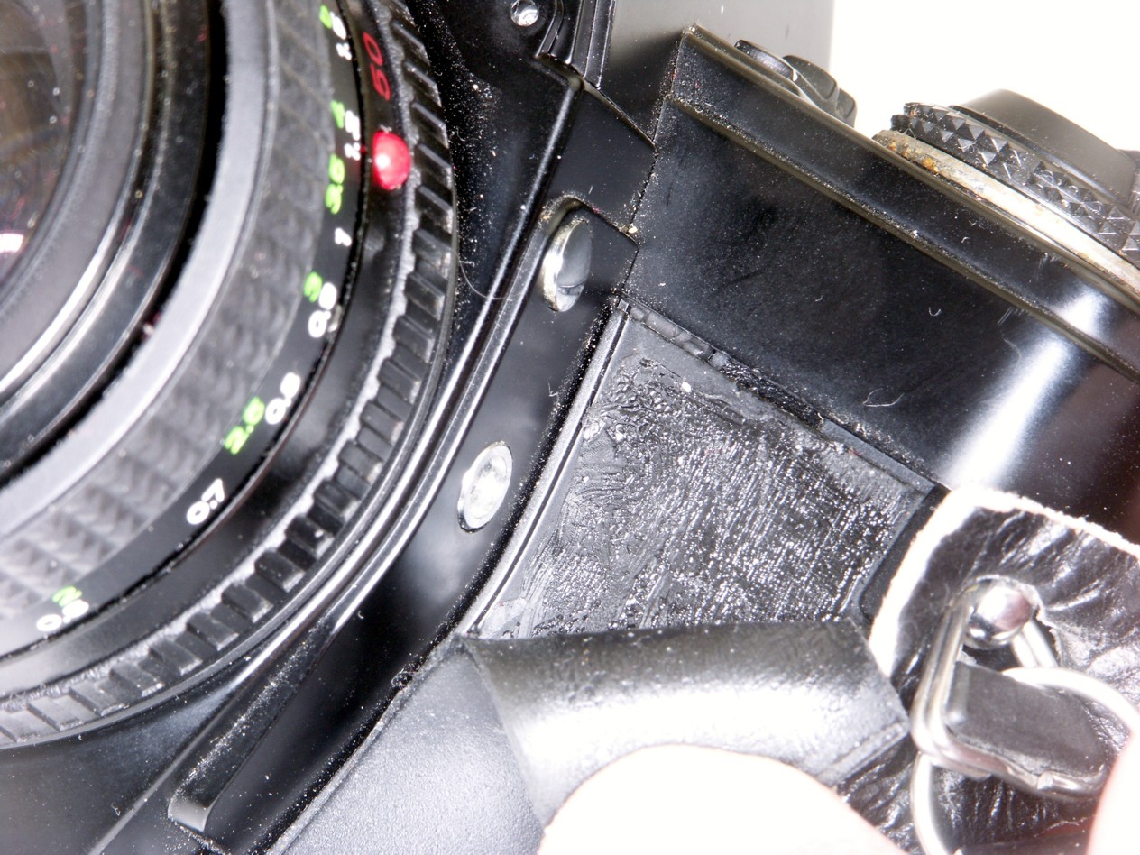

The second photo shows what is under the rubberized "leatherette" body covering. I see no way to access anything that way either.
Any suggestions as to what to try next. As I said, I can use the camera as is -- it works like new -- but swapping lenses is the goal.
