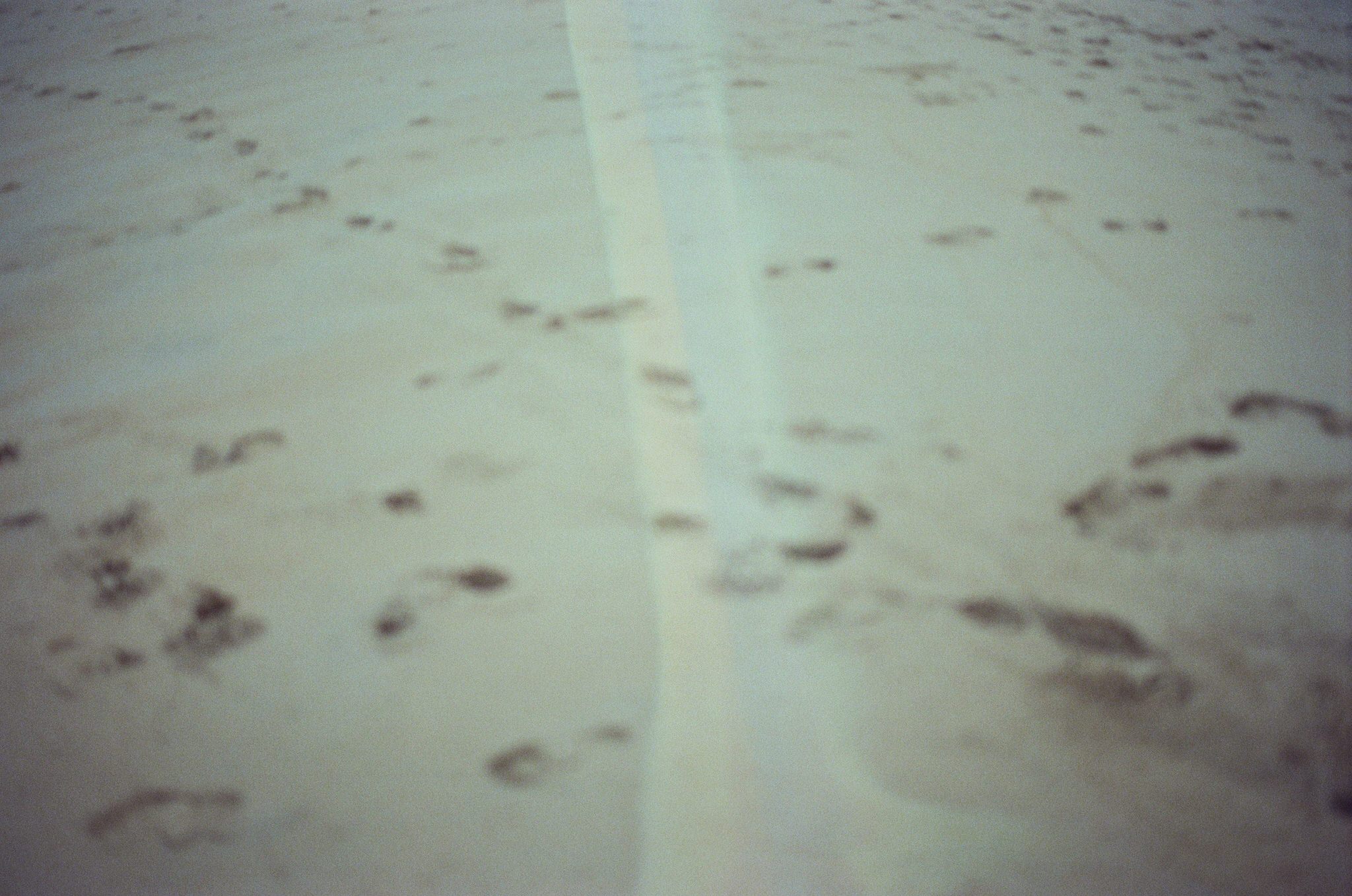

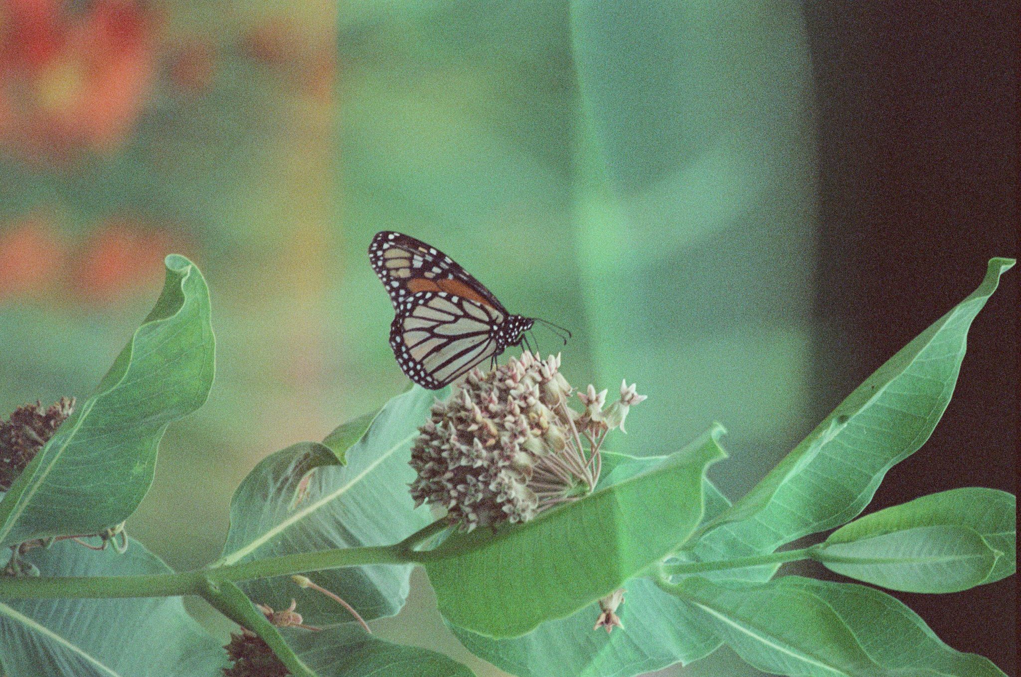

Thank you so much for your quick response! I will attach a couple of examples to this message. I am following the directions here: but did the 1+60 indicator stop bath instead.

Well, that's a distinct effect for sure. Doesn't ring a bell right away, but my first questions would focus on what kind of tank you use and how long it takes you to pour in the developer?
Also, I notice the images as presented are very low in contrast and rather grainy. This can be due to scanning & post processing, but it can also very well indicate problems with the negatives along the lines of incomplete bleaching or (especially) fixing.

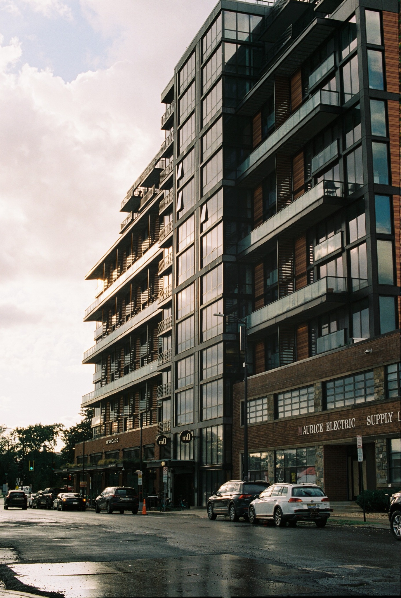

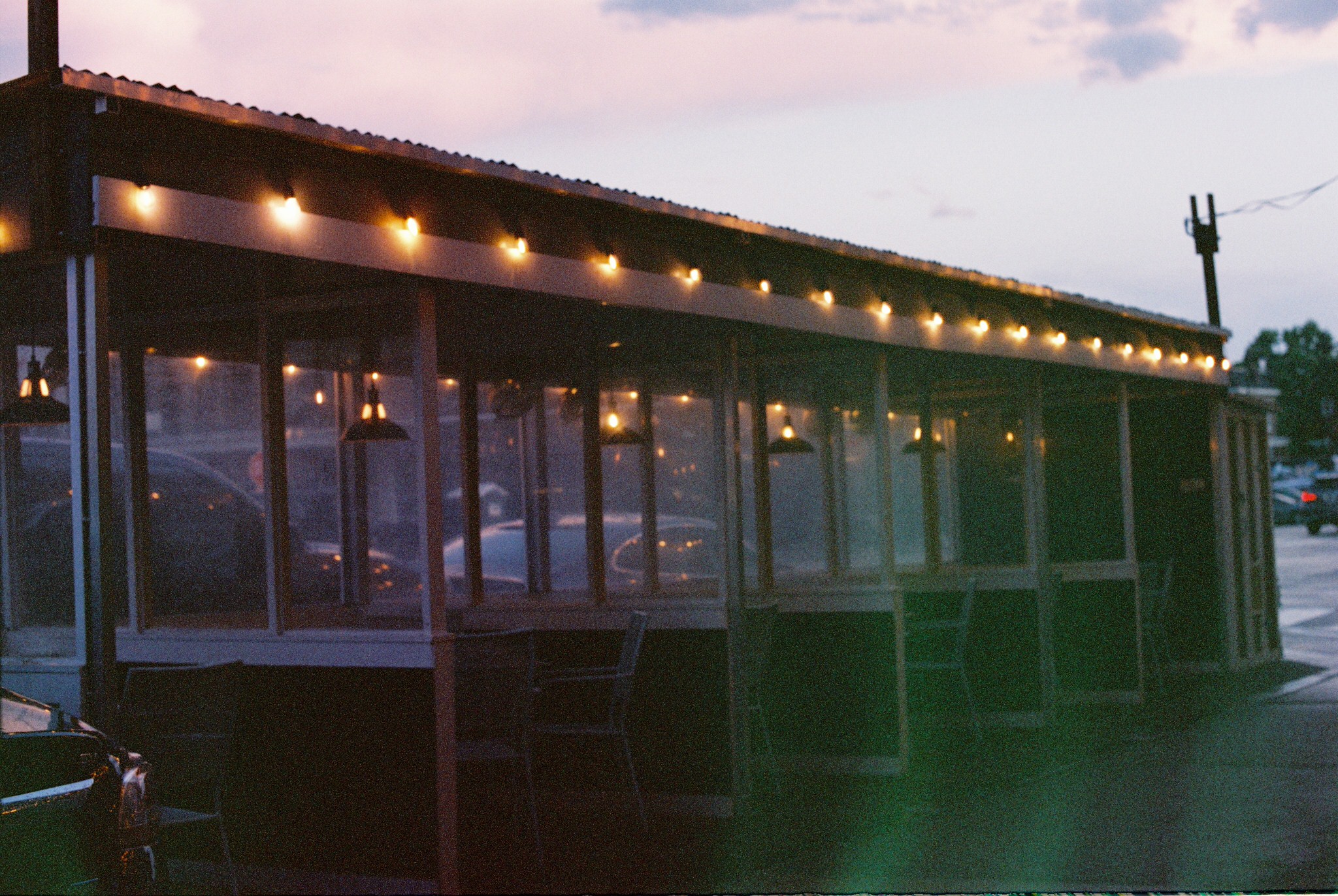

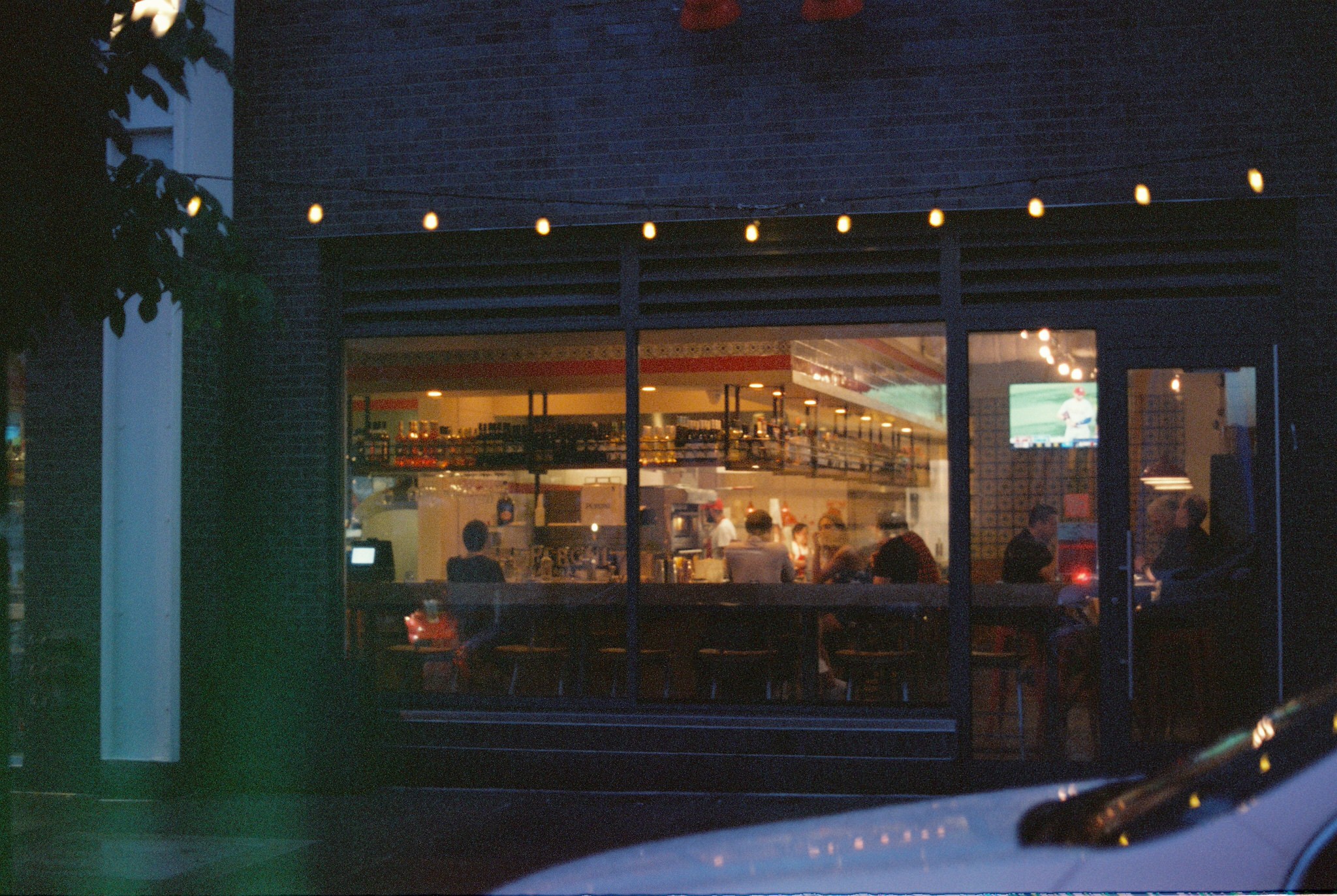

And here are some more scans. The marks show most on expired/underexposed negatives. But you can see some of the greenish haze on some of these. Other ones are totally fine and show no marks at all

I mean to say that it was expired and pretty fogged from age.
Try fresh film, see how it goes. Although the damage I see so far is not typical for regular age-related fog. It may be simply fogging due to light leaks somewhere in the process. Heck, could be anything at this point; dig up the negatives and have a closer look at those. Scans generally don't tell a very complete story.
