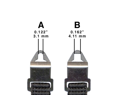

I use the Optech Super Pro strap with lug B connectors on my P67 and it seems to work well; in fact I've bought additional B connectors for my P67 FujiRoid body.
As I understand the chart lug A shout fit Kiev, but maybe I misunderstood your OP.
edit:
This photo shows the B connector has a larger opening...

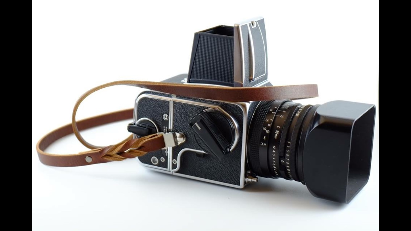

Is this what you are looking for? I custom made leather strap for Hasselblad. I believe Kiev 88 uses the same lug.
Sherman

Thanks all for your suggestions. The problem with the strap I have is Not the width of the narrower part of the opening of the connectors (as shown on the Photo of the optech connectors) but the maximum width of the opening. The lugs on my salyut are apparently larger, 6.5 mm, than those on the other kiev's. These openings seem quite large on the optech connectors, but i'd like to make sure before ordering them. Does anyone have these measurements for me?

I get ~ 8.16mm
edit: I used a digital caliper.

Thanks for your troubles Dan, I ordered the Op/tech strap with A connectors and they fit perfectly.

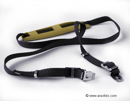

Some oldest Kiev-88 has strap mount from Salyut.
You need the old strap strap - see attachment.
Unfortunately we have not it.
Here is his attachment:
attachment.php

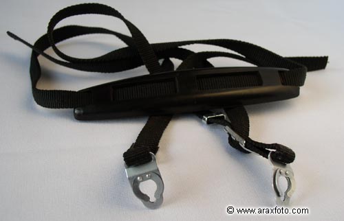

, and here's what I bought, that doesn't fit:
attachment.php
. Indeed the holes are smaller.
My Kiev body is from 1987, so it's not all that ancient. I wonder why it has the old-style lugs. Anyway, did you find a solution, fotobug88? I am going to try filing the holes a little bigger, and if that fails perhaps getting one of the OP/TECH straps zabai mentioned.
