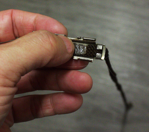

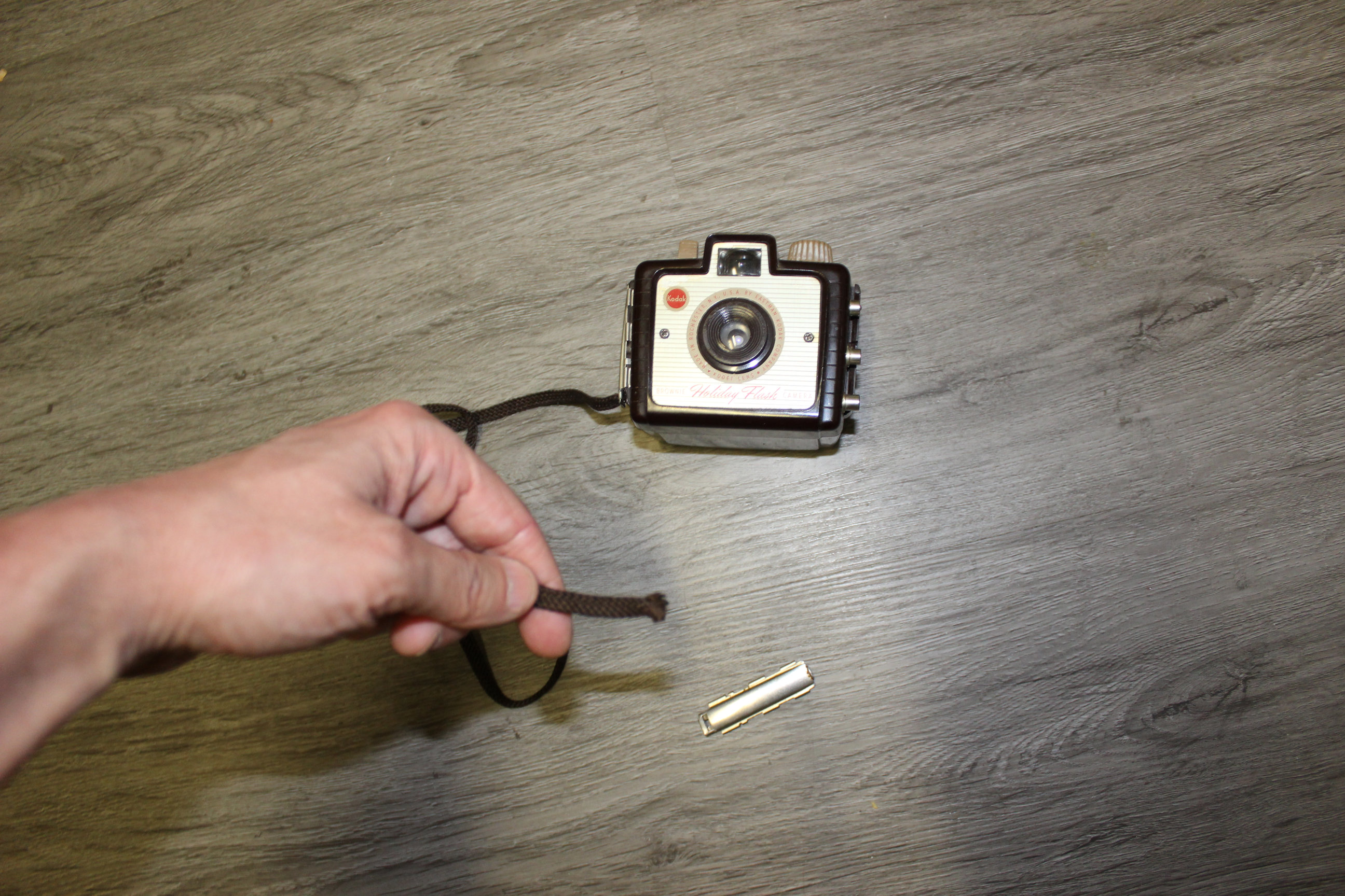

This camera belongs to my mom. I cannot seem to reattach the strap to one of the side locks of this camera. The strap was cut by yours truly because I had originally thought that part of the strap was preventing one of the side locks to not come off the camera, this was not the case. I then saw a bent piece on the side lock which appears to be the culprit. The side lock was jammed on the camera and I had to gently lift it to get it off.
I ordered a set of small pliers for working with the bent piece on the lower side of the side lock from the first picture. Second picture shows the slit that the strap needs to go through. I would like to preserve the strap and get it back on and I am seeing that this will be a challenge. The strap is very easily frayed. I do not see how it can be inserted into the lower slit due to clamped metal section being so tight. I feel bad for cutting the strap.
Is there a possible fix for this?

The last one of those I had with a remaining strap, the strap was a synthetic of some kind. If that's the case, you can stop the fraying by heating a fresh cut with a match flame or lighter (or cutting with a hot blade).
If it's natural fiber of some sort (still a possibility, depending on the age of your camera) you can do much the same by working Elmer's or similar white glue into the cut end. Let dry overnight, and trim with a razor blade or Xacto knife to remove bulges and let the strap fit through the latch lug.

Last night I did wrap around a tiny bit of scotch tape around the cut end and was able to kind of get it into the slit of the slide lock but I am stuck at pulling the end more into the lock. I am just now waiting for the pliers to arrive to see if I could gently pull that end part more into the slide lock and under the clamp area and then remove the tape. I tried using tweezers but that did not give any real grip onto the strap end for pulling. The strap looks more like a shoestring than a strap, lol.
I like your plan and would like to try this and maybe I should hold off from what I am waiting on doing?

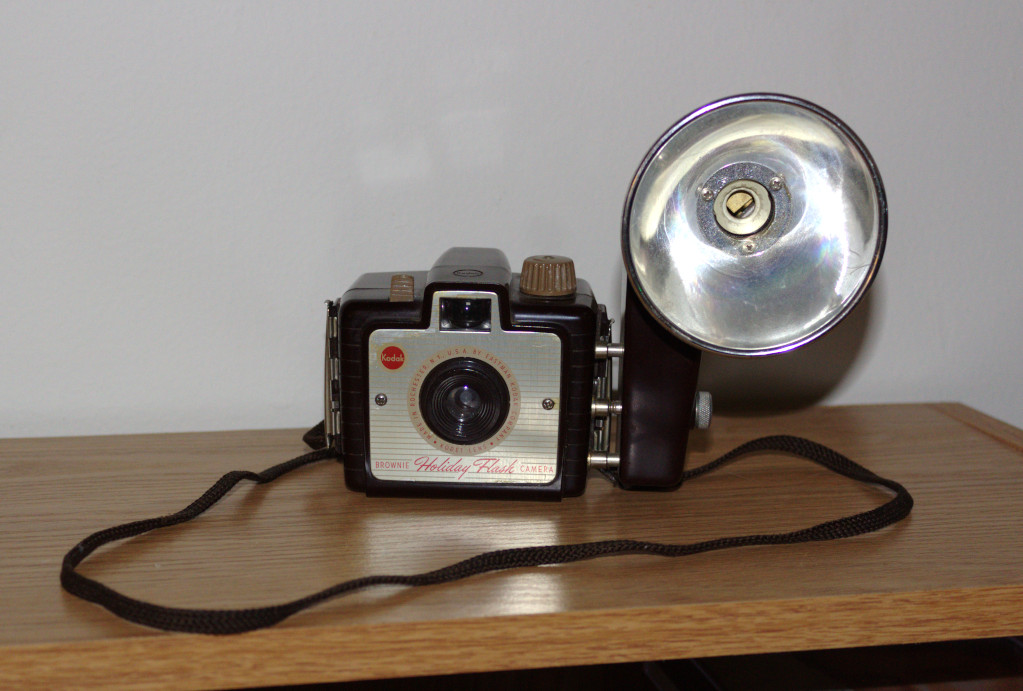

I like the old little manual for the camera. I like how they refer to the bulb as a "lamp" on page 2 and 3. My mom also has that flash holder along with some sort of pop-on diffusion piece that is somewhere in one of her old storage boxes. The diffusion add-on looked really gross from the last time I remembered seeing it. Browned big time like it was tobacco laden.

I suggest that while white glue might be suitable for a textile strap, shellac will more easily penetrate the fibers and be shaped by using some heavy foil to size for the opening and squeeze out excess fluid, for your strap.
Most fingernail lacquers are too thick but some might work as well.

Got the strap back in and I also had to bend back a tiny metal part, shown at the bottom where my thumb is in image #1, which was bent down and preventing the slide lock from going back onto the side of the camera. Sides go back on now, YAY.
