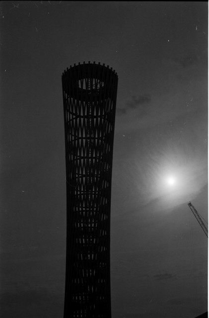

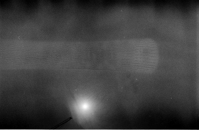

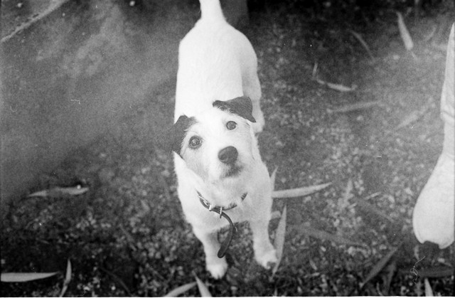

I recently received my B&W developer kit (Rodinal), and I tested it yesterday successfully with a Tri-X 400. Everything was perfect. Today however when I tried to develop a roll of T-Max 400 which was accidentally shot at 100, I got some strange results. (See the pictures)

I'd say insufficient fixing. Refix your film and you'll probably be fine.
With a short development time (any under about 6 minutes), you're at more of a risk of uneven development. That could be what happened. It also might need to be refixed for longer. The T grain films need longer fix times. 5 minutes might have been ok, but I don't know what the usual times are for Adofix - I use Ilford rapid fixer and I fix non T grain films for 3-4 minutes and T grain films for 6-7 minutes. With 35mm, you could have used the piece of the leader you cut off to get it on the reel and dipped that in the fixer, timed it to clear and then used double that.
Thank you for your answers. I'll try tomorrow to fix it again. I'll do the test with the leader, thanks for the advice. Am I right that Adofix is reusable? I mixed it 1:9
Let me elaborate a bit more why I think it's a fixer problem. Judging from your images, the lightest parts of the positive image are towards the center of the film. Lightest means denser at the negative. Development, as well as fixing, progresses from the edge towards the center of the film. The pattern at your photos is typical for underfixed film, you can notice it yourself if you fix a film clip in a graduate. So, if the center of the film is denser, then it's probably fixed for too little time. And it can get even worse if your fixer is also too cold.
Now, regarding development time, 3:45 is low. It's not only that it can lead to uneven development, but it's just unreasonably low. The massive dev chart page for this combination lists several times and the one for EI400, Rodinal 1+50 is 12'. The one for EI200 is 8'. If 12' is correct, then 8' is a 33% reduction for a 1 stop pull, probably a bit on the low side. 3:45 for a two stop pull sounds just weird. Seriously, don't take the times in the massive dev chart as necessarily correct, anyone can submit his own and they're not necessarily verified. Regardless of that, I'd also have to say that a 2 stop overexposure isn't a disaster, especially with this film. You could process it normally and get away with it. Cutting down development by 25% would probably be the best approach.

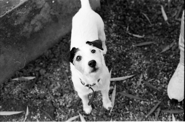

You saved my photos. Thanks again for the knowledge and the tips, I think I've learned a lot. I put the negs into the fixer for 10 mins (same fixer, the 1+9 one I mixed on sunday, but this is probably the end of its career :smile: ) and it worked like a charm. I noticed the negative had lost its purple hue, it's pretty clear now. (Sorry for the dirty scans, getting clean results is my new challenge :smile: )
