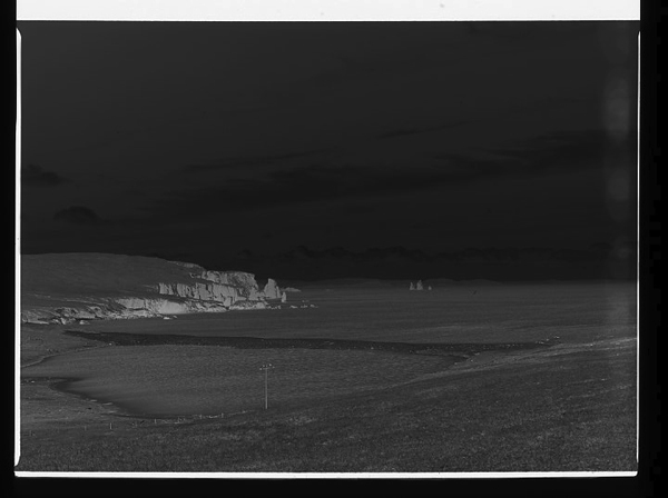

Can anyone possibly advise/help solve a problem I’ve been having with strange marks on negatives following development (in standard Patterson tanks of various sizes)? It always appears as shown on the scanned negative (120) attached - always down the same side of the negative, though very variable in degree between different films and different parts of the same film (this example is moderately bad), though with no pattern I can discern, always appearing as pale “blobs”. It’s like fogging, except it’s the opposite, being white on the negative, so perhaps an area of underdevelopment???
It happens with different film types and different developers, including Prescysol (I have generally used Ilfotec HC in the past, but one reason for wanting to try Prescysol was to see if this might get rid of the problem!). I’ve tried cleaning then buying new spirals in case there was any contamination. I’ve tried different patterns of agitation. I’ve tried adding a little wetting agent to the water for the predevelopment soak. Nothing seems to work! I’ve had the camera (Mamiya 645) & interchangeable film backs looked at, but it looks like a processing problem not an in-camera problem.

Thanks pdeeh. I have tried again to reattach the scanned negative below - the marks should be visible, but I can get a photograph too if needed.
I use 500mls per 120 film, so there should be enough volume, and I do a pre-soak with water at 20C & one drop of wetting solution (something suggested by Patterson when I asked them about this problem).

It's not a scanning artefact (I don't scan my negs usually - this was just done here for illustrative purposes) - the "blobs" are clearly visible to the naked eye, and on contact prints.

contaminated film spool. i.e. you haven't cleaned the paterson spools properly after using them last time.
I would initially have said spool had slipped up the column but on close inspection of neg after inverting and adjusting brightness/contrast I suspect its contamination but I can't be 100% sure about that.
It could also be air bubbles trapped as suggested above.

We just had this a couple of days ago in a very similar thread, these are most likely areas of underdevelopment caused by air trapped between the film and the upper parts of the reel. Do you tap the bottom of your tank on a surface before you start your inversion cycles? This may or may not help to dislodge bubbles. Do you pour the developer in with the reel already inserted in the tank? If yes you might try it the other way round (put the reel in the filled tank). It may or may not help.

Air bubbles do seem the most likely explanation (I think the edge affected is the uppermost), though I have not always had this problem. I've tried various agitation patterns, including simple inversion (continuously for the first 30s then 5s/2 inversions every 30s or 10s every 60s, tapping the base of the tank initially to try to dislodge bubbles), inversion with a twist/swirl (as Ansel Adams recommended I believe) & an initial 60s inversion period following by 10s every 3mins (one of the techniques recommended by Peter Hogan who produced Prescysol developer.

It looks to me as if the reel has slid very slightly up the center coloum, I always use a little more chemical than the tank needs in Patterson tanks, that is, I use 600ml for 120 rather than the suggested 500ml to guard against this happening after it happened to me a couple of times,

These look to me like a classic problem with air bubbles. Try to eliminate them by further experiments with your agitation regime.
Are you ensuring that there is at least some air space in your tanks, in order to make sure that the developer "tumbles" through the film when you agitate?
Can you determine whether the marks are always at the same edge (top or bottom) of the film?

I'm not familar with the Mamiya 645, so forgive me if I'm being dim, but the short edge with the marks is, I assume, the edge in the tank spiral ? In which case, it does look like something with the spirals ?
In any event, I do think that your idea of identical films with different processing will almost certainly solve where the problem is.

Strange coincidence just looked at a film developed this week in Prescysol and it has the same marks. Can't be certain whether it is the edge at the top or bottom of the tank but thinking about the way I load the reels it is more likely to be at the bottom of the tank or at least sitting on the lower one of the two reels. I will keep a careful check on the next one.
