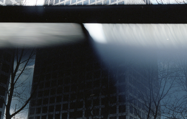

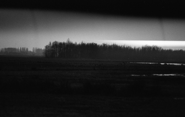

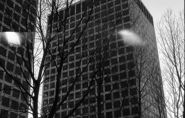

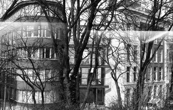

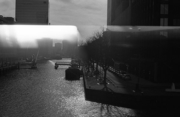

Hello,
I,m Case-ie and this is my first post
I have a problem with my Pentax ME Super, On a few roles of film now strange light brackets appear on the negatives and also between them. It's on always a few following negatives and with a lot of variation. If anybody has an idea what causes this, i'll be very pleased to hear it.
Case-ie

With a light leak artefefact #1could not be explained.
I'm rather thinking of a exposure moving perpendicular to the shutter movement. This could explain the bent streaks.

Sticking mirror, or the mirror is coming down before the exposure has finished. Perhaps related to a disintegrating or sticky mirror bumper.

Thanks for your quick replies. I had mirror and shutter controlled in a analog camerashop no problems there. Of course they test them without the lens on. Sometimes parts of the picture are not lighted that must be a shutter problem.But the brackets go on on the unlighted areas between the negatives. And the mirror folds up and away from the film, reflection seems difficult.

Mister van hoegh, had not read your reply when I replied, i also think there is a problem with the shutter but it was tested in a special set up in a analog camera shop but this is with the lens off the camera. Still the problem between the negatives. Thanks for your reply. never seen a light leak this tight they tend to spread out. I have also been thinking that it happens during filmtransport that I push the backside so it slightly tilts. maybe when advancing film or while transporting back, I think now next time I tape the camera close. then there still is the black line in picture 1 but that would be the shutter than.
