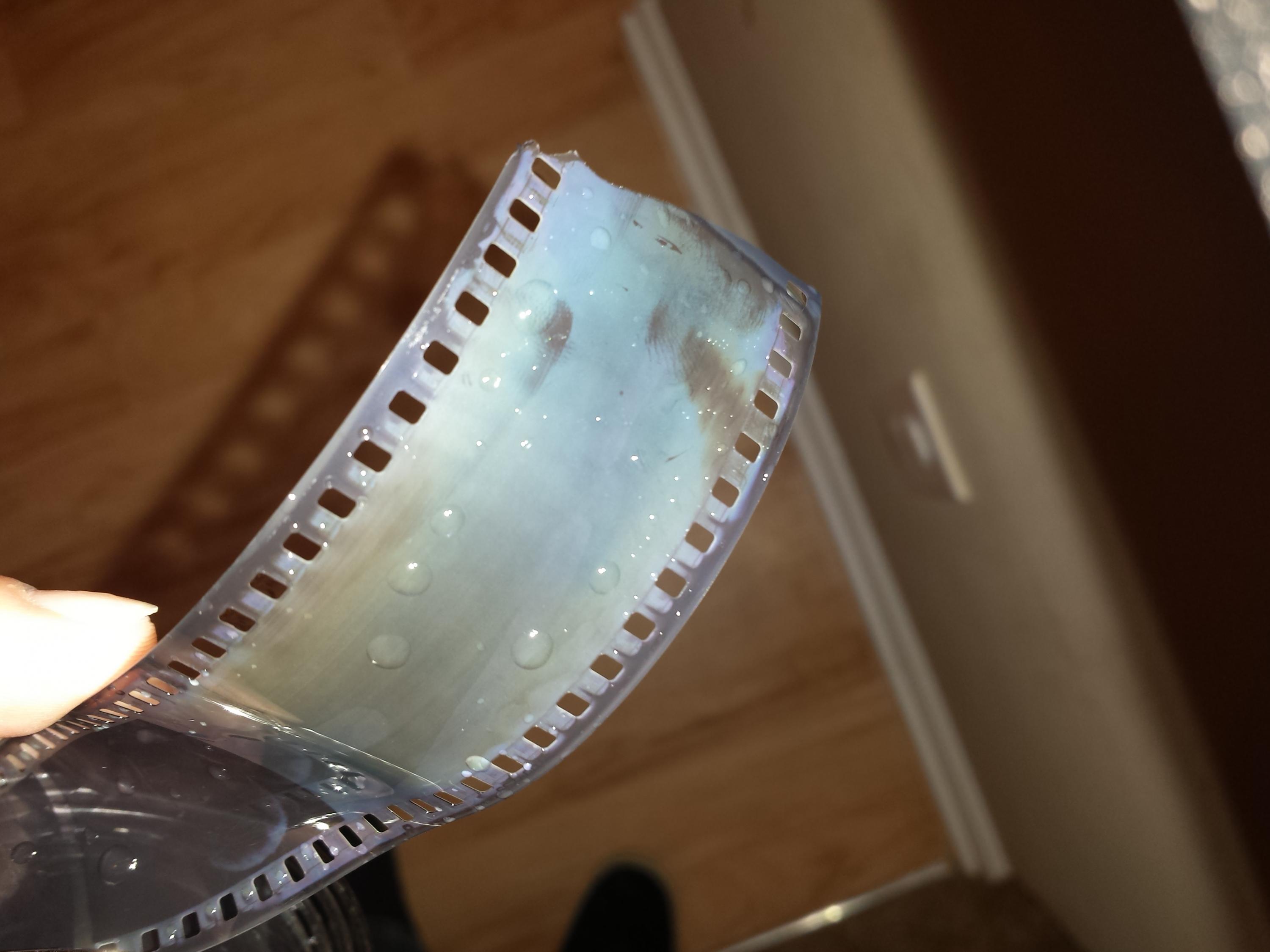

When hanging up some 35mm acros I noticed what looked like unfixed silver. I had fixed it along with some Tmax so I thought it was odd, since acros has never seemed like a hard-to-fix film to me. After I re - fixed in the same bath, there was no change. I mixed up a hot batch of fix (sprint record speed fix) at 1:3 and tested it with some 35mm film from the floor. It cleared in 30 seconds. After another 5 minutes in the fresh fix, the residue was still there. What could this be? The film expired 2011.

Very strange, because it looks un-fixed to me, but as TMax usually takes a good minute or more to fix, the Across should have been fine. My experience is that across fixes quickly, like FP4 or Tri-X, so this has me scratching my head.
Is that dichroic fog?
I have heard of dichroic fog but never seen it. The picture emphasizes the fog...it seems like the negatives might print ok. Is it possible for fixer to be old or spoiled such that it would fix tmax but not acros?
Dichroic fog is rarely seen on modern materials. It might be worthwhile to pm Photo Engineer about this.
Could this happen if the film was exposed to light between the stop and fix? I have always considered it safe to expose film to room light as long as it was stopped and had been dunked in the fix.

Dichroic fog is a form of physical development, and it occurs - even with fresh and modern film stock - if there is too much solvent in a developer. It's called "dichroic" because it has this yellow-bluish sheen. What you see here is tiny Silver particles that a regular fixer will not remove in a few minutes, and whatever you do to remove it will also attack image Silver to some extent. Since the pics are almost impossible to enlarge this way (see the finger print patterns), you'll have to carefully use some BLIX (C-41 or E6 BLIX, Farmer's reducer, ...) to get rid of it. Make sure you rinse it immediately as soon as the dichroic fog is removed, and rather repeat the removal cycle a few times than remove too much Silver from weakly developed regions.
As to the reasons why you got this fog: you didn't tell us which developer you used. If it was some normal developer, maybe some fixer got accidentially mixed into it. If you did some experiments with your own brew, go easy on the Silver solvent.
Developer was R09 One Shot at 50:1. I was down to the very last few mm in the bottle, so developer composition may have been different than a fresh bottle. Development was done at 25C for 10 minutes (I was trying for a push).

Whilst you can never be sure without it in front of you, I have had a look at the enlarged image, it does not look like dichroic fog to me ( at all ) plain and simple unfixed. Re-fix and we will know for sure.

I already re fixed twice in fresh fixer which I tested to clear film in 30s, in addition to the original fix which was sufficient to fix a roll of tmax which looks fine.

I saw dichroic fog very recently, with fresh Tri-X, processed in complete darkness and normal temperature, but an experimental developer that was high in solvent. I've also seen underfixed film before, but the images BetterSense posted remind me of my dichroic fog samples. The biggest difference, and what gave it away top me, are the fingerprint patterns on the film, for some reason you get these with dichroic fog but never with underfixed film.
BetterSense, did you just mention two bath fixing with a very exhausted fix 1? That would explain it. Fix 1 became alkaline from carry over, to the point where development could occur. Loaded with Silver, there was plenty available for physical development. I think we have your culprit right there.
If you do this again, use a stop bath and rinse a few times before you fix, this way pH of fixer 1 stays below 6 and no development will occur.

The fix I was using was well used but still had enough to fix tmax in a reasonable time I was only using 1 bath. I used to use 2 baths back in the good old days when I had a darkroom, and I would use bath 1 until it didn't work at all, with no problems.
The rodinal I was using was old and had crystals precipitated out. It was still working fine for many rolls that way, but this time I was developing at 25C since I was out of ice.
The fog does look reddish on the light table. Happily I was able to print the images I wanted despite the fog.
In the future I will throw out my Rodinal if it precipitates out slushy crystals, develop at less than 25C, and rinse my film extra well be before the fixer.
