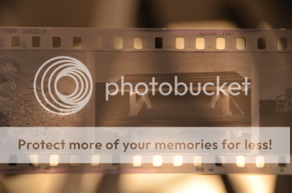

No it's clearly been developed OK, you can see "400TX" in the edges. I agree with the crinkling theory because the densest stress-fog lines are at the corners of the sprockets, which means the film has had some seriously tight bending applied to it.
Note that you can get stress fog without the film looking crinkled. Just bend the film real tight and release it; the backing won't show a fold but the emulsion will be fogged there.
If that's the case, perhaps the students tried to rewind the film into the cassette without releasing the rewind button (assuming an all- manual camera), over-tightening it. I've never had this problem either - very odd!

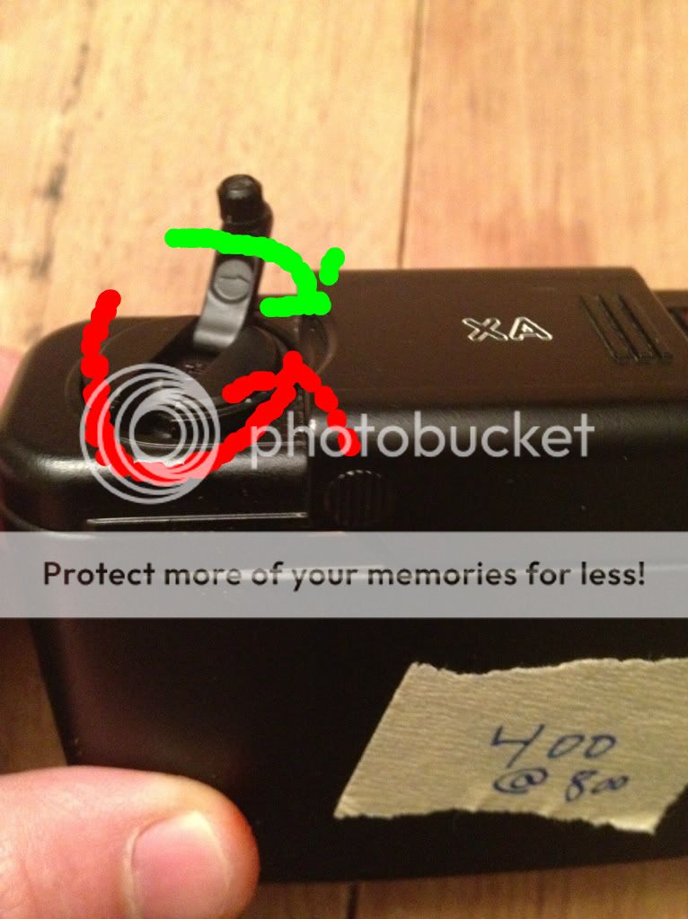

I did a test to see if I could replicate the striations:
Bulk loaded (normally) 10 or so frames of Tmax 400
-Shot it at 800 on an Olympus XA
-Winded backward, the direction of the red arrow below:
-Loaded on a steel reel in darkness, the normal way, I unrolled it and rolled it normally on the reel
-Xtol 1:1, 14:15mins, yeah I cooked the film a little bit, but I had some HP5+ to do in the same tank that needed 14:15, wasn't wasn’t going to do a separate run for this film (Tmax 400 at 800). The suggested time wd have been 9:30 but it still came out acceptable:
I took a photo of the neg as it dry, the background is noisy, I know, far from ideal, but you see what I see. I dont see the striations that we saw from the OPs example, but who knows, my camera, when rewound backwards, could be more gentle? I agree those striations the OP sees could be from reverse winding, but I am still questioning how on earth the latent image wd have been taken away too? Think there were double issues? I do see some edge damage on my example. I am going to say my test was inconclusive…

Btw, when I did the above test, it was extremely hard to reverse wind my film, there was a massive amount of pressure on the film and rewind mechanism, to the point I was worried it would snap (thankfully it didn't). I would not recommend reverse winding to anyone, I did it bc I have a parts camera laying around and figured I would do the experiment above....
