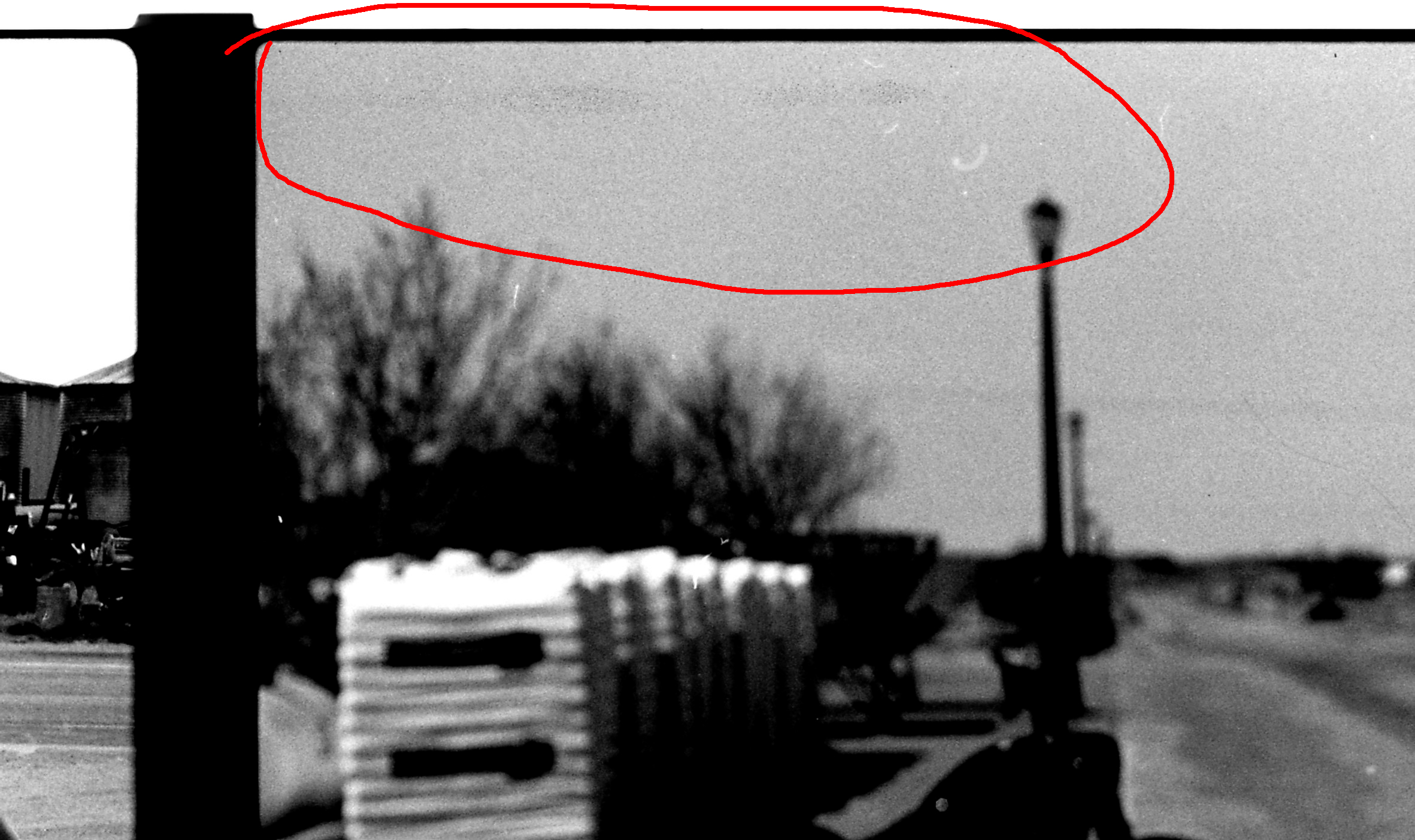

@Nikanon Can you post a few images of the negatives from the other films with similar marks, please?
Maybe it's just me but when I looked at the OP's image of the negative, the mark/line goes as far as the negative image area edge but not onto the film space between the images.

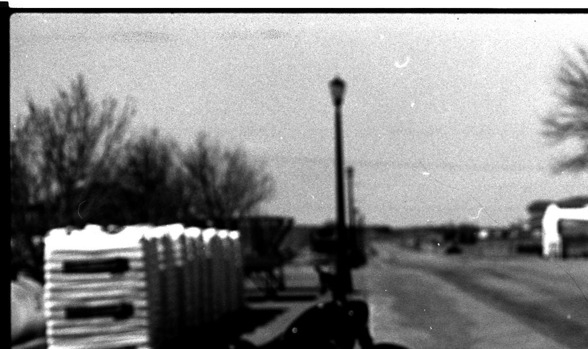

Months later, It appears I am still getting these weird marks. Must be some kind of clumping ? I really do not know. This is on Ilford FP4 this time with a fresh batch of Xtol. Overall the image detail shows there is some clumping all around in the trees and such as well, somehow related??

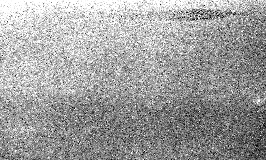

Here is a closeup with exaggerated contrast to show more of the shape of what im getting now. I just took a second look at how the film sits in the reels (hewes) and the image area is really pretty far from the metal for this to be caused by this as far as I can tell. This particular roll was Ilford FP4 shot at 200 developed at 68F in Xtol 1:1 for 13 minutes. To me this grain looks kind of clumpy, but that would mean the larger black spots are actually clear on the negative. I just cannot figure why there would be that shape at the top (this is at the top right of this frame, its always about a millimeter from the top edge)

It looks like a smear if you look really closely, doesn't it?
I was trying to think is there something in the drying process of the film that would cause it, it appears to be a horizontal streak in how it gets larger and smaller. But what would cause LOWER density? I cant think of anything
