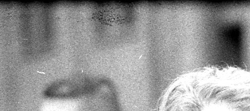

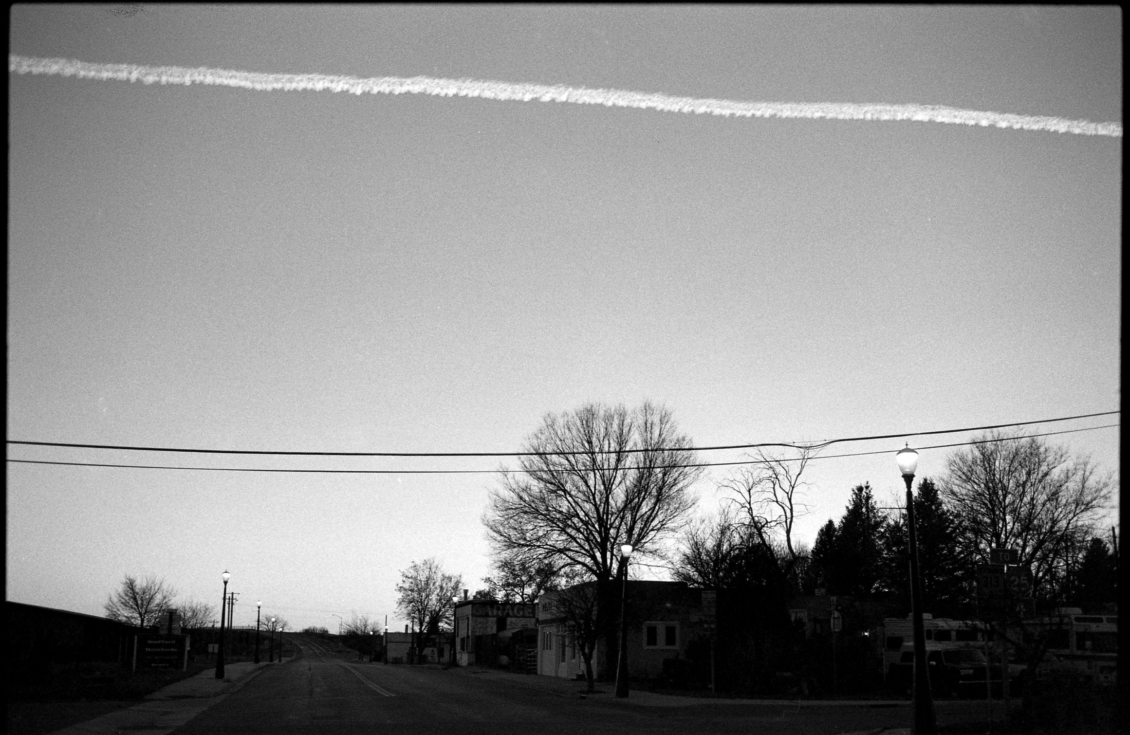

Near the top left of the frame there is a cluster of black smudge looking stuff. This appears in multiple frames in various locations and usually further into the frame. I cannot figure out what is causing this. This is Agfaphoto APX 400 developed in Xtol.

We can't tell much from a scan. Can you see them on the negative itself?
MattKing
Apr 24, 2005
53,325
Delta, BC Canada
It would be much more useful to see backlit digital images of the negatives themselves - including the edges and spaces between the frames.

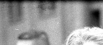

This is the best image I can get of this same mark from the negative

There is less density in the negative where the marks are, which would tend to indicate something like one of two things:
1) some sort of debris in the camera near the film plane at the time of exposure; or
2) something inhibiting development - such as fingerprint oil on the film prior to development.
The other thing to consider would be some sort of post-development physical damage to the emulsion side of the negatives.

If all or several of your photos have it in the same spot, there was lint or some other debris stuck in the film gate.
I see it on films regardless of camera but not every film. It’s always pretty close to the edge , the finger oil seems somewhat plausible, maybe as I am gripping the film on the edge and loading it I do use metal reels

Ultimately I can be handled, but it’s not ideal. Also having shot thousands of rolls, and only seeing this now and then. It’s always been strange to me

Can you wear nitrile gloves while loading the film on the reels? This could eliminate the possibility of oil on fingerprints.

Not to pile on here, but it does just look like a partial fingerprint along the edge of the film. If you try gloves, and you still get this smudge, please report back, because it will then be a real mystery. Does not look like a manufacturing problem.

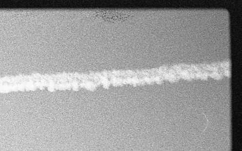

Hello again, I have used gloves and am still getting this issue, here is a particularly good example of the problem.

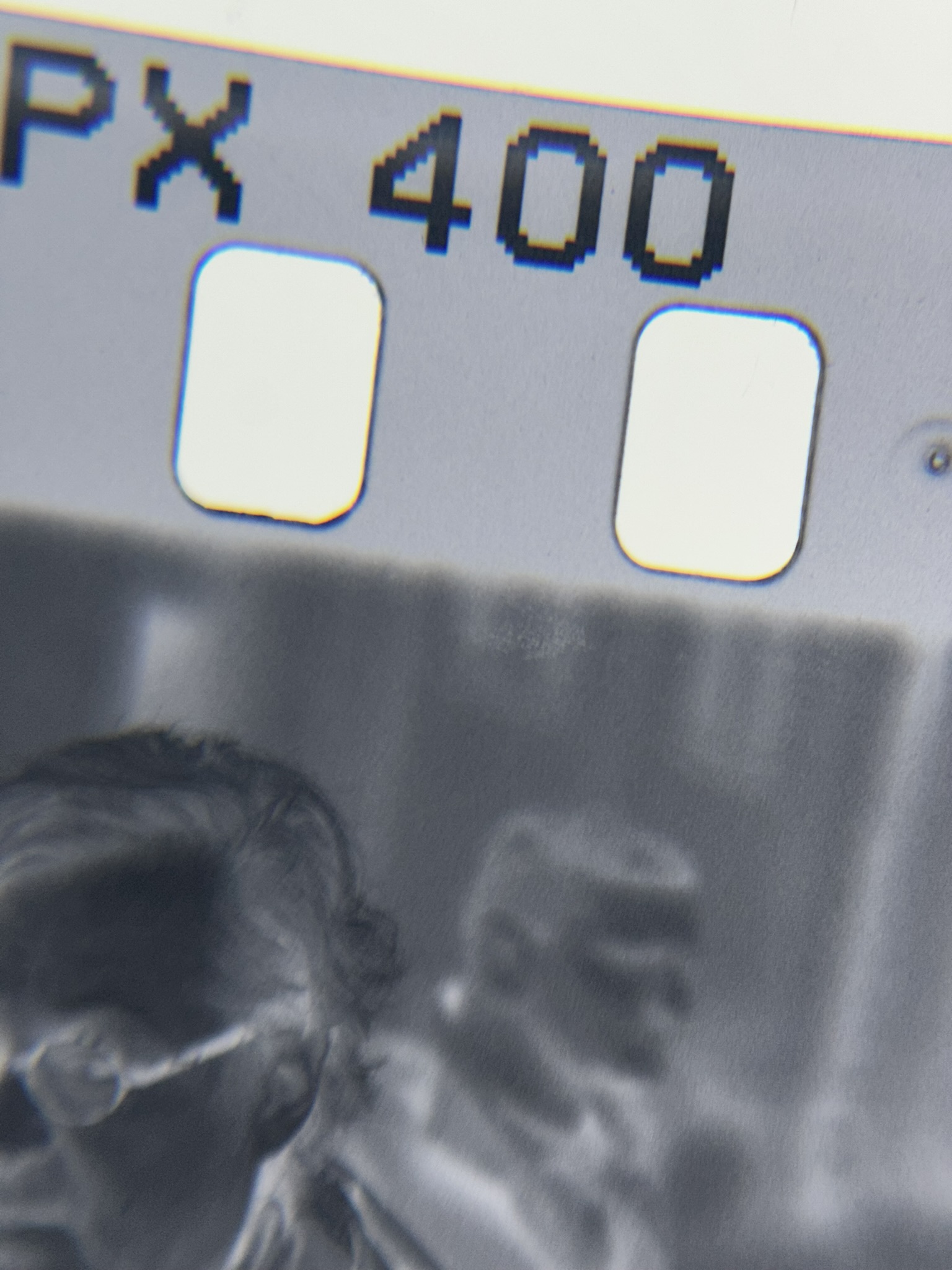

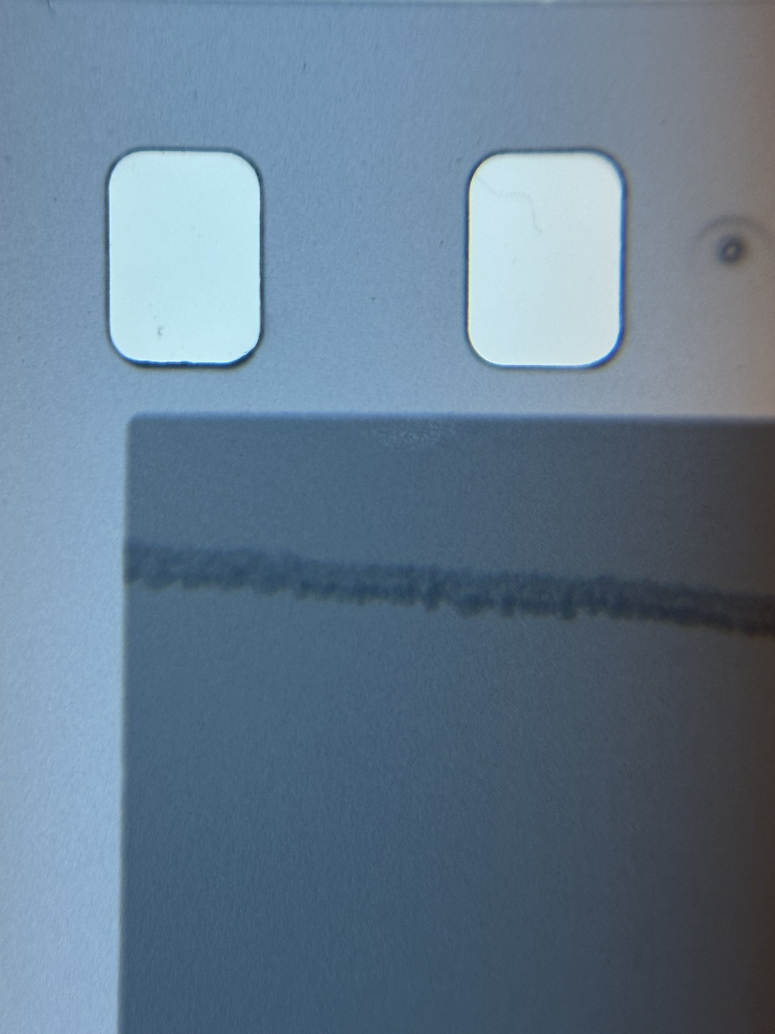

On the same frame, there is another spot on the BOTTOM of the frame, and here is a picture of the spot above on the negative as well
