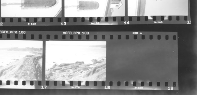

Here is an example of what I get with Cooltone, developped during 180s.
Regards to all,
Raphael
P.S : the neg in itself have a little problem : light leaks ! But the interesting part was in dark areas, it's cloudy !
