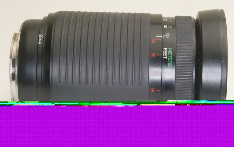

Here's the conclusion. Apparently one of the files was "messed up" by the camera -- even though the camera doesn't "think so". How this would mess up everything on the CF card, I don't know. It probably was a mess-up in the MBR/MFT, and prevented any program from reading the CF card.
A data/file recovery program brought all the files back to life -- except the one with a problem, you see here.
It might be that the CF card is getting old, but I only lost one file.
