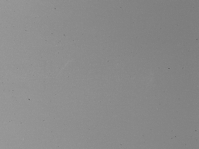

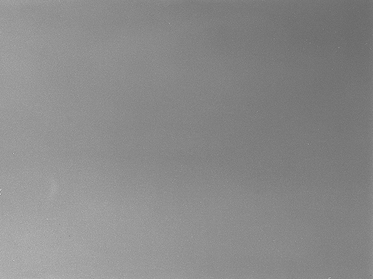

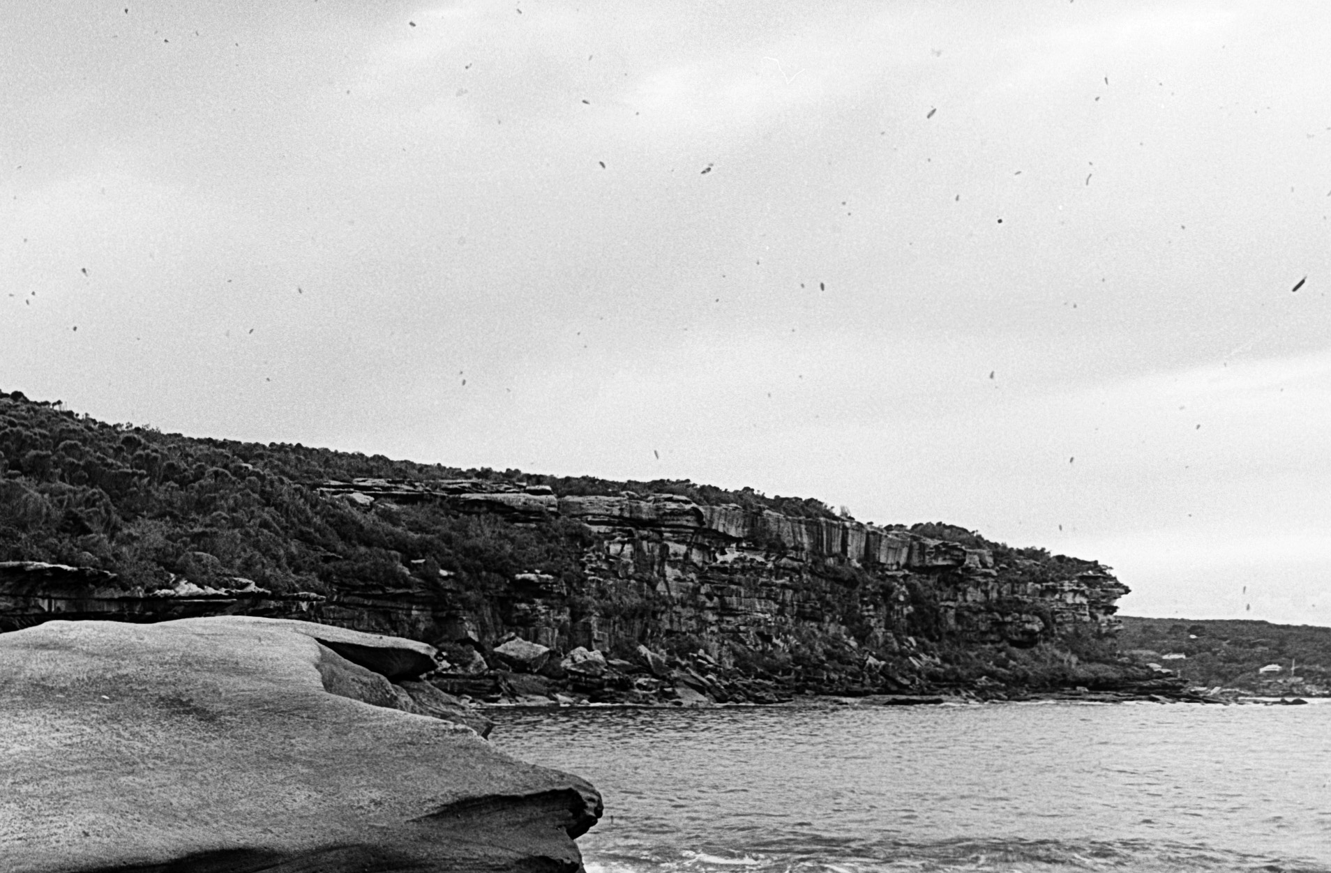

I knew I could count on APUG for an explanation of this recent experience of mine! The attached section of a TMAX 400 120 roll film negative is probably an extreme example of black-spotiness. My own fault I guess. I had run out of my usual XTol and had some old A & B solutions of WD2D+ on the shelf so I thought why not give it a go - my guess is probably 4 to 5 years since I mixed it and stored in brown bottles. Both solutions were clear with no sediment and I did a quick daylight dunk to see that development seemed to progress at normal speed. I mixed in tap water and inverted every 15 seconds for 15 seconds in a tank for 10 minutes. Mix was 40mlA+40mlB per 1000ml. The negatives are otherwise lovely and crisp with nice tonal range as long as there is no sky or bright negative spaces!
I was initially intrigued that so much "dust" could have landed and stuck to roll film as I typically load film carefully and keep my equipment clean and well maintained. When I realised it could not possibly be dust I loaded another roll and took 10 shots of blue sky with the RB67 and cut the roll in half and developed half in the same WD2D+ and the other in a new batch of XTol. No spots on the XTOl half but similar spotiness on the WD2D section.
View attachment 181815 View attachment 181816 View attachment 181818
