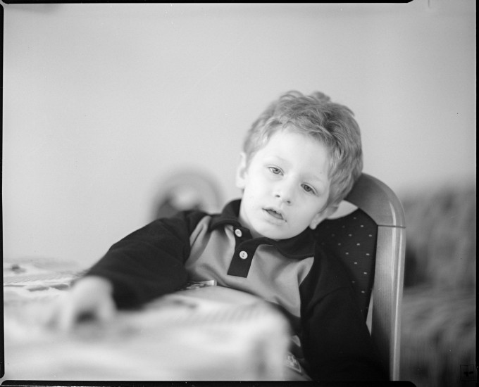

Here are some sample shots with my Aero Ektar.
The first one is in color, the second link is kind of big but highly detailed black and white version shot on Poloroid Type 55.

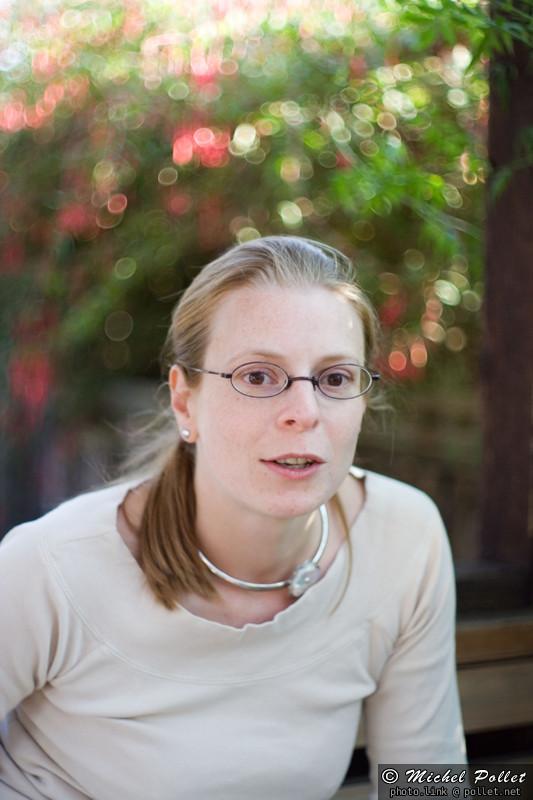

The results with neutral background are much better, which makes the Aero Ektar quite interesting for portraits under controlled conditions - you just have to be more careful with the background.
Unfortunately, I was paying more attention to the distance of the subject (thin DoF) than to the facial expression :sad:
Anyway, the photo is attached...

Denis, best way to tell how 'colored' your lens is, is to place it over a piece of white paper & look thru it. Your posted image has a background roughly the color of th ediscolored glass :O) so who knows?
I'm sure you have looked at it enough times to know, but the white paper test seems to eliminate any question.

I dont think it can be spherical abberation at all. There is one spot in the centre and this is a nice evenly illuminated disc. My own AE shows near perfect bokeh both before and behind the focal plane, even when focussed at 6', at least on axis.
The effect you're seeing is only at the corner of the frame. I suspect its actually Coma. At the focal plane, the coma blur is comet shaped, but when you defocus the Coma it becomes a distribution of light and dark like you're bokeh, also shaped by the mechanical vignetting of the lens. As far as I know, this is an unavoidable problem on fast lenses.
You may find that the blur circles look alot better if you stop down just a little. The vignetting and comma should rapidly improve. Because the AE has such a good diaphragm (15 blades?) you will still get nice creamy bokeh and you highlights should become nice evenly distributed circles. This for me is one of the attractions of the AE, I have full control of the DOF without sacrificing the image quality, and its also pretty sharp. Mine resolves around 60lp/mm at wide open and 10' distance
