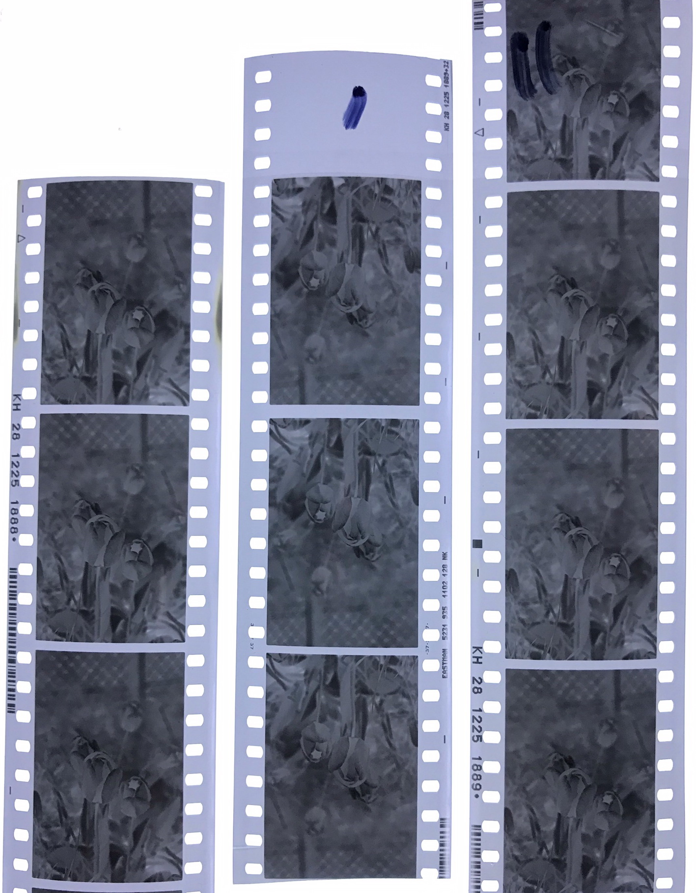

A week ago, I responded to the Supermarket Fixer question posted here by saying that a traveler could, if not wanting to risk bringing undeveloped film through airport scanners, develop the film, thoroughly stop it and dry it, and bring it home to fix it. That would not be a perfect solution, of course, but I thought it would be possible. So, I tested it.
I exposed a strip of Plus-X motion picture film, every shot exactly the same. I cut the film before putting it on reels then developed it in Parodinal. After developing, I stopped the film with freshly mixed Kodak stop bath. Then, in the dark, I took one reel out and resealed the tank. I hung up the film I'd taken out by safelight and fixed and washed the remaining film. I hung up the fixed film to dry in my bathroom.
Once the unfixed film was dry, I cut it in half and put one half in a film canister. The other half I left hanging and turned on the light.
I left it alone for a week. One small strip of film was sealed in the dark canister, another was hanging two feet from a 60watt bulb, another was fixed and dried.
Today, I fixed the film and scanned it.

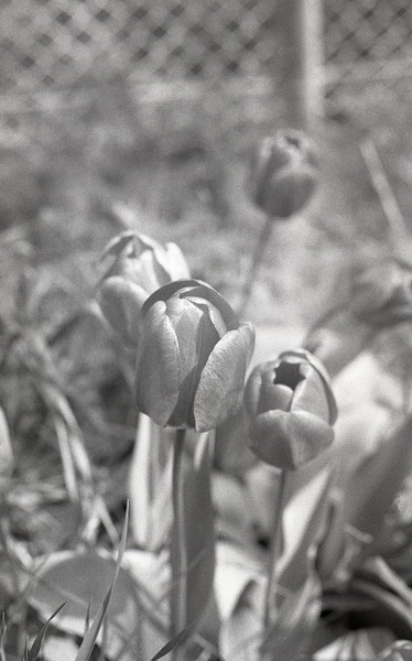

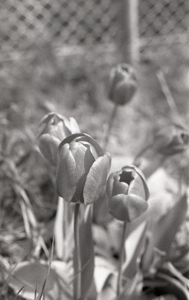

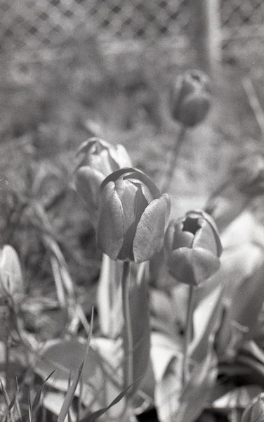

From left to right: normal, unfixed and stored in the dark, unfixed and stored in the light.
The scans are pretty similar. In the same order:
So, it seems like you can fix film, let it dry, put it away, and fix it a week later - if there's an emergency.
To clarify - the strip I left hanging for a week was not in a fully lit room the entire time. When the light was on, it was 2 feet away from it. When the light was off, the door was open and light was coming in through there.

It was originally in response to a question about the possibility of homebrewing fixer from commonly available ingredients. There is no benefit, other than the film is fully developed so might not suffer from nasty airport scans (these scans can fog film but that fog probably won't show up if the film is not developed after it happens).
So, I just wanted to know if anything bad would happen.

I only assume that the aggressive scans won't permanently fog the developed and unfixed film. It seems unlikely the scan would be more intense than direct light from a bulb. My exposed strip of film was quite light-fogged (much darker after a week) but it all fixed away. I doubt anyone could tell the difference between the scans I posted.
The only real difference that I can spot is more dust on the film that was hung up to dry twice. I think some dust gets in the emulsion and doesn't come out after it dries. That's definitely something to keep in mind.

That's true, also. And, actually, I was expecting to see some sign of something different, especially in the strip I left out hanging. But I can't see anything.

Regarding the later part of the conversation... Correct me if I'm missing something, but unless re-developed, no matter what fogging happens afterward will still just fix out. X-Rays and other forms of normally-encountered radiation don't reduce halides into silver, and whatever the ionic state of the silver halides, they will fix out.
That is what I was assuming when I first suggested the idea. I assume, though, that if you keep a piece of film in the light long enough, it will get printed-out. But I've had film that was improperly fixed and sat around for 5 years - it got quite obviously fogged and all that fixed out. But as Ralph Lambrecht said above, if you wait too long fixing won't really "fix" it, anymore.
This is the hypothesis. Result of OP's experiment is encouraging enough to test the hypothesis in the field.
Not necessarily. There is “printing out”
I was trying to test whether a bit of direct light-fogging would fix out (in this case it does, but I wonder what it would be like with a Tmax film). It is demonstrated that fog due to improper fixing will reach a state where it cannot be fixed out - I have no idea how long that would take. The "proper" thing to do, if you can't fix the film right away but have already developed it, is keep it in the dark. Maybe even keep it out of the open air, in case that actually has some unwanted impact.
