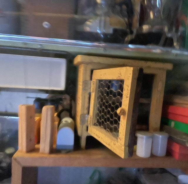

Absolutely! A cool dark dry place! The car glove compartment is my idea of the wrong place for film, but I have to admit my exposed film “cabinet” can get to 100 in the summer. I must move it somewhere inside.
Is your film cabinet a pie safe?
