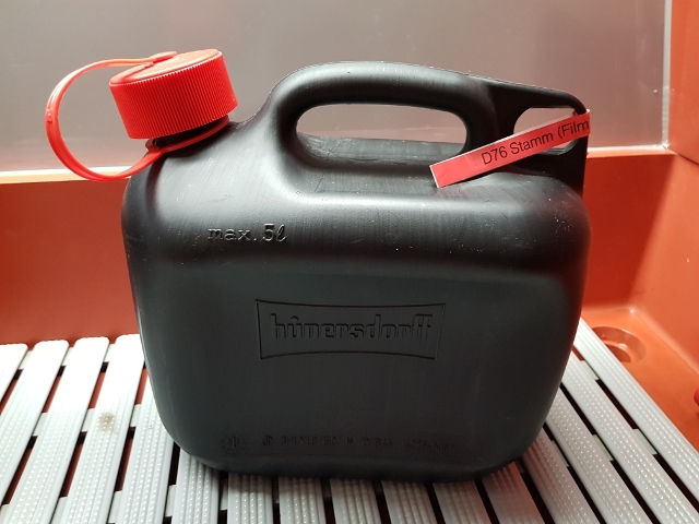

I always mix the 3.8l packs of D76 and store it in a 5l plastic fuel canister. And I add some Protectan or lighter gas in the canister. My last batch is at least half a year old and still usable without problems (one shot only).
