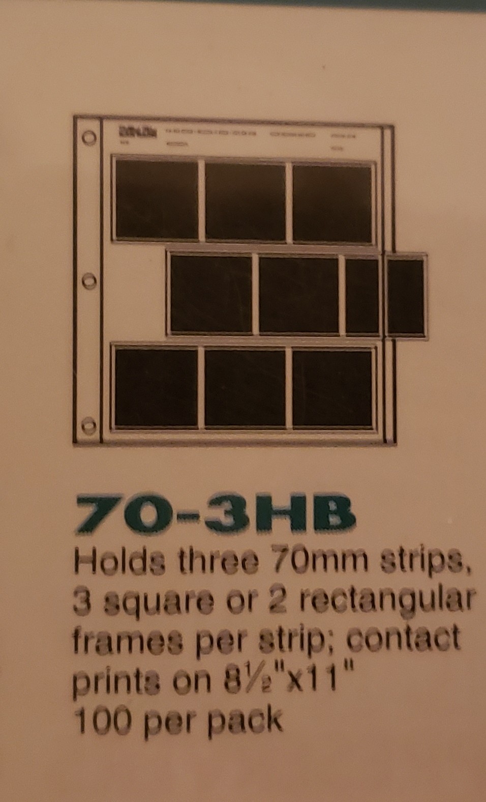

PrintFile made (makes?) pages for 70mm....
"70-3HB"
If no longer made, maybe try Ebay or a WTB ad here.

BTW, I've recently started shooting 70mm, and have yet to buy files/pages for them(the film I've shot is currently rolled up in the tubes my lab returns 120 in...). I was going to order some of the 120-3HB sleeves, but hadn't pulled the trigger because my Nikon scanner doesn't really handle strips longer than 3 frames of 6x6. The 70-3HB would be perfect, but it would also take a LOT of pages for one roll of 70mm.
