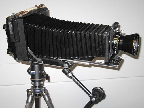

I use a Bogen Magic Arm attached to the bed of the camera and clamped to the tripod leg. This with a weighted tripod help a lot.
