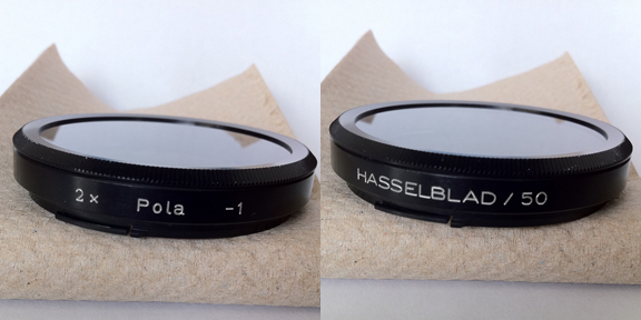

Hello, my first post to the forum after many months of lurking and learning :smile:
I recently purchased a circular polarizer (B50) from KEH for my Hasselblad 150mm f/4 Sonnar. I'm attempting to verify the stop loss so that I can compensate either on the lens or light meter. Would anyone have information on how to figure this out? Does the '-1' mean one stop of light is lost? Photo of the filter is below.

I'm thinking both the 2X and the -1 indicate one stop of light transmission loss. In my experience, polarizing filters reduce transmission by anywhere from 1.5 stops to 2 stops depending on manufacturer and field conditions. I've not used a Hasselblad polarizing filter, however. I would buy a roll of transparency film and do a simple field test on a bright, sunny day.

The numbers on the rim are what you are after: "-1" means one stop loss, "2x" means the same, expressed as a shutterspeed factor.
Those figures are correct.

Thank you both for your replies. I was hoping the numbers would reflect those values but didn't want to assume. I suppose my assumption regarding 'circular' was that since the filter can be turned it's circular.. :laugh:
