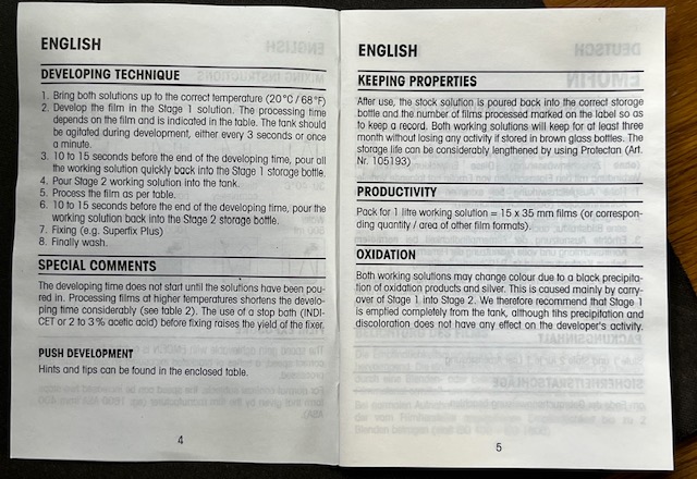

I was unable to locate the manufacturer's directions for Emofin film developer. Did you have them and read them? What did they say? Other two bath developers, like Diafine and Barry Thornton two bath developer, say not to use stop bath, so I would be surprised if the directions for Emofin said to use stop bath. If the directions didn't say to use a stop bath and you used it anyway, then the use of stop bath would be on my troubleshooting checklist. I would also consider that, since Emofin film developer is a powder, perhaps the developer was not fully dissolved, and that particles of developer may have gotten stuck in the emulsion. The same consideration would apply if you mixed your fixer from powder.
Yes I have the instructions (below). No stop bath stage is listed in the developing/fixing procedure, but under 'Special Comments' they say "The use of a stop bath (INDICET or 2 to 3% acetic acid) before fixing raises the yield of the fixer." One can reasonably conclude that in Tetenal's view a stop bath was optional with this developer.
