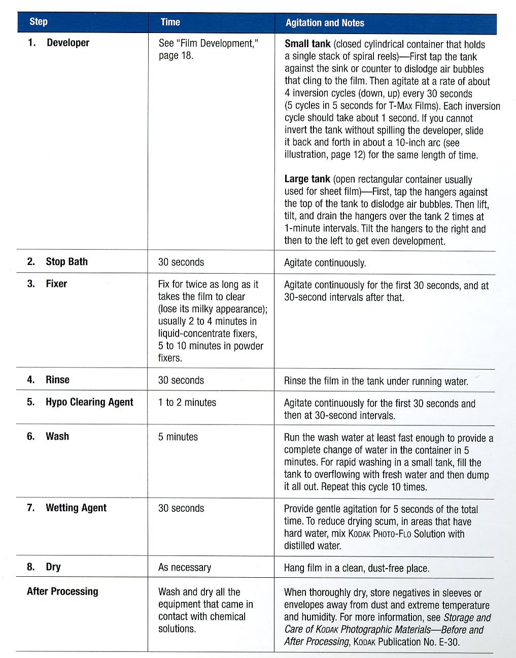

And which instructions might you be referring to?
These?
Kodak B&W process manual.

Hardly. In the 45 years I have been a photographer, I have never not used stop bath for film and prints. It is as simple as reading the instructions.
And which instructions might you be referring to?[/QUOTE]
