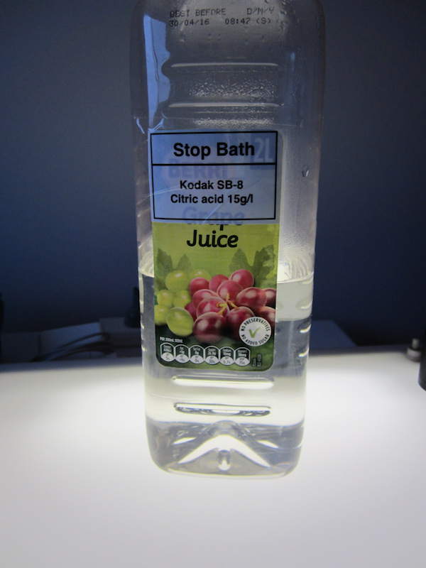

Likewise I have had no problem with growth in citric acid stop bath. Here is a quick pic of a batch I made at least 12 months ago.
