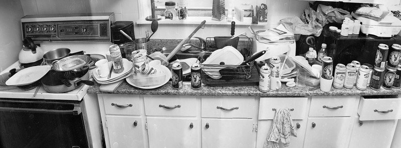

I've made a few posts on what I'm trying to achieve - platinum prints from stitched film. I have had good success with stitching digital files, and had some promises scanning and stitching old film (cut up 6x7 negs lol), so I tried one. It's ATP 1.1+SPUR, 3x10 images=30, minus a bit of cropping. The image is a disaster, there wasn't enough fluid in my tank (seems it takes approx. 325ml fluid, not Rollei's 250) and there are water marks, but hey, it's the first roll of film I've developed in ten years lol. But I figured I'd try to prove the concept to myself anyways.
What it DOES show, is that there's some promise with the idea of stitching film.

Thanks for the post, Shawn...it's an impressive result for a first-try.
In a previous thread, you had said you were using a Minolta 5400...I assume that's what you used to scan this, but what did you end up using to stitch it?
I ask because it looks like there's a really obvious seam-line on the left-hand drawer that's below the sink, but I don't know how evenly-colored your cabinets are, or whether it's a development artifact.
--Greg
PS--with a kitchen that looks like that, I *hope* you live alone :smile:
Hey Greg, yeah it was the Minolta. The film has a band approx 25%, from start to finish. At first I thought it was a light leak in the camera, but then I realized the band is underexposed, not over. This lead me to think I didn't have enough solution. So I threw a reel in the tank, added 250ml of water, and sure enough, there was about 1cm still left to go. I think it's closer to 325ml of solution required with this tank. I am curious if I can just add the same solution of SPUR (I only have one 'trial pack' left from freestyle, and can just extend the development a bit, or if I need to order more developer? Not a big deal, eventually I'll buy more film, bulk roll and large bottle of SPUR.
So in short, the artifacts you're seeing are the film. I brought each image into Photoshop individually, and started auto-aligning from there. Took quite a bit of work lol. And trying to use the Photomerge option, after a week of trying, I gave up - many crashes, and when it DID work, it did not at all come out right, lots of totally unplaced images. Manual (auto-align a few images at a time, auto-blend, flatten, bring in more images, do the same) was the only way to do it. I'm going to look into other software for this going forward.
Also, I believe Rollei recommends against Photoflo, but I think I need it; the water stains are very prevalent. I used distilled water and no stop bath as recommended, but I should probably buy a squeegie, as someone around here recommended.
Kitchen is clean again:smile: I was on holidays for almost two weeks and made a hurricane of the place lol. Yes, I live alone lol...
Shawn

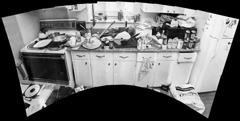

Following up on a conversation I had with Shawn, here's the same 30 frames stitched "automatically" with Hugin.
(click for full-size)
It took me maybe 90 mins., start to finish. I didn't even try to eliminate the density differences. The granite pattern on the countertop, plus the processing artifacts gave the automatic control point generator fits, so about half that time was manually locating matching points between pairs of images. The actual rendering (of 1500 dpi frames) only takes a minute or 2 on a 3 year old Win XP machine.
There's a minor defect in the line of the drawer and cabinet door below the dish drainer, and on the handle of the oven door, because there were just no landmarks to create control points from.
I decided to post this not to illustrate that one way is better or worse, but since I suggested using Hugin instead of by hand, I thought I should "Put Up or Shut Up".
Personally, I think the perspective is better with this one...on Shawn's, the cans at the right edge of the frame were looking a little distorted.
--Greg

Un-cropped version:
It's a rectilinear projection, so the perspective is the same as that of an ideal camera lens with HFOV sufficient to cover the area, about 20-24mm on a 35mm frame in this case. I compromised a little bit, as you can see not all the verticals are perfectly vertical. But everything started to look a little stretched when I tried to straighten all the verticals.
And final image placement and projection preview are real-time and interactive with an accelerated (OpenGL) graphics card, so it's easy to fine-tune the look of the final image.
--Greg
