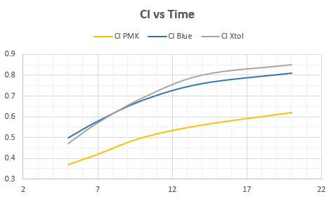

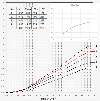

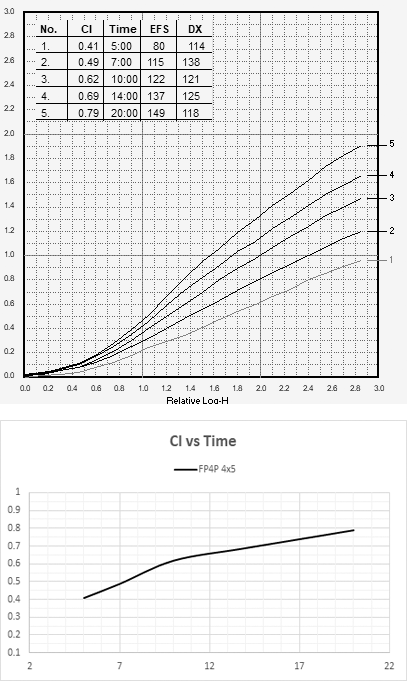

TXP 4x5 in PMK Pyro. It takes a full 10 minutes to go from -1/2 to +1/2 with CI 0.56 in the middle. It's hard not to be in the ballpark.

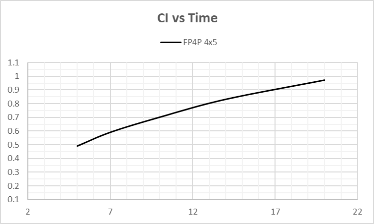

3 CI vs Time curves. PMK Pryo, PMK Pyro read with blue channel, Xtol.
How was this done? Continuous agitation? Open tank? Closed tank, hand agitate?
I have some skepticism that you can get to 20min without severe oxidation and loss of developer activity, but I'm willing to get schooled here...
The data comes from an unfinished project I worked on with a partner. I didn't do the processing, but here are the notes.
