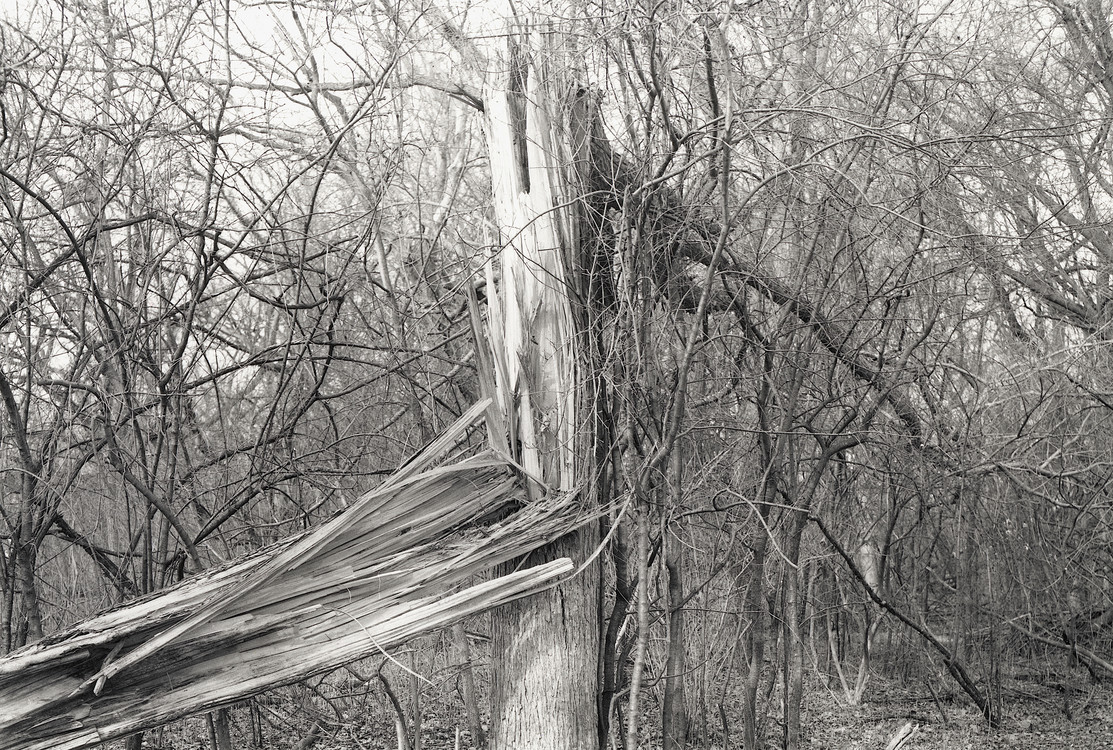

I suspect it would not be great for alt processes (but that's a guess) but it rocks with silver printing. Here is 2x3 HP5+ in PMK silver printed and print scanned:
Put it in any other developer and it gives me the icks ...
Looks great! Standard dilution and agitation?
