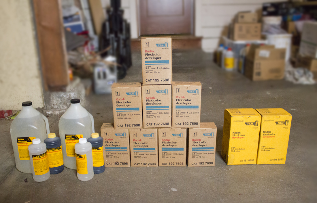

Hey folks. Long time lurker and first time poster here. I found a guy on Craigslist giving away a ton of old Kodak Flexicolor C-41 chemicals and just picked them up. I've got some questions about them. I apologize if you guys get asked these questions a million times. I tried to do my own research first and I've tried reading the Kodak tech sheets but I'm still unsure. I'm still pretty new at this.
1.) The developer Part A has crystallized. Looks like shards of crystal meth and/or huge chunks of rock candy at the bottom of the container. Part C is nearly black like ink. I assume the developer is long expired and unusable, or is there any way to salvage the developer? Can I make my own part C?

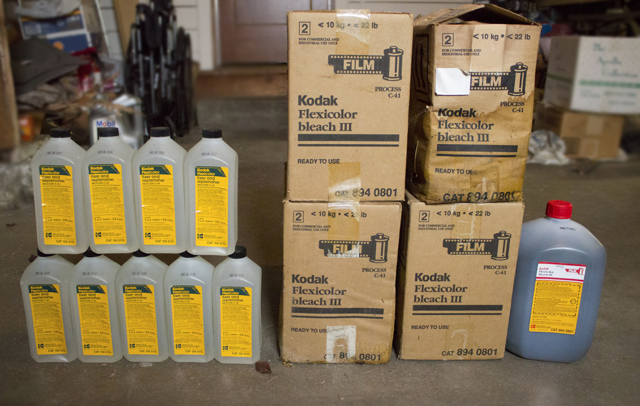

2.) Kodak Bleach III. According to the tech sheets, it's ready-to-use and isn't replenished/regenerated, correct? Does this mean I use Bleach III as one-shot? Or can I reuse it a couple of times? (I usually start with a 1-liter batch and reuse.) If so, how often can I use it before disposing? Can it be regenerated/replenished in any way? (Isn't bleach replenisher discontinued?)
3.) Kodak Fixer & Replenisher CAT 156 5175 (makes 1 gallon) - basically I don't understand replenishing. How do I replenish? Do I pour some out and then refill with working solution, or the replenisher straight from the bottle? Do I start replenishing immediately after developing one roll? I don't understand replenishment charts.
4.) I also have and use Kodak RA Bleach Replenisher NR and Kodak RA Fixer Replenisher. - same question as #3. I don't know how and when to replenish this bleach and fixer. I've already developed like 5 rolls of film using the same 1-liter batch so far without replenishing.

1. You can make the developer from the individual powder chemicals using the stephan formula posted here. Part C is the CD4 part. I just made some but haven't tried it yet. It is about the same cost as flexicolor but the powders won't go bad on you.
2.Bleach III can be reused. There are threads on how to add bromide and adjust pH to extend the life. Bubbling air into it regenerates it.
3. Fixer, I wouldn't replenish. Its cheap. You should be able to do 8 rolls a liter one pass.
4. The RA Bleach says it is a replenisher, but it also says you can't replenish it. I think it is called a replenisher because there is a starter you use with it. I use this and from what I read, you can reuse it one time, which will give you 2X8 rolls per liter. I haven't tried to extend that.

1.) I agree with sfaber17: the dev packages are toast. Use (there was a url link here which no longer exists), they work very nicely (and I think these are the formulas sfaber17 referred to).
2.)I mix something myself which closely resembles Kodak's Bleach III, and you can reuse it many times over. This is definitely not just a single shot product. I run at least twelve rolls of film per liter, usually in batches of one or two rolls per run, without any additions or readjustments.
3.) Again, what sfaber17 wrote.
4.) The RA chemistry is stronger than regular C-41 process chemistry, used in one hour labs where processing speed is essential. Using just the replenisher but no starter solution may not work as expected. For example: fixer pH is critical in colour processing, and fixer replenisher most likely doesn't have correct pH by itself. YMMV.
