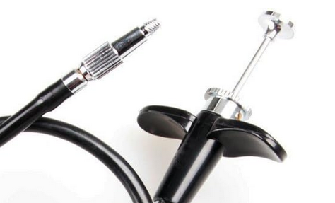

The cable should look like:
The screw part goes into the shutter button. The knurled collar is necessary. You press the plunger to open the shutter, turn that collar to lock the plunger down, then you can go have a coffee or something. If you get a cable without a locking collar, you'll need to hold the plunger through the entire exposure.
Some cable releases have locks, but plenty of them don't. If they don't, you have to hold the plunger in place for the amount of time you want. And if it does have a lock, it might be hard to figure out how to use it. Some have a screw that you turn. Others have a plate that your twist or push.
Some similar releases lock automatically when you press the plunger down if you preset the knurled knob beforehand. After the exposure period, you turn the knob when you want to release the plunger and re-close the shutter.

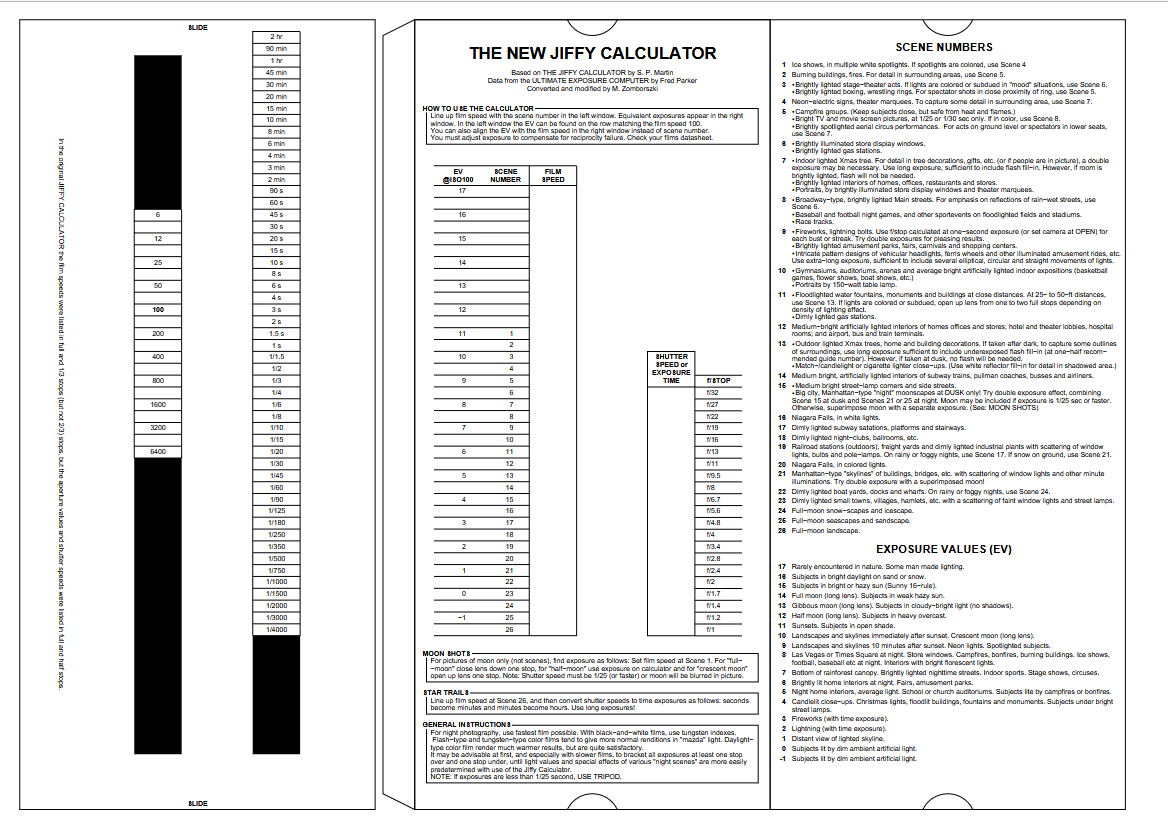

The most important part is exposure. This will improve you success rate. I have been using the Jiffy Night Exposure slide rule since it was first published in 1963.
Thank you everyone. A lot of useful info here. And thank you Sirius Glass for the Jiffy Calculator, i'm sure this will be very usefule too.

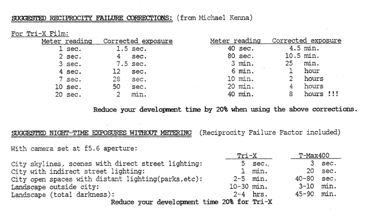

Here is some data Michael Kenna gave out a few decades ago...
