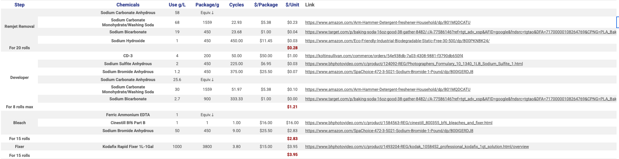

Hi! after a year's adventure using the notorius Cinestill Cs2 ECN-2 kit with DIY Remjet Remover, I decide to start from scratch to build my own ECN-2 kit.
By following https://www.kodak.com/content/produ...ssing-KODAK-Motion-Picture-Films-Module-7.pdf, I have the following items ready:
I removed the need of Kodak Anti-Calcium, because the developer is planned to be one- or few-shot. I know it is https://www.scbt.com/p/sodium-3-nitrobenzenesulfonate-127-68-4 , but it feels hard to buy those as a mere civilian.
I will directly use a neutral B/W rapid fixer and won't bother dealing with DIY fixers or creating from the remaining BLIX constituents.
However I'm a little bit unsure about the longevity of the said bleach to be used.
By following https://www.photrio.com/forum/resources/converting-c-41-e-6-blix-into-separate-bleach-and-fixer.74/, I identified that the Bf6 Part B is Ferric Ammonium EDTA, so by adding Bromides and adjusting to pH 5.5 it will become a usable bleach.
It's promised to be active for a dozen rolls mimimum, and can be used for more rolls if I add extra Bromium to the solution.
However, is the bleach able to be replenished by simply adding some Sodium Bromide, and expose the bleach to open air to oxidize the Ferrous ions to Ferric?
For example, my plan is, each time when I use the bleach, I'll add 5 grams of Sodium Bromide, then give a good shake/air exposure to the solution, finally adjusting to pH 5.5 by adding some white vinegar.
Will the FeNH4EDTA be stable for a long time (for example, a year) so that I don't need to buy another pack of Bf6 to replenish?
Thanks!

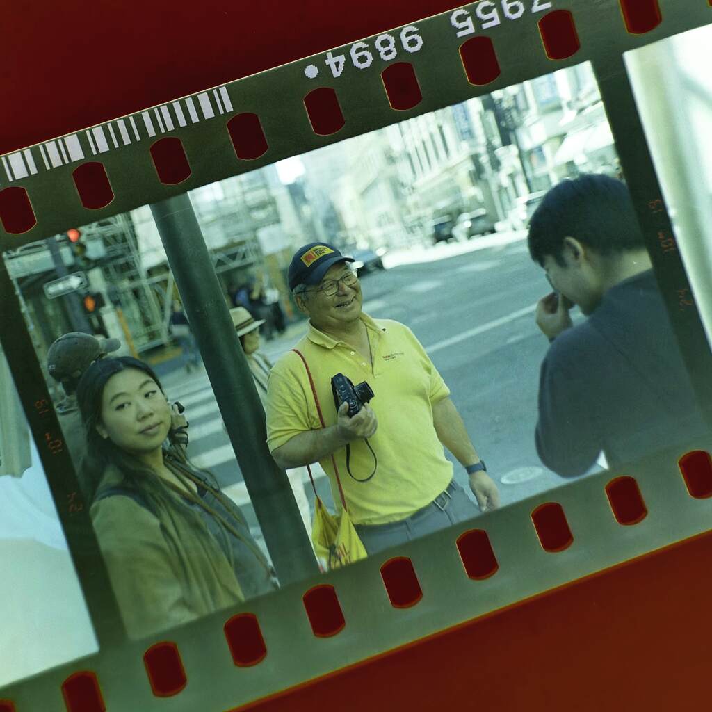

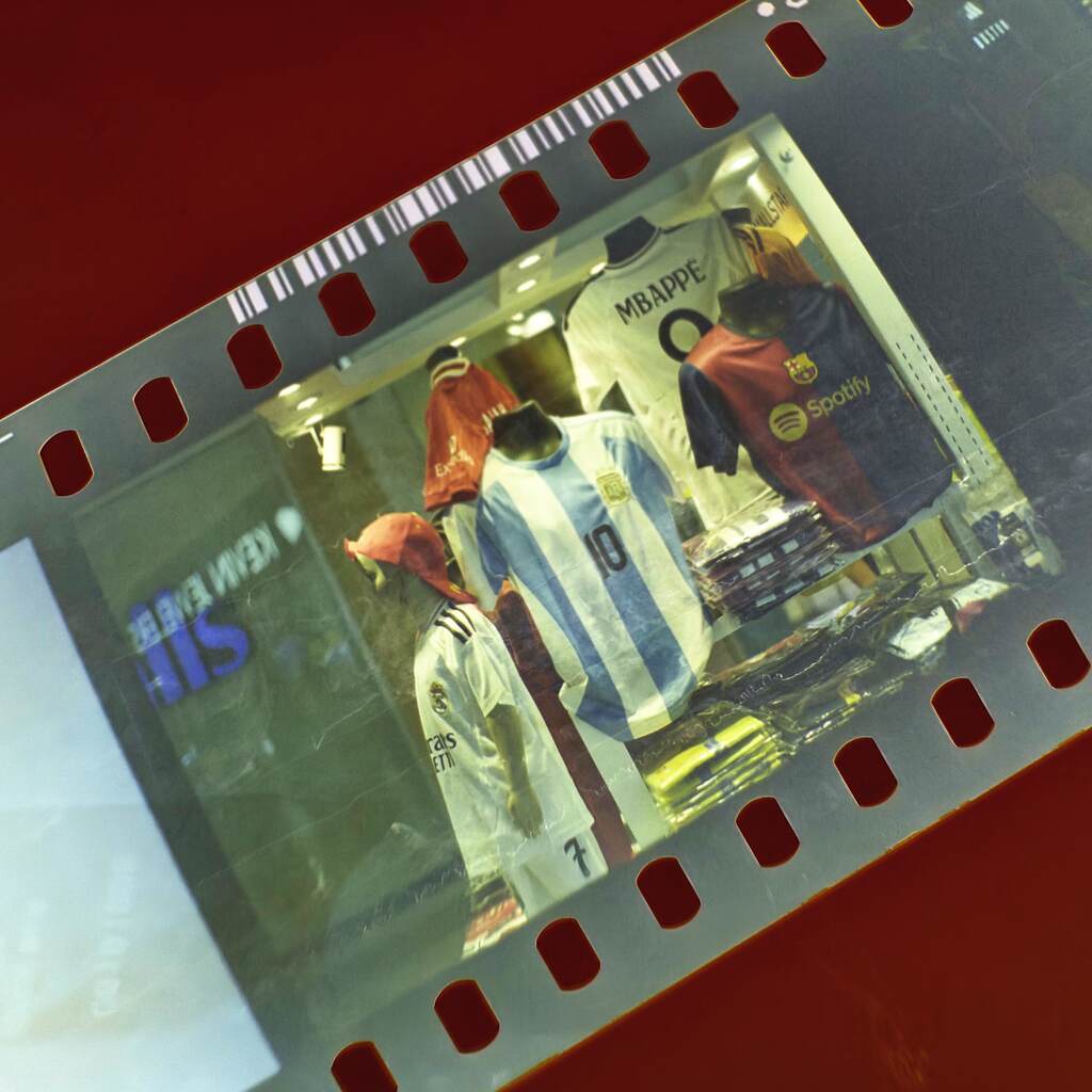

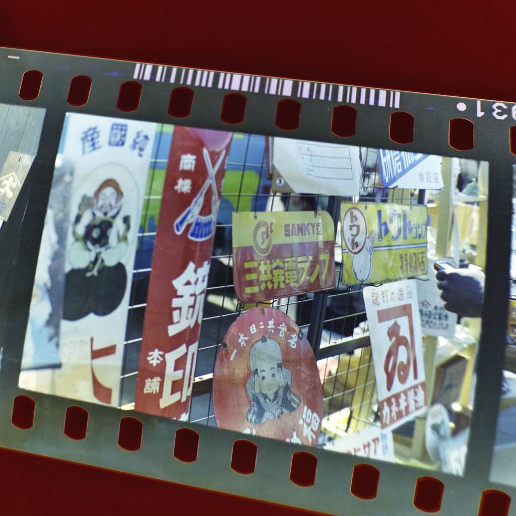

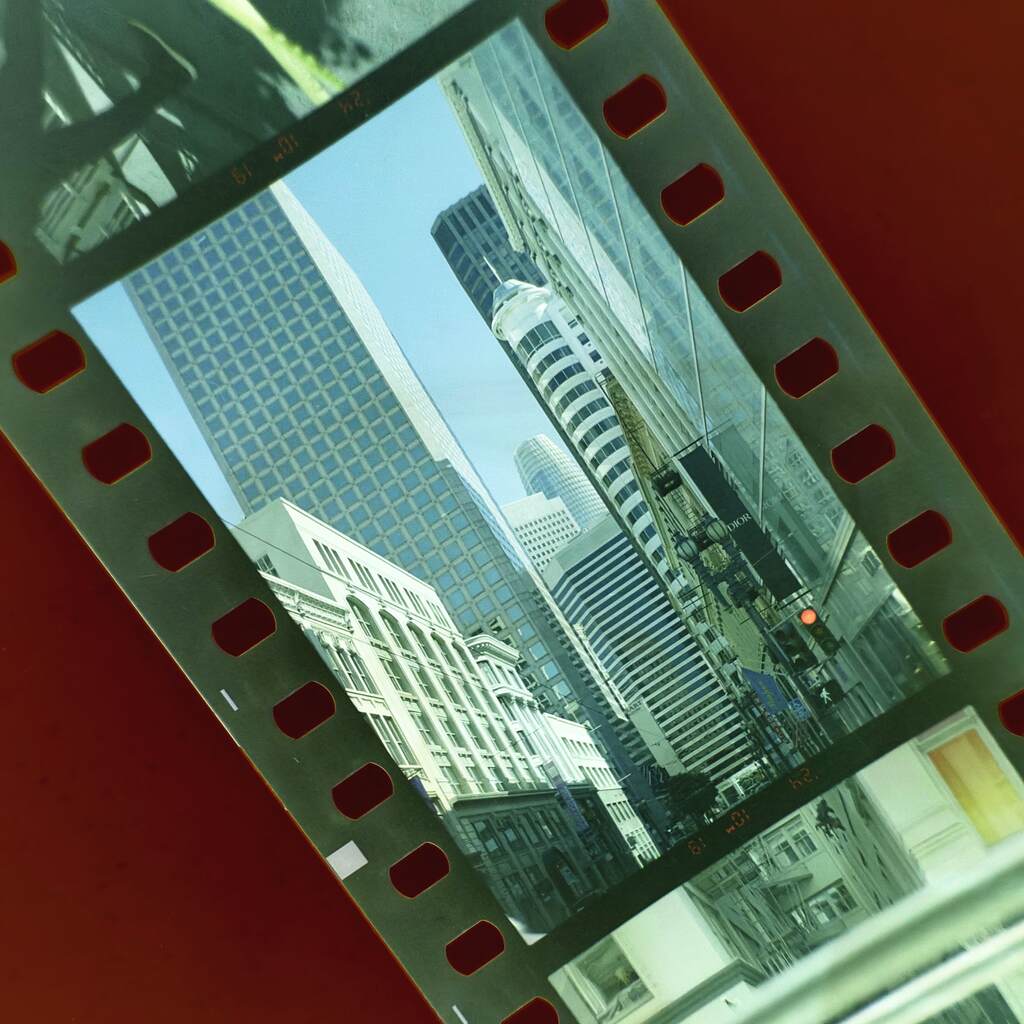

Maybe it's worth an extra post about how I discovered that the film is underbleached and has silver retention; but in one sentence, because some scanners conduct ICE probably by scanning in infrared, the existence of silver will screw the scanner and trick the algorithm.
You don't need to feel my frustration when I found my scans coming from Fuji Frontier SP3000 blurred and marred with strange patterns
Early update on the test: Results are magnificent. Colors are nice, and the separation of blix may have improved resolution.
