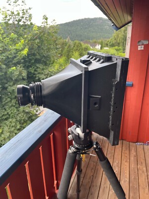

Those, or a little more can get you a 3D printed “travel camera”. It’s a newish LF variant that has a hard cone instead of a bellows with a specific lens in the front that may be fixed focus or may have a minimal helicoid. They’re way less flexible, but are cheap. I’d still get a intrepid before one.
I have an Intrepid 8x10 and I'd say it's a good value for the money. I'm very happy with it.
I got mine last year for 20% off with a coupon code (I don't know if that's still a thing) so it was an even better value, but even at list price I think it's worthwhile. No light leaks and generally it's pretty sturdy save for the brittle, thin (3d printed?) plastic hinges that lock the ground glass in place. One broke within a couple of weeks of my use of the camera, but the camera was still usable and they sent a bunch of replacements quickly. I haven't had one break since.
