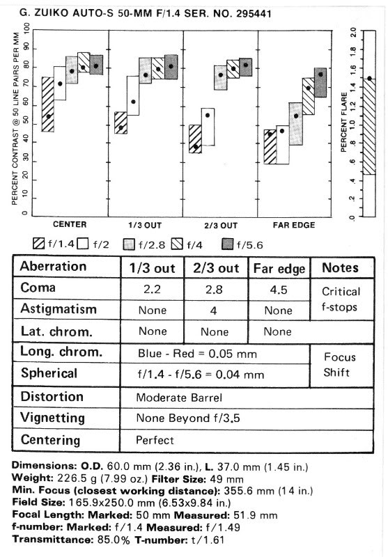

Here are a couple:

IC-Racer: Glad to see that the Zuiko had a good showing. What do the dots on the bars mean?

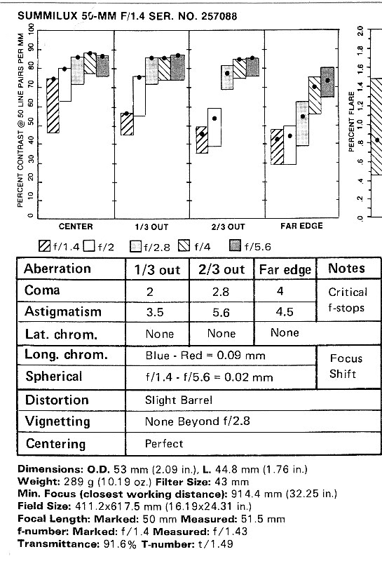

Here are a couple:
attachment.php
attachment.php
I have more of the same series archived on other laptop. Basically the ranking, generally speaking, based only on those optical metrics, was:
#1 Leitz, then #2 Canon closely followed by #3 Nikon.
Then the rest. Seems the test was about mid 1970s.
And no, Zuikos were not the best in any case, usually with lower transmittance and/or higher flare and more spherical aberration and chromatic aberration. This no doubt due to the obsession on making the lens smaller than it should.
